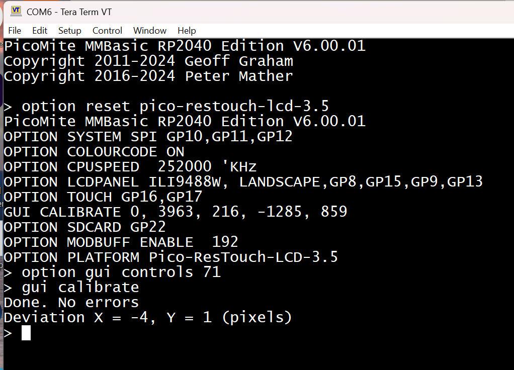

Another strange behaviour found:
PicoMite MMBasic RP2040 Edition V6.00.01, Pico-restouch-lcd-3.5
After resetting options and re-establishing options for the panel AND setting
OPTION GUI CONTROLS 71 the old problem with GUI CALIBRATE occurs ...
Error : Touch not calibrated
in a loop after the first calibration point is touched.
If GUI CONTROLS is set to 0, calibration works ...
Edited 2025-01-18 06:16 by ville56
73 de OE1HGA, Gerald

  Quote  Another strange behaviour found:
Can't replicate
Can't replicate
ok, can't either anymore after a clear_flash. Must have been some garbage left over in the options area, sorry to bother you ....
