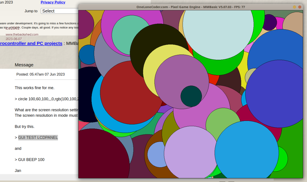

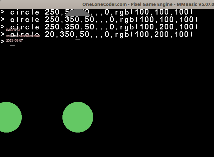

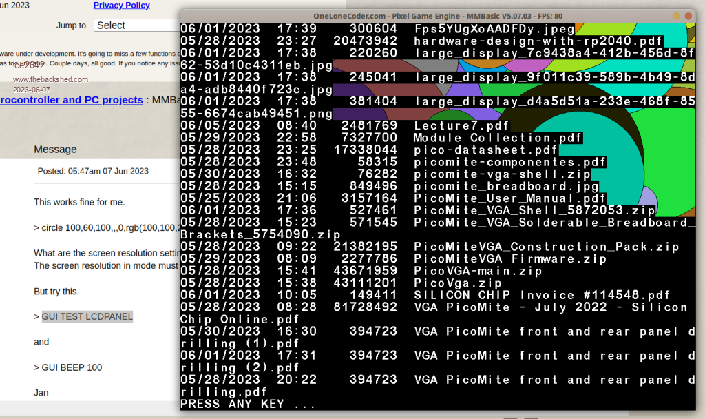

This works fine for me.
> circle 100,60,100,,,0,rgb(100,100,200)
What are the screen resolution settings in windows and what is in the option list?
The screen resolution in mode must be smaller than in the windows settings.
But try this.
> GUI TEST LCDPANEL
and
> GUI BEEP 100
Jan

Jan

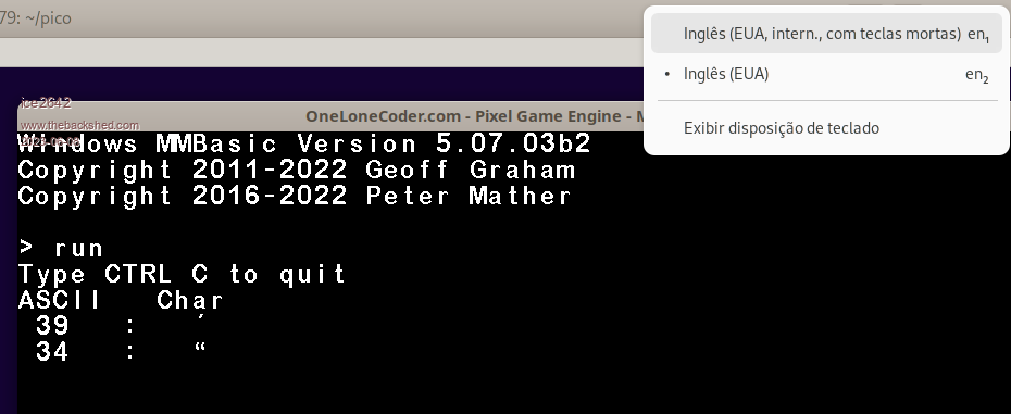

Hello, both tests work fine.
The options was default, I just unzip and run. but the path go to my documents.
The edit still not work

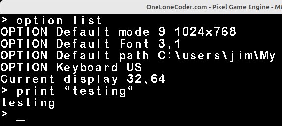

the result of option list
option default mode 9 1024x768
option default font 3,1
option default path <my documents>
option keyboard uk
current display 32,64

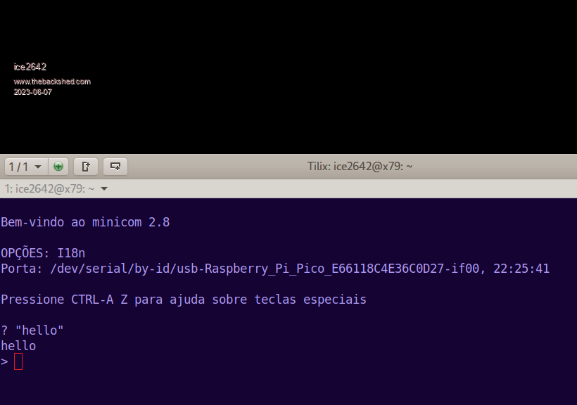

when I type
edit [enter]
Nothing to edit
Instead go to editor.
Maybe I am making some thing wrong for the editor not work.
And the ( " ) character not work. This occurred in gfxterm terminal using raspberry pico too.
Tkz.
After test (gui test lcdpanel) , the circle start work.

May be the problem is the name missing after edit.
As the key ( " )is not working, it is not possible to name it.
I change to option keyboard us (my layout) and still not working the "
The same happens using gfxterm using the pico card over usb.
in putty it works normally.

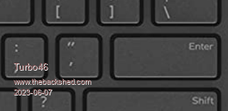

Posted: 02:46am 07 Jun 2023
Maybe your keyboard is not really a US layout? You could try other keyboard options. Obviously you can type " (double quote) so the keyboard is not faulty.
Is the double quote key in this location?
Bill

Joined: 27/05/2023
Location: Brazil
Posts: 82
Posted: 03:04am 07 Jun 2023
Yes.
104 keys US layout qwert.
But, in configurations, it is set to US International with dead keys, maybe it affect the result?
In Putty and minicom it works. just gfxterm and now the windows version os MMBasic have this problem with double quote.

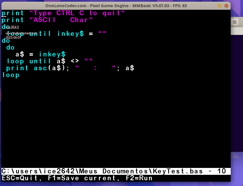

OK, this might help:
  Quote  print "Type CTRL C to quit"
print "ASCII   Char"
do
 loop until inkey$ = ""
do
 do
   a$ = inkey$
 loop until a$ <> ""
 print asc(a$); "   :   "; a$
loop
If you can copy that code into a text file and save it as "KeyTest.bas" and drag it into MMB4W it will wait for you to hit a key then print the ascii code (decimal) and the printable character.
Bill

Posted: 04:21am 07 Jun 2023
  Quote  You can call up the program with > LOAD "TEST1.bas" and check it with LIST.
But the " key doesn't work that's why I suggest dragging the file into MMB4W.
I was thinking that linux may be set for a different keyboard and that is confusing things?
Bill

ice2642
Joined: 27/05/2023
Location: Brazil
Posts: 82

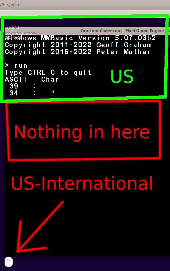

Posted: 10:51am 07 Jun 2023
  JohnS said  Maybe an interaction with a setting for Brazil ... I wonder what knows or thinks it's not USA (or UK) and what effect it has?
You are right.
The problem is the set up of US international.
I set it to standard US and the problem is gone, I can now type " without any problems.
It would be interesting to find out why this happens, as other variables in international English may be a problem.
But if anyone else has the same problem, the solution is to add the normal US keyboard and when using MMBasic, activate it.
Thank you
Edited 2023-06-07 20:53 by ice2642
MMBasic 5.0707 on PicoMite VGA

ice2642
Joined: 27/05/2023
Location: Brazil
Posts: 82
Posted: 05:25pm 07 Jun 2023
  JohnS said  Excellent - working is good!
I wonder what would happen if you changed the setting back while (*) you have an MMB4W program running (perhaps the one above using INKEY)?
If it changes even when the program is running you might be able to hit the " key and see what actual code it is producing when in the country code setting you originally had.
OTOH if it works now... maybe just keep it?
(*) I was going to put whilst but that's a bit hit-and-miss for non UK-English people
I make the test, change on the go, the "stop work.
The green US , the Red US-International.

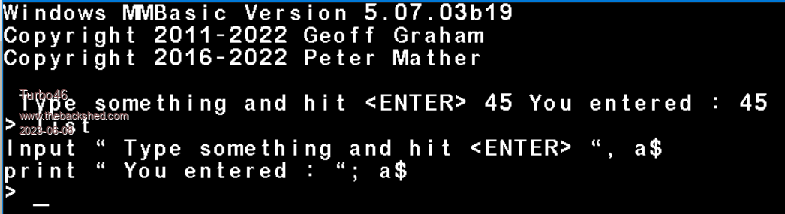

Can someone please confirm that I am not the only one seeing this:
The program:
Input " Type something and hit <ENTER> ", a$
print " You entered : "; a$
produces this output:
MMB4W does not 'print' a CR/LF after an INPUT statement but it does after a PRINT command. My OPTIONs are exactly the same as TassyJim's above except for the default path.
The same thing in MMBasic for DOS is correct
  Quote  Windows MMBasic Ver 5.05.05
Copyright 2011-2021 Geoff Graham
Type something and hit <ENTER> 45
You entered : 45
> list
Print " You entered : "; a$
I can work around it of course but I would like to know whether it is MMB4W or me doing something stupid.
Bill
Posts: 3393
Posted: 04:43am 08 Jun 2023
Yes, MMB4W does do that. So do PicoMite and MM+
- only tested at command prompt not in a program, but they should be the same.
