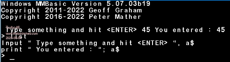

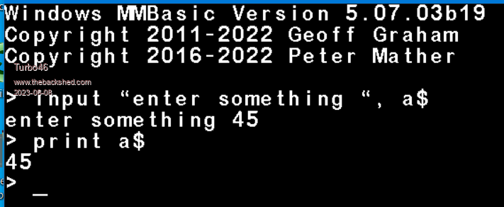

Turbo46![]() Guru ![]() Joined: 24/12/2017 Location: AustraliaPosts: 1638 |
Thanks Phil and Jim, I'm not sure what you mean by: But I get this when I enter it at the input prompt: ![]() Which NOT what I see when doing it in a program. ![]() Bill Keep safe. Live long and prosper. |
matherp Guru ![]() Joined: 11/12/2012 Location: United KingdomPosts: 10209 |
That's because at the command prompt you get a new prompt after every statement Try Print "Hello"; at the command prompt |
JohnS Guru ![]() Joined: 18/11/2011 Location: United KingdomPosts: 4036 |
Looks like confusion between a stored program (which you can EDIT) and immediate mode commands (typed at the > prompt). The program you can LIST, EDIT, etc. The typed-in commands are executed and then gone (may be recalled via the OS e.g. using uparrow). John Edited 2023-06-08 18:15 by JohnS |
Thanks Peter, I did expect that at the command prompt but I never have seen any BASIC program not do a new line after the response to an INPUT statement. Bill Keep safe. Live long and prosper. |
thwill![]() Guru ![]() Joined: 16/09/2019 Location: United KingdomPosts: 4301 |
I think Bill is correct, MMB4W is misbehaving: ![]() I typed "foo" at the INPUT prompt and then Enter ... it should have inserted a newline and printed the second "foo" on the next line. Best wishes, Tom MMBasic for Linux, Game*Mite, CMM2 Welcome Tape, Creaky old text adventures |
Thanks Tom, I really don't know why it hasn't been noticed before. Bill Keep safe. Live long and prosper. |

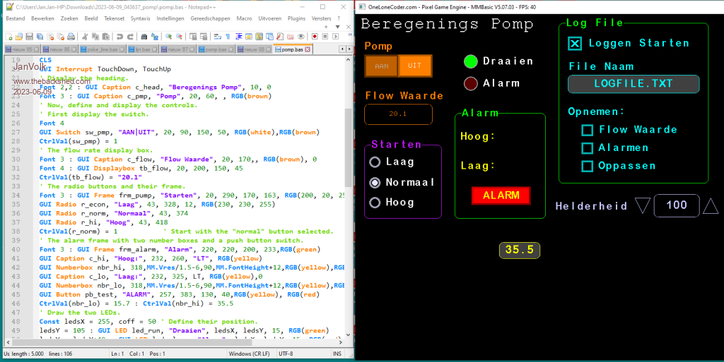

JanVolk Senior Member ![]() Joined: 28/01/2023 Location: NetherlandsPosts: 234 |
I've been doing some testing with the GUI commands for MMB4W and it works very well so far. That is why I do not understand that all these extra settings are not included in the standard manual if you want to quickly consult the manual and then run into all kinds of references. For myself I translated the pdf files into Dutch because my English is not so good with many examples. I also adapted Notepad++ for the Syntax to MMB4W which is now a party for programming with MMB4W. See here the example program by Geoff Graham from 2015 which works perfectly with MMB4W and you will not easily see the extra functions and commands with only the MMB4W manual. pomp.zip Jan |
An example of what this looks like for me. ![]() Jan |
I agree that is a nuisance but I presume it was done to reduce duplication. The manual for MMB4W was based on the CMM2 manual which did not include the GUI stuff. I would not be surprised if it was removed from the Picomite manual in the future. One change of the GUI functions could mean several manuals would need to be updated. If it makes you feel any better, the manual for the MM+ only contains the things that are ADDITIONAL to the Micromite manual. This is were the GUI functions began (I believe). Maybe one day they will be removed from that manual and that would mean that THREE manuals would be needed for the MM+ (I hope not). The program does work well. If only I could understand it. Bill Keep safe. Live long and prosper. |

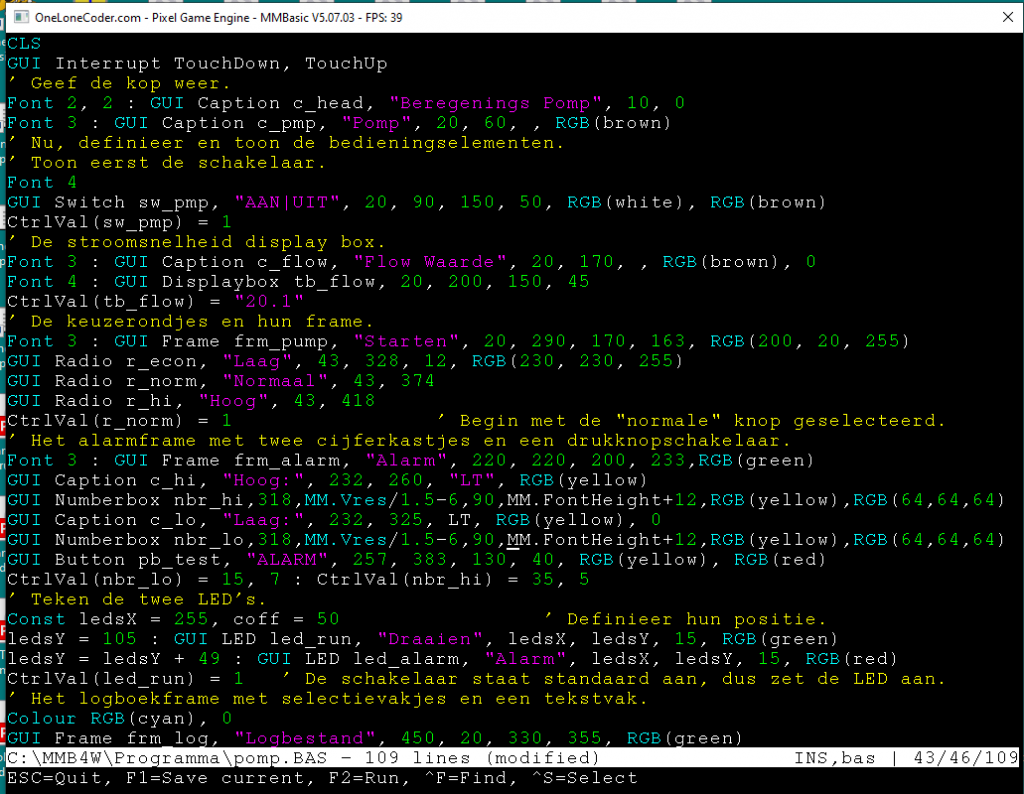

Peter, When calling up the List Functions, CtrlVal( in this list is expected to also get a CYAN color in the EDITOR? Jan |
Peter, There may be more like MM.Fontwidth and MM.Fontheight? See screen print. ![]() Jan |
Please stop posting about editor colouring. Many commands in the CMM2 and MMB4W are converted into other commands by the pre-processor. Therefore they are not colour coded. It is what it is and remember it is free ![]() |
Mixtel90![]() Guru ![]() Joined: 05/10/2019 Location: United KingdomPosts: 7833 |
If the "wrong" colours put you off it's easily fixed with OPTION COLOURCODE OFF. ;) More to the point, even if CtrlVal(#ref) is listed as a command, it's always treated as a single-dimensional array - it is actually a value. To colour it any differently probably introduces more confusion, not less. Mind you, that's just me. :) Mick Zilog Inside! nascom.info for Nascom & Gemini Preliminary MMBasic docs & my PCB designs |

V5.07.03b20 Long time since I've played with this and compiling on a new machine so anything could happen MMBasic.zip Fixes bug in sprite hide safe on layer 0 Changes the MMGetLine function so it echoes CRLF when it sees a linefeed character as well as a carriage return. This fixes the issue with the INPUT command and the same issue with LINE INPUT command. I hope this hasn't broken anything else. |
