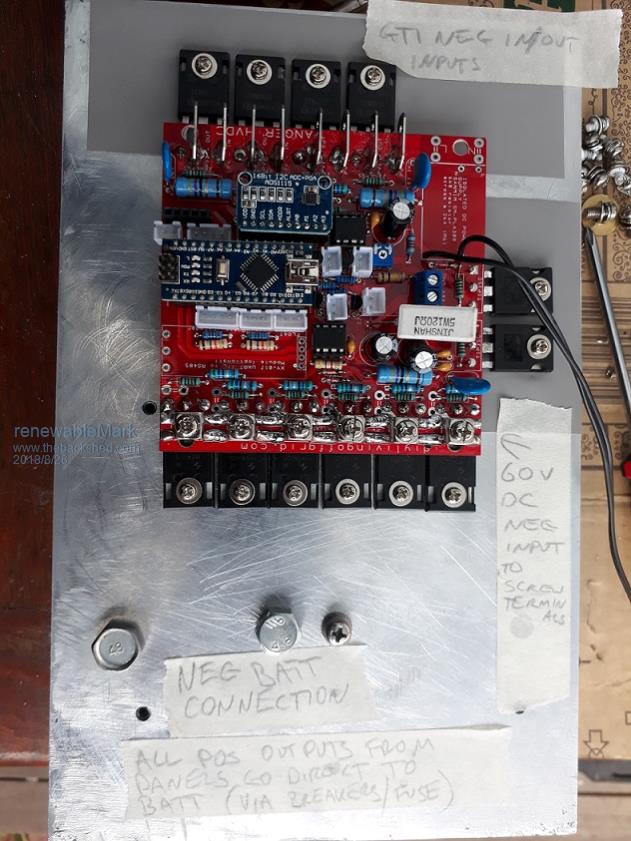

Hey Mad, are you any closer to incorporating the hall sensor for the max amps charge restriction from GTI controller? I currently turn half my system off(dc breakers from panels) on totally sunny days so it doesn't feed too many amps.

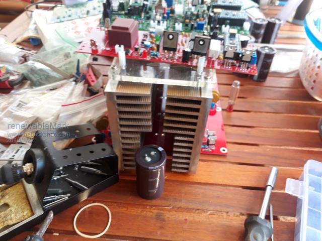

All my suppliers that pay for freight have heatsinks that are too big or too small. I can't see any reason the board wouldn't work with the large caps on the bottom of the board?
renewableMark
Joined: 09/12/2017
Posts: 1679
Posted: 04:30am 22 Jan 2019
You can cut the heatsink away to fit the caps in.
I think tinker puts the caps on the other side, that will make it fairly bulky though.
If you are in Melb you can come over and cut them on my table saw.Edited by renewableMark 2019-01-23

ryanm
Joined: 25/09/2015
Posts: 203
Posted: 04:33am 22 Jan 2019
Thanks for the tip Mark. Wondering if I should be making capacitor toasted sandwich though?
renewableMark
Joined: 09/12/2017
Posts: 1679
Posted: 04:41am 22 Jan 2019

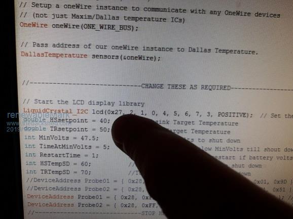

Mount it so the heat sink is vertical, natural convection will pull any heat away.
The Mad control board allows you to set the fan temp set points so you can set it lower than normal if you want.
