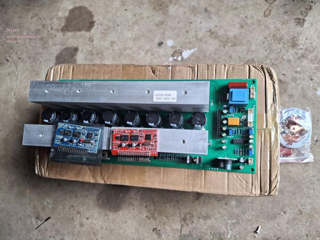

Ok this Ali board is here
On the left is the blue one I'm going to use as it is the upgraded board.
Now as all the outputs are in Chinese could a member please tell me what each connection is as we do need to know what each one is.

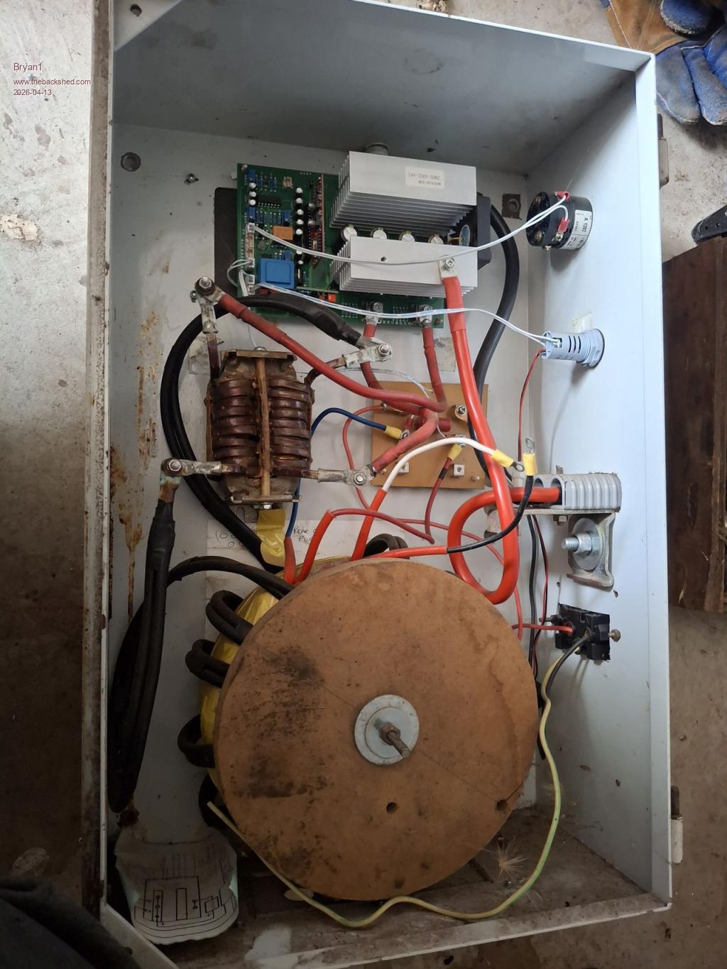

Now I do have that first small inverter to use for this inverter for testing
The choke uses the big choke from the AeroSharp Grid Tie with 10 turns of 6.5x3.5 enameled wire then varnished in. It would be good to set this choke with a scope to see what it can make as dual choke.
I got this design off Tony many years ago now when I tested this inverter it did run both vacuums
There is no pre start setup for this small inverter and it didn't blowup but now I know more a pre start setup will be done.
Godoh
Joined: 26/09/2020
Posts: 714
Posted: 01:46am 13 Apr 2026
Hi Bryan, the connections can take a while to work out.
Near the transformer one of the sockets is for feedback, so if you have a look at which socket goes straight to the transformer that should be the feedback one.
Another one is for the LED to show the inverters state, either On or Standby.
The next set of sockets to the left will have one for the fan.
I will take some photos of my board and see if it is the same as yours.
Unfortunately they are a few different boards with different arrangements for the sockets.
If you can contact the seller of the board they can usually supply a diagram to show how the connections are made.
I will post a picture of my inverter later
Pete

Hi Pete I may of answered most of my questions myself as I do have the picture from that small inverter board
Now it shows the top connection at the top of the group is for the fan output, now on this larger inverter at the back of this board is a 12 volt connector. I do assume this would be to connect a fan to the heatsink so I'm wondering if this larger board does have a 2 fan setup.
Also below the 2 trim pots is a 2 pin connector that goes to that vertical board so wouldn't this be a 12 or 15 volt DC input.
Godoh
Joined: 26/09/2020
Posts: 714
Posted: 04:07am 13 Apr 2026
Hi Bryan I see on the larger board that there is an extra connector near the small board on the opposite side of the transformer on the board.
One way to translate the symbols may be to take photos and use a translation program to translate from chinese to english.
None of my boards have that small vertical board
Pete

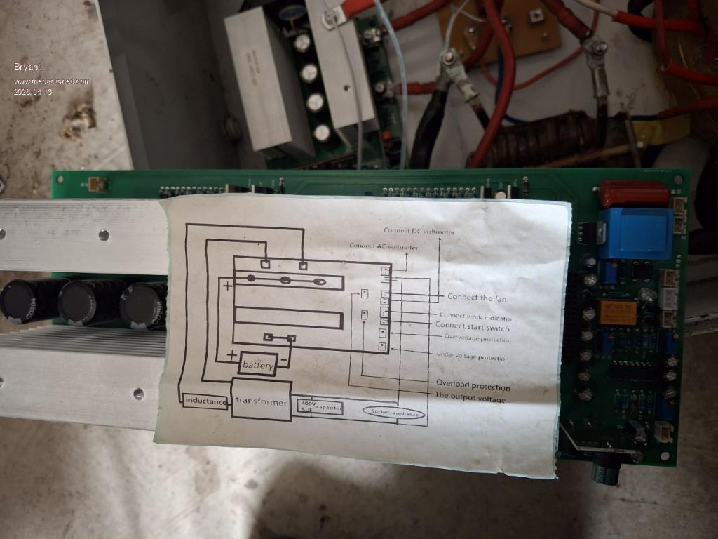

Joined: 26/09/2020
Posts: 714
Posted: 08:19am 13 Apr 2026
Hi Bryan this is the connection diagram for the board I have
Pete
