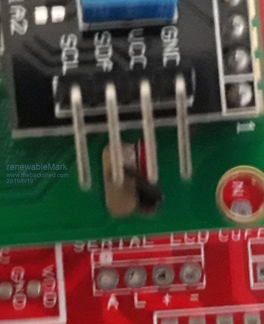

mason
Joined: 07/11/2015
Posts: 86
Posted: 12:23am 19 Jun 2019
Mad, built one of your regulators and not seeing anything on the screen just wondering
if I'm missing something, I programed the nano with your program and all I see are square blocks on the screen..

mason
Joined: 07/11/2015
Posts: 86
Posted: 01:28am 19 Jun 2019
I changed the code and still nothing, maybe I have the wrong screen type.. I'll upload a photo
of later this week.
Thanks Mad

renewableMark
Joined: 09/12/2017
Posts: 1679
Posted: 06:09am 19 Jun 2019
Connections are not pin for pin, SDA and SCL, are flipped around.
Edit, 6th post down on P41 of this thread shows it.Edited by renewableMark 2019-06-20

mason
Joined: 07/11/2015
Posts: 86
Posted: 12:44pm 19 Jun 2019
Thanks, yeah finally figured that out lol,
thanks alot for the help Gary and Mark
