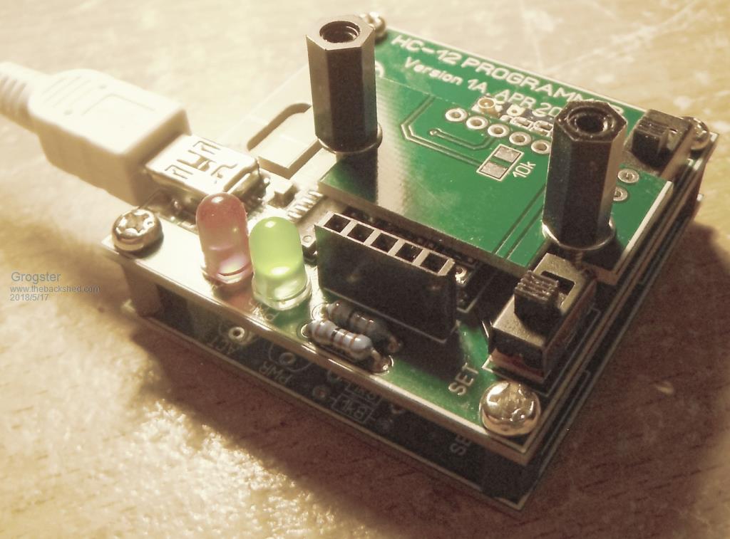

Posted: 09:40am 17 May 2018
I have made a module clamp out of a spare PCB. I cut it down so that I just had the two slots. I fitted 3mm bolts from the bottom, added two more spacers, then used washers and more threaded spacers on the top. By screwing down the spacers from the top, you can get a nice even compression of the module on the pogo-pins. Works well.

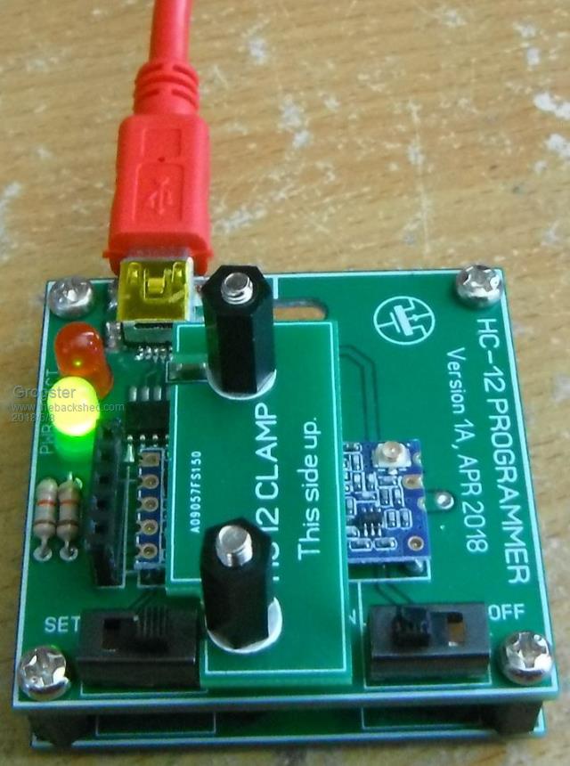

Posted: 11:42pm 07 Jun 2018
Here is a photo with the properly made HC12 clamp thing fitted.
