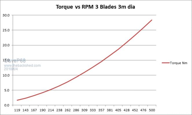

As per another discussion re the maximum amount of torque each stator will take, have done some more tests on a 1x12C Delta at various RPM/power levels.
At 500 RPM the stator output power was 539 W (192.5 V at 2.8 Amps DC) and got an input torque reading 12.6 Nm. A result I've replicated in the past and 82% efficiency.
Run it up to 575 RPM the stator output power was 622 W (192.5 V at 3.23 Amps DC) and the input torque increased to a maximum reading of 14 Nm. Drops down to 73% efficiency.
Run the test again at 1200 RPM (drill direct drive mode) output power was 770 W (192.5 V at 4 Amps DC). This is full stator saturation and the input torque dropped off a cliff all the way down to 7.5 Nm!!
I've never actually done any detailed testing on F&P stators outside what I considered their most efficient mode of operation. The big surprise was the stator was still operating at around 82% efficiency! The blades certainly won't want to operate for that long at 1000 + RPM...
There are plenty of comments on this website about F&P wind turbines going out of control when the core becomes saturated and other remarks like you can't put a short circuit on the output to stop them etc...
The point I'm trying to get across here is to let the stator(s) output voltage rise to level it needs to and not let the current exceed 3.3 to 3.4 Amps (2.8 amps is the optimum 1x12C Delta).
At high RPM the torque will stay in the 12-14 Nm range per stator and we should be able to avoid any unwanted saturation.
Anyway this latest information is to provide a better understanding of the operating envelope F&P stators and not intended to put anyone off using them on a wind turbine due this operating limitation.
We all learn something new every day. I'm sure plenty of others out there have been there done that in regard to whats posted above.Edited by DaveP68 2018-06-04

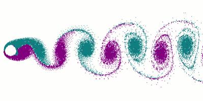

Free standing poles with small turbines on the top are very vulnerable to rocking, it is quite difficult to tune it out.
the vortex of turbulent air behind the pole oscillates like a top loader washing machine and creates alternating lift on the pole. It needs a flow breaker that spirals down the pole or a couple of tensioning wires.

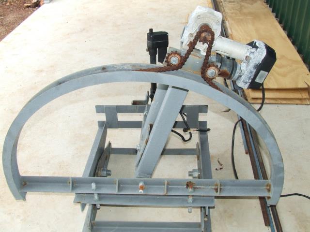

  Quote  Solar trackers have one supreme advantage, they only need to move very slowly. You are going to require something much more powerful that can shift the whole machine around faster than fifteen degrees per hour !
sigh!..... that is not how they work.
A plain old satellite actuator will move the shaft 3+mm per second at 5000 newtons. The solar actuators i have used will move a tonne and hold 2 tonnes. if you matched the linear reduction with a old drill planetary the most it would take for a full revolution is eight minutes.
there are plenty of options available with some scrounging and lateral thinking.

Posted: 08:06am 03 Jun 2018
Somewhere on the Internet I saw a variable pitch setup that used a cordless drill motor + gearbox + chuck, that turned a leadscrew, that operated a fairly simple variable pitch mechanism.

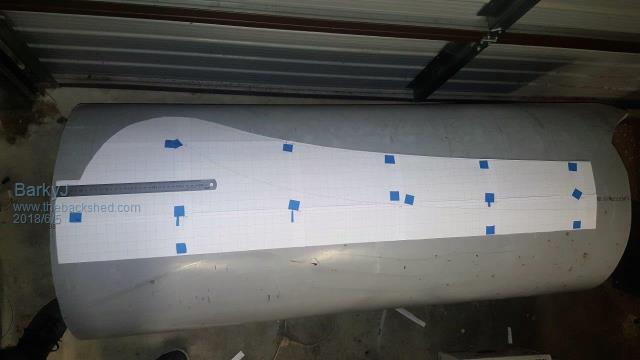

I am on to blade design at the moment.
Having a bit of 'fun' - hmm.
So I am going to be using this large diameter thick walled pipe to start off with.
Based on the RPM and power etc wanted, the TSR should be ideally around 7.5ish.
I have found 3 online calculators so far, which all output fairly similar things, one was designed specifically for pipe blades, where you can enter the diameter of the pipe, TSR, radius, yadda-yadda, and it outputs an SVG file which you can print 1:1 on a few sheets of paper, cut it out and then trace on the surface of the pipe.
What I got though was quite a behemoth.
Had a massive 190mm or so tip, which tapered up to a massive 380 at the root, before tapering back for mounting onto the hub. This just seems massive, for a 1350mm length blade.
From what I understand, on these sorts of blades, the root is what assists with low wind starts, and the tips are tapered to reduce noise.
Here is a reference I found, some good stuff on the last page:
http://www.scoraigwind.com/wpNotes/bladeDesign.pdf
The calculator that I used to print off this blade shape, was here:
http://www.windandwet.com/windturbine/tube_blade/design.php
I have seen the Warlock.com.au one too, but that seems more for real blades, not pipe blades.
If I was to go with the GOE222 blades, then to get a TSR of 7.5 or so to match the stator setup, then it would seem I would only need a 2 blade setup, rather than 3 that I am planning for now. 10/sqrt(2) = 7.
But would a 2 bladed GOE222 work OK...
I don't want to go there yet, just planning for what is likely going to be the inevitable though.
Given my pipe is 630mm diameter with an 18mm wall, I could sculpt them quite nicely to be better than just a thin PCV pipe would be, but stll the question remains as to what sort of shape is right.
What I had originally drawn down was more like Gizmo's 6 bladed setup he had on his dual stator windmill, on this page:
http://www.thebackshed.com/Windmill/articles/GlennL.asp
I am thinking about a 50mm tip width or so, going up to maybe 160-190mm sort of root, then tapered back a bit for mounting onto the hub, with steel bracing about 1/3 up the blade back to the hub for extra support.
Does this seem like a valid place to start?

BarkyJ
Joined: 26/04/2018
Posts: 114
Posted: 02:44am 05 Jun 2018
Here is a pic of what that calculator came up with, paper cut and sitting on top of the Pipe.
Massive.
Posted: 02:58am 05 Jun 2018
[quote]Humble drainpipe I am unsure what it will prove though.[/quote]
Probably nothing, but it should give you a better idea of what its going to look like in three dimensions.
I tried this myself a long time ago out of curiosity, but there was nothing scientific about how I did it. One thing I quickly discovered is that once you cut a circular pipe into a flat strip, most of the stiffness disappears.Edited by Warpspeed 2018-06-06

Posted: 07:20am 05 Jun 2018
thin walled pipe blades are not aerodynamic despite what most of the sellers say. if you can get any sort of aero shape out of your thick walled pipe you are well out in front.
those blade with the beer belly curve down towards the root work on small low speed turbines BUT they also have a twist in the blade so the angle of attack is much steeper down there to cater for the low blade speed close to the hub. nothing to do with low wind speed. the link I posted to the pitch control has some profiles of some aero shapes a few pages in (before page 12 I think) you might find a stubbier profile that fits the pipe better than the geo-222
95% of the power comes from the outer third of the blade, taper is not that important. When your blades hit their speed limit the last couple of inches might progressively lose lift, this is where the noise comes from. there is a technical term for it that I have forgotten.
I have worked on a few 2 blade turbines, they scare the hell out of me, three blades make the rotor much more stable.
I wouldn't over think this, you want as much lift as you can get on the outer third of the blade to get the best low-medium wind performance, you will NEVER use the blades potential in high winds you will always be speed limiting above the 9-17 m/s range

The upper Torque limit that the Dual F&P stators can take without any other modifications is about 28 Nm at 400-500 RPM.
I think there is merit in making some scale blades out of a short piece of 90 mm diameter PVC drain pipe like Tony suggested.
