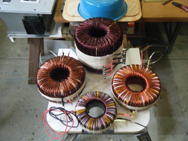

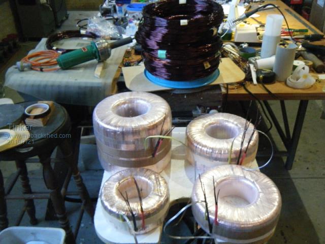

Here are the 4 transformers all in their copper clad finery
You will notice that the original stack of copper wire behind the bare cores had shrunk a fair bit by now, I had planned to use the reminder for the primary windings.

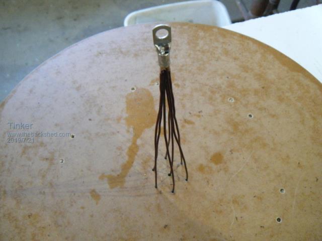

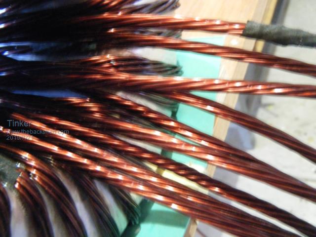

Previous attempts shown on this forum to use small enameled wire for the primary did not appeal to me so I created my own version - proper spun 7 strand wire.

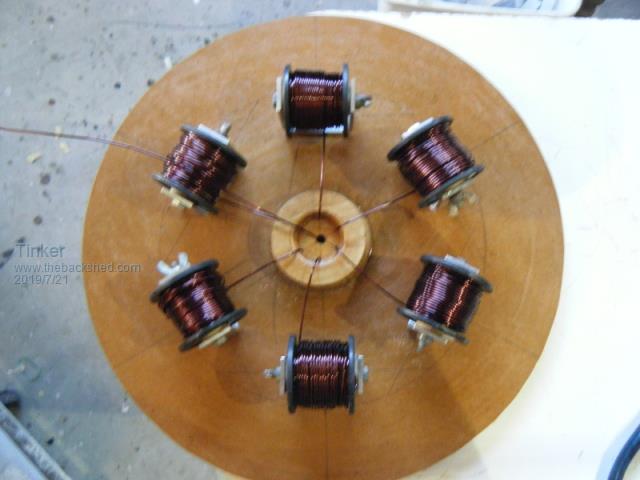

For this I required a 'spinning' gadget, this is what I came up with:
The 'spinning' side.
And the supply side.
Well, it actually worked - once I had figured out there was a trick or two how to use it .
Here is a close up of my 7 x 1.5mm spun wire.

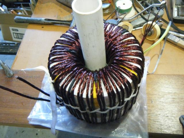

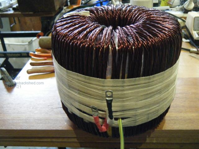

And now a picture of the first of the three in hand wound on. The white split PVC presses the wire out while the epoxy sets.
After winding on all three 'hands' the thing now weighs this much.
Real hernia danger to move that lump around, definitely not a job for the kitchen table.

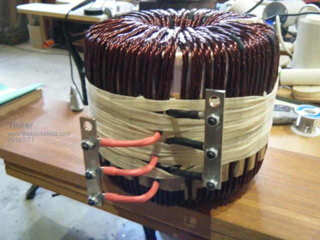

A view of the primary connections.
And another of the secondary. I placed the connections on opposite sides of the core.
The other 3 transformers were terminated similarly.
Here is the lot of them all done .
You may notice the pile of copper wire behind the transformers shown previously had disappeared. This is because I used *all* of it. There was just enough for transformer # 1, 2 and 4. I used some new 1mm wire I had sitting on the shelf to make the #3 transformer 7 strand spun wire. This, BTW, was a lot easier than spinning 1.5mm wire. For the 22.5m required, my back yard was just long enough to stretch it out.

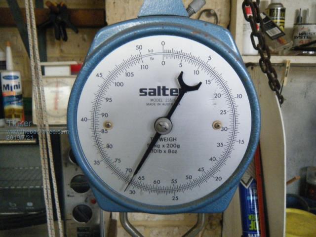

The combined magnetising loss of all 4 transformers is 19.95W - good enough for me
All 4 transformers weigh in at 59.10kg (~130 lb) which might be a concern for some of the wannabe warpinverter builders here.
The total weight of copper wire used was 15.3kg, fortunately all was recycled from these and other torodial cores. Torodial cores are usually not lacquered so the wire comes off in relatively good condition for straightening and re use.
If the donor transformer had its winding lacquered its only good for scrap copper IMO. There is way too much work involved with winding the transformer(s) - about 70% of the total work of building a LF inverter - to risk iffy enameled wire.
Anybody planning to start building a warpinverter with the PCB's, there is only about 10% of the total work involved spent with assembly of the dozen boards required.
It would not be smart to spend money on PCB's and parts only to find out later the transformers were beyond one's capability.
A low frequency inverter without a working transformer is about as useful as a car without an engine .
My warpinverter is now about 90% complete, next is making a cabinet to fit all the parts and then connect it up & test it.
