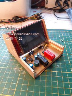

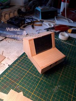

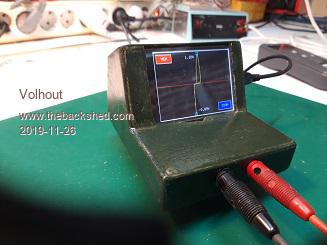

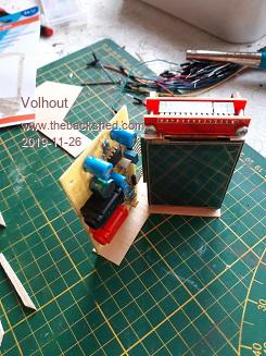

About the backpack tracker....
Finally decided to finish it. I had plans to improve the tracker using a ArmiteF4, then investigated the PicroMite. In the end, decided to leave it as is. It is good enough for me.
Used some thin wood to build a case, painted it army green (don't know why, not really happy with the color now) an use it now. I will give it a second layer of paint (this one is not covering well) and add a  sticker with text "Backpack Tracker" next week.
But it works, and is used...

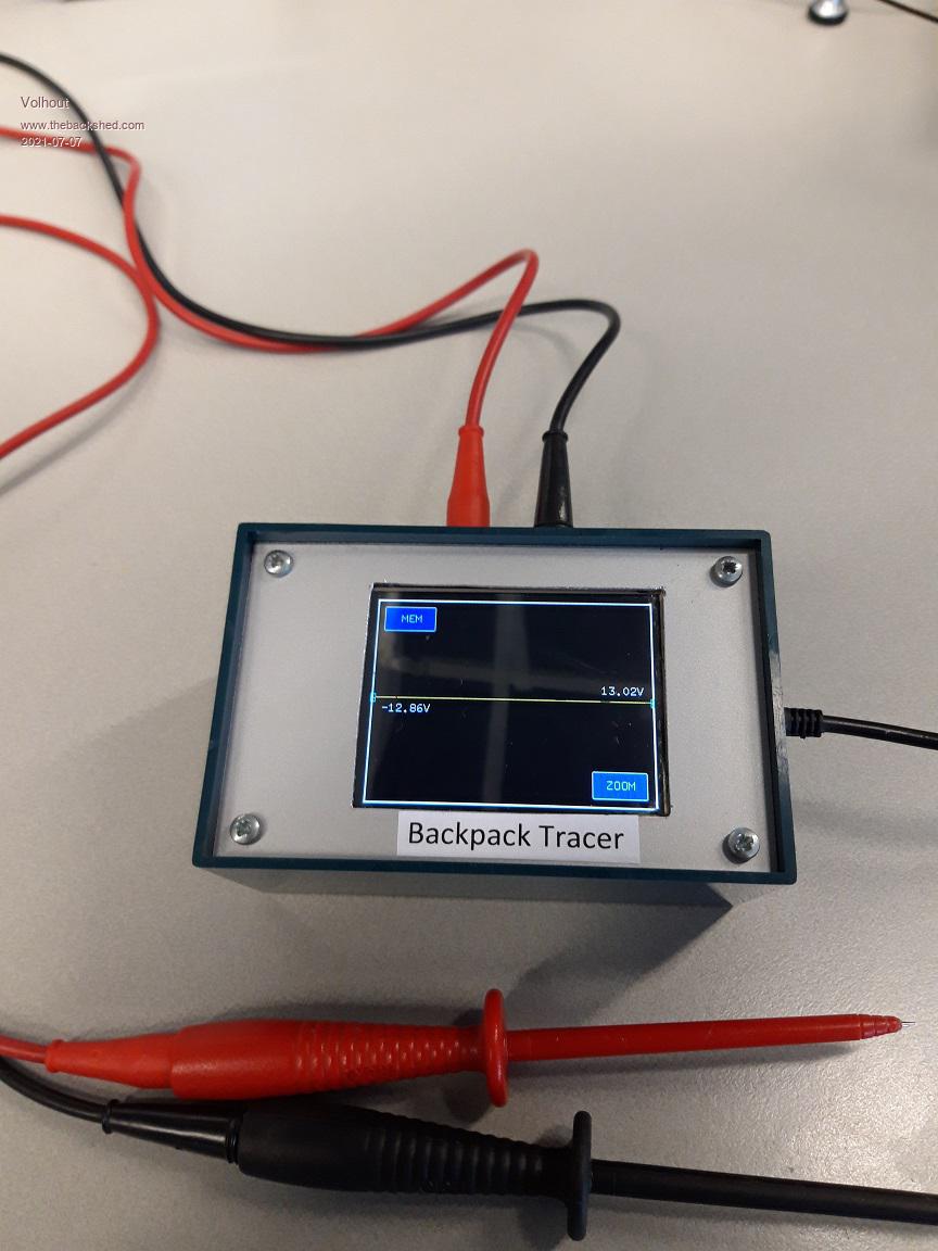

New housing, the old one cracked when I stepped on it...
I still often use it...

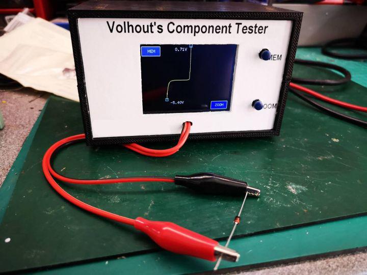

Posted: 08:10am 28 Aug 2021
I made one.
Quickly knocked this together over a weekend using Volhout's PCB, one of my own postage-stamp controllers and a non-touch 2.8" display.
3D printed a box for it and rammed it all inside - not showing that coz I am not proud of the hook-up wire and hot-glue solution (it was a weekend and I just wanted to get it done )
Tweaked the software to remove the touch functions and some other bits (now I know the secret of the white border!). Replaced touch with discrete push-button switches, I prefer the tactile-ness of them on test kit. Kept the displays for each function because they are as good as any.
5V inputs on the rear (with simple schottkey diode reverse polarity protection) takes a pair of banana leads from my PC bench supply and we are good to go.
Has already done some sterling work in helping me sort a "mystery bag" of un-marked zeners of various flavours - in the pic below is a 1W 5V6 in the process of identification. This work alone could have taken a day with a bench supply, adjusting up and down to find the knee then checking forward with a DMM, but did 100+ zeners (including two duds) in a long lunch.
Cheers Harm!
