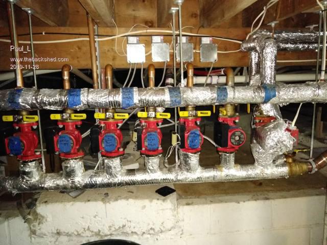

@Mixtel90 -- Sorry to hijack your thread. I was surprised by the specs and the price for the CPC1998. I like your idea of putting a red led in series with the gate to provide an indication of operation!
In an attempt to isolate the micro board from 120 vac circuits I immediately visualized a tiny PCB with one CPC1998 enclosed in a galvanized electrical junction box mounted near each pump with a separate 120 vac feed in Greenfield armor feeding each junction box and pump and clamping or cementing the CPC1998 inside to the box interior. UL Junction Boxes These boxes would have a surface area of at least 40 sq in (260 sq cm ???) with the cover. I suspect that this surface area would be more than adequate to cool the junction. With 6 to 10 junction boxes separately mounted on each pump there would be no mutual heat concentration.
@Tinine -- I particularly like the optically isolated input and zero crossing behavior which you reference. I have not been able to find a source for the Kunze KU 1-59 heat sink, the phase change interface material KU-ALC 5 and the transistor clip KU 4-499/1. I think you're right that they won't even get warm to the touch.
@Volhout -- The ambient temperature down there in my cellar will vary from about 5°C to 38°C seasonally. Thanks for posting the graph from the Ixys spec sheet.
But now, back to the previously scheduled program.
Switching regulators can definitely throw a monkey wrench into the works. A few decades ago I attempted to use a swicher to replace a linear regulator feeding an automated test setup for the B747 Delco INS computer. When it was lightly loaded the on duration became so short and the ripple voltage so high that the INS computer under test would reboot ... OOPS ... back to square one.

Hi Andrew, thanks for looking but the G3MB series is obsolete and the newer G3MC price is up in the same region as the CPC1998. In this application the unit cost is not the controlling factor. Since the pumps and their wiring are not very accessible and reliability is paramount I think I will stick with the newer part with the higher current rating. The CPC1998 will be replacing much more expensive mechanical relays and will probably be very satisfactory if I can keep them cool.
Paul in NY
