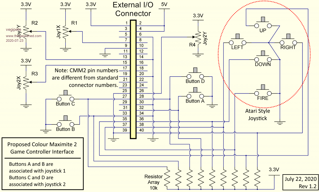

I took Bill's connector function diagram
  Turbo46 said
and turned it into a
CMM2 circuit diagram (hi-res). Hopefully I got everything correct. The only change is the addition of one extra digital input for the fire button of a standard Atari joystick, connected to pin 37. This keeps the digital joystick completely separate from the analog ones and allows the Atari joystick to function with only the end 6 pins (35 to 40) of the connector (plus 3.3V for the pull-ups.)
A note about 'classic' joysticks:

  vegipete said  I took Bill's connector function diagram
Classic joysticks, paddles and similar analog input devices, as used for example on Apple][ and IBM-PC computers, are a little bit tricky to use on the Colour Maximite 2. This is because the CMM2 has actual analog to digital converters which expect to digitize an analog voltage. This differs from the classic computers that had no such converters and instead measured the time it took to charge (or discharge) a capacitor through a variable resistor. As a result, the potentiometer is wired as a variable resistor and usually lacks the third wire needed for a voltage divider. At the cost of reduced precision, a suitable resistor pulling the analog input up or down as required should work.
Regarding the pull-up resistors for the buttons - do you want these even though the CMM2 has its own pull-up option for pins?
For arcade controls people may want to support multiple buttons with the digital joystick. I might go with the original A&B, or A,B,C and D in that case. I think it should be easy enough to support that in one set of code with support for your one button joystick, at least for one player games.

vegipete
Joined: 29/01/2013
Posts: 1185
Posted: 02:38am 23 Jul 2020
  capsikin said  Regarding the pull-up resistors for the buttons - do you want these even though the CMM2 has its own pull-up option for pins?
External pull-ups guarantee the pin state even on power up, before optional internal pull-ups can be turned on. Just to make sure.
  robert.rozee said  be aware that using pin 40 is not safe. if it is grounded at startup the CMM2 will erase option settings and (i believe) any user program in flash.
Pin 40 held low on start up is a bigger problem. An Atari joystick held to the right erasing the option settings is less than ideal. I would suggest the start up firmware could be changed to look for a link between pins 40 and 38. If one of the pins tracks the highs AND lows of the other on start up, there is a good chance they are jumpered together - deliberately.

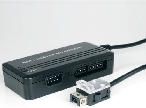

Check out this addapter.  I have no NES of SNES controllers but have a crap load of PS2 and PS3 controllers.  I got one of these just to test it when I get my CMM2(Still waiting PATIENTLY!) It could be good.  It maps all the PS controls directly to the corresponding on the WII clasic. I have some old favorite PS controllers I would love to use again.
https://www.amazon.com/gp/product/B002OJ8S7C/ref=ox_sc_act_title_2?smid=ATVPDKIKX0DER&psc=1
At what point is the grounding of pin 40 checked--is it by some waveshare or on-chip firmware, or is it in MMBasic. If in MMBasic, could there be a prompt at startup asking if the user wants to do the erase, with perhaps a timeout of some period in case part of the problem being corrected by the erasing is lack of connection to console?
Perhaps if the erasure is done, a restore image could be written to the SD, with a notice on rebooting after erasure that OPTIONs, etc. could be restored.
One of those might also help, yeah.
