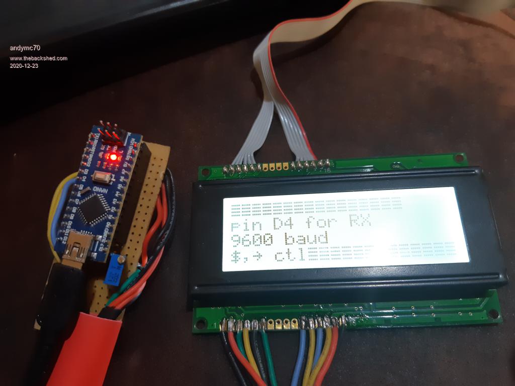

Hello All
Finally back into the inverter full time now, work, Xmas, and family commitments had put it on hold.
Firstly I want to thank Peter for the time we spent together, it was awesome meeting and seeing you and your setup and learning so much from you. Thank you so much.
Now onto the inverter, ok I am trying to load the software onto Nano 2.
Now I have set up my LCD to use serial and I have run the code above, with changes to the numbers in this line LiquidCrystal lcd(12, 11, 7,8,9,10), to match the blank lines on the Nano 2 in the circuit diagram. Please see the picture below to see what the program is returning on the LCD.
A big tip for beginners a potentiometer is needed to see the screen.
I am not sure why the top line looks like it does as when I delete say the bottom 2 prints print("9600 baud"); & print("$,~ ctl"); I then can see the Serial -> LCD printed. So not sure if this is a problem.
The other problem I am having is how to put this code and the nano2_5_ac_current_sensor_continuous_on_off_control_softserial together onto the nano 2. If someone can help with this that would be great.
I am about to finish the nano control board and add power as I go. The powerboard is ready to go. So I just need to put some cable lugs onto the transformer and choke as well as finishing the switch and Feedback transformer connections and then I am ready for testing.
If someone can help me thru the before, during, and after testing procedures that would be great.
Andy
poida
Joined: 02/02/2017
Posts: 1507
Posted: 11:51am 23 Dec 2020
"The other problem I am having is how to put this code and the nano2_5_ac_current_sensor_continuous_on_off_control_softserial together onto the nano 2."
Are you saying you think you need to flash both programs into the one nano?
If so, that is not what is needed.
The inverter (nanoverter control board) needs two programs, one each for the two nanos that are on the board.
And yet another small program for the nano that drives the LCD.
But first, well done to get the LCD going. And yes, sometimes you need some sort of
voltage between 0 and 5V to make the LCD show a usable contrast.
I bought a few LCDs that work fine with 5V on the contrast pin.
Others I have needed a pot to tune the voltage "just so"
The firmware "nano2_5_ac_current_sensor_continuous_on_off_control_softserial"
is loaded into nano2.
Then you need to load the (what I call "proper" code) into nano1, which does the real work. something like "nano_1_v7_no_bessel"
Using the software serial firmware for nano2 will be best, since it will work if there is a LCD present or not.
There is no further work to do with nano1 once you load the firmware into it.
Nano1 only does one thing: run the inverter.
Calibration is only concerned with nano2. This is where we set the AC output voltage
and other parameters.
If you want, come on over again with the powerboard and nanoverter control board after New years and we can bring it up safely and calibrate it to some extent.

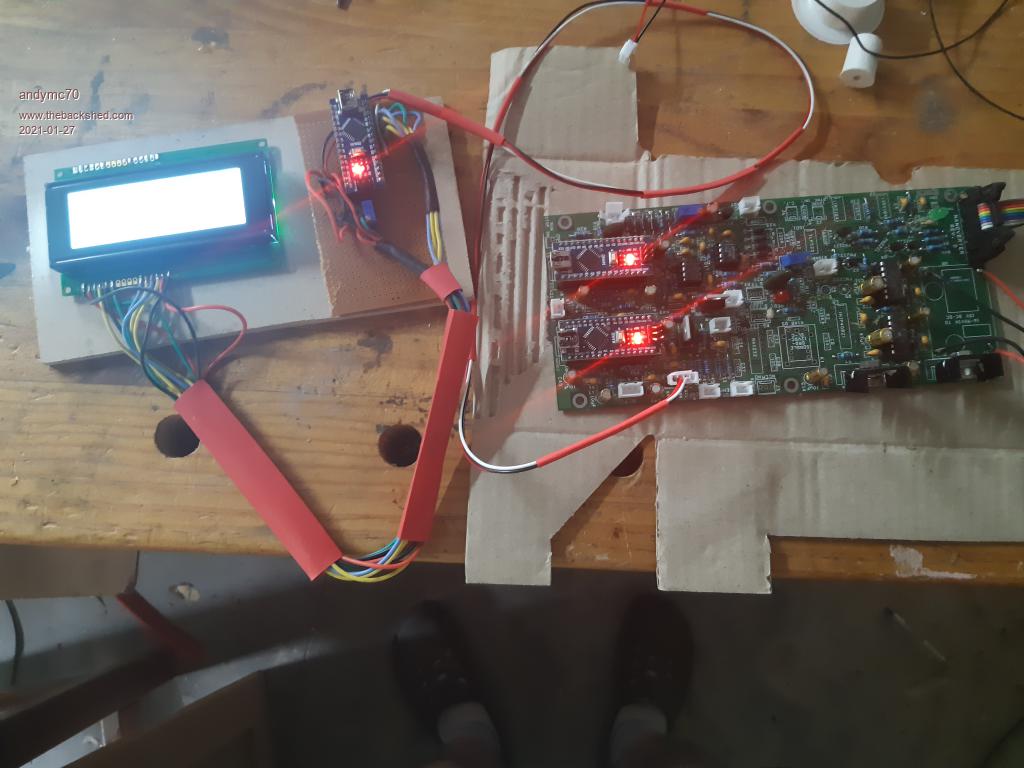

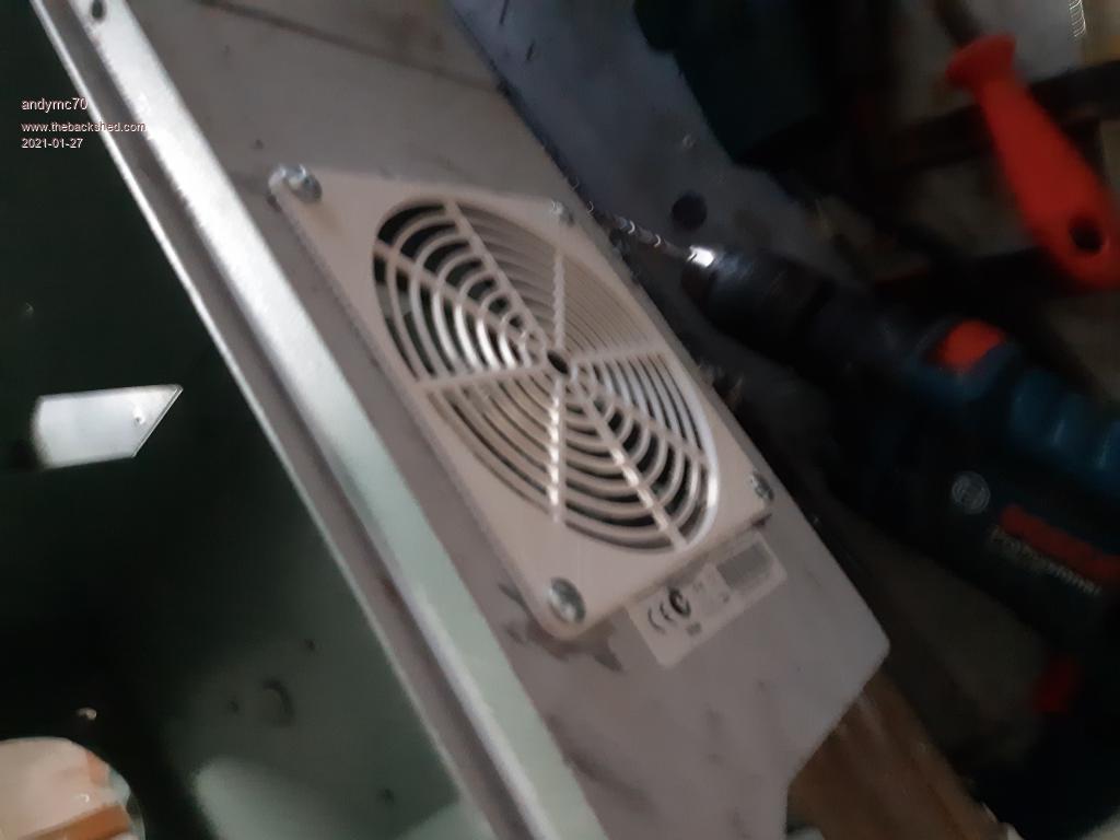

Posted: 10:40am 27 Jan 2021
Hello All
Thanks to Peter I finally got the Inverter to work on my toroid.
I had the battery going throw the heat sink and Peter said that wasnt the best way to do it, so I changed it back to the board and bingo 240VAC out of the inverter.
The next problem was the LCD, finally got that working as well. I need to pay more attention when desoldering, when to remove wires from the LCD I found I had short circuit some legs, fixed them and bingo.
Now I have been making the container, cut the fan holes out, that was fun. Sorting locations for everything.
Been designing some fan guides and some spacers for the boards.
Trying to get the whole inverter running, I just wondering how people have earthed their inverters.
Also, I wonder how people have soldered up the large caps on the powerboard, do I just go ahead and solder all cap and place the heatsinks on and put it all together.
Andy
poida
Joined: 02/02/2017
Posts: 1507
Posted: 11:42pm 30 Jan 2021
Andy:
good to see it working.
I think you are using the fully populated powerboard. Is that true?
The next steps would be heatsinks, making sure there is space enough
for the large caps.
Then fit the caps. I think you have a large soldering iron that can dump
a lot of heat so that's sorted. If not, come over to borrow the JCL.
When doing the heatsinks, do not overlook that the low side heat sink
needs to be cut into 2 parts with a safe and reliable (in the physical position
sense) gap. Should they touch when running it will be a short on the transformer
primary output terminals.
