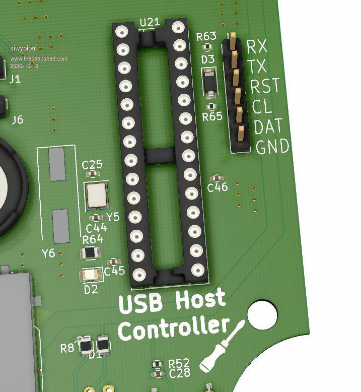

siwypiotr
Joined: 18/08/2020
Location: Poland
Posts: 127
Posted: 01:41pm 12 Oct 2020
Looks like Im done
Posts: 11913
Posted: 02:36pm 12 Oct 2020
Suggest you connect to I2C2 (pins 27 and 28 on the 40-pin header) - I'll make this the default in the S/W

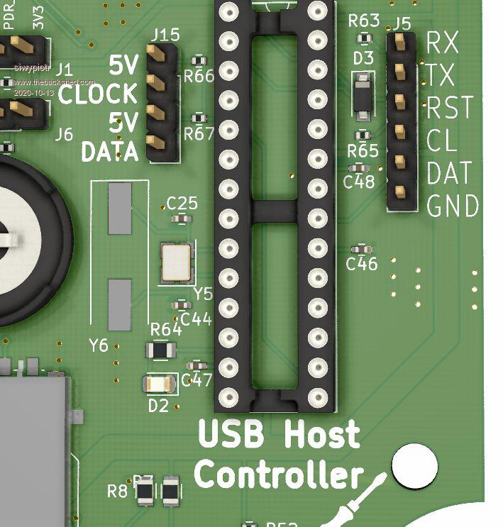

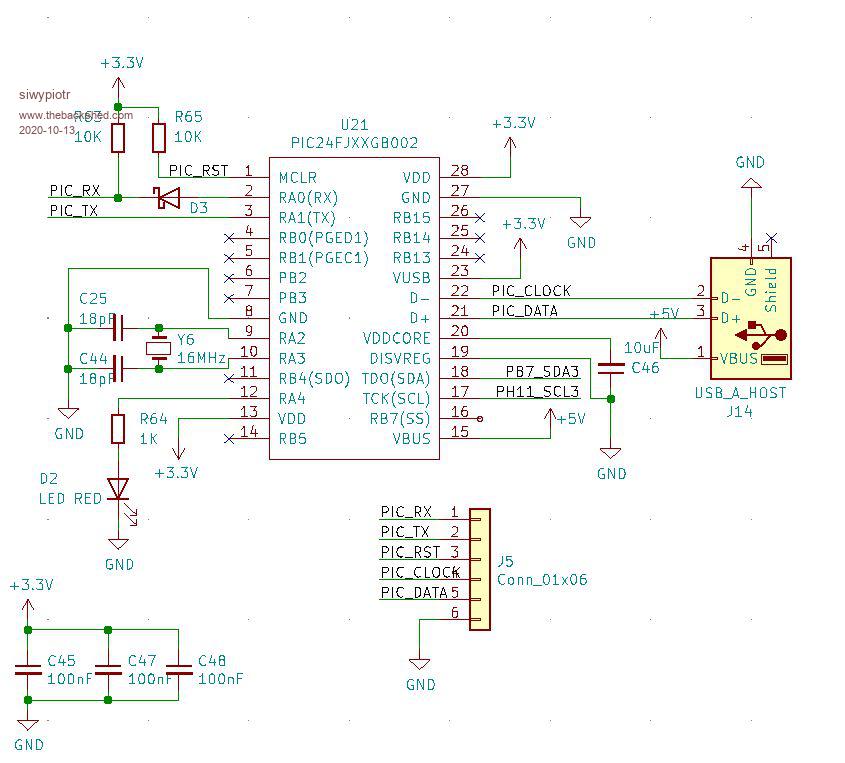

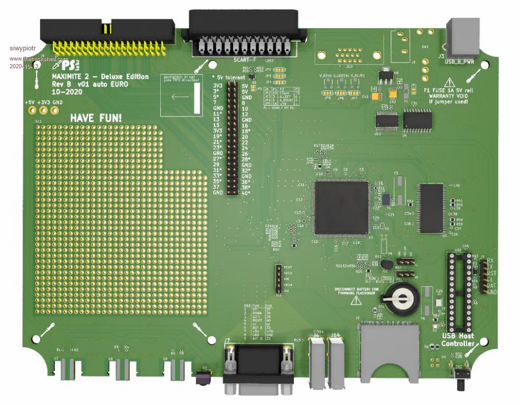

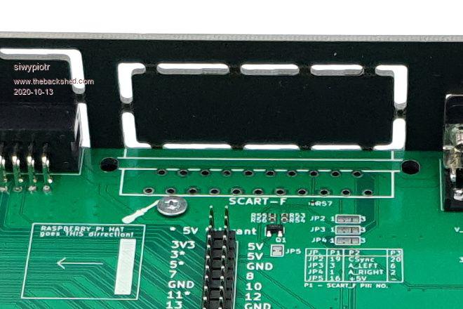

Revision B of my Maximite Delux is done:
Here is schematic for the mouse controller from hobby electronic (just drop IC to the socket):
I will order PCBs + assembly tomorrow, please have a look if I did not missed anything.
vegipete
Joined: 29/01/2013
Posts: 1185
Posted: 05:57pm 12 Oct 2020
Could you add optional pull-up resistors on the PIC_CLOCK and PIC_DATA lines between U21 and J14? Pins 21 and 22 are 5V tolerant, so the pull-up can be to 5 volts.
This would allow a suitably programmed U21 to talk to PS/2 mice also. (Pulling these 2 lines high puts a dual mode mouse into PS/2 mode.)

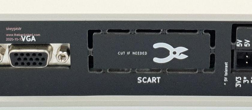

  siwypiotr said  Revision B of my Maximite Delux is done:
Looks good.  I've seen some variations with a SCART socket, some with VGA.  Is that an option?  Which are you intending to ship as standard?
I think I see an extra USB port on the front for the mouse.  Is the Joystick port a standard Atari D9 connection and pinout?

Posted: 07:11pm 12 Oct 2020
Yes there will be mouse support.
DB9 pinout is standard for Atari joystick or SEGA gamepad. Pinout vs GPIO is as follows:
DB9 FUNC -> GPIO
1      UP -> 35
2      DOWN ->36
3      LEFT -> 38
4      RIGHT -> 40
5      -
6      BUT A ->32
7      +5v
8      GND
9      BUT B ->33

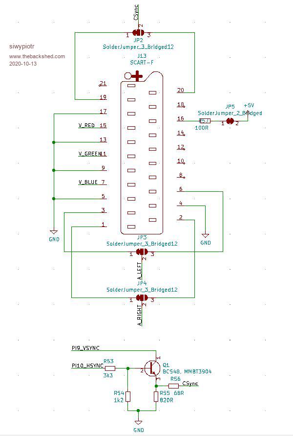

Currently there is VGA. SCART is something I work on, everything is populated and requires only adding SCART plug. back panel is prepared to be easily cut to have the place for SCART:
Unfortunately it does not work, there is image but no synchronization, maybe I failed somewhere on my schematic:
I need to work on it. The final goal is to have both VGA and SCART

Posts: 127
Posted: 07:13pm 12 Oct 2020
  vegipete said  Could you add optional pull-up resistors on the PIC_CLOCK and PIC_DATA lines between U21 and J14? Pins 21 and 22 are 5V tolerant, so the pull-up can be to 5 volts.
Sure no problem I can add pullup + solder jumper. How much 1K or 10K ?
vegipete
Joined: 29/01/2013
Posts: 1185
Posted: 08:56pm 12 Oct 2020
2.2K seems to work well.
Holes for 4 header pins, similar to RUN/PROG, if possible, so that jumpers can be added or removed as required. (No need to populate the header pins though.)
siwypiotr
Joined: 18/08/2020
Location: Poland
Posts: 127
Posted: 08:58am 13 Oct 2020
  vegipete said  2.2K seems to work well.
Ok added:
