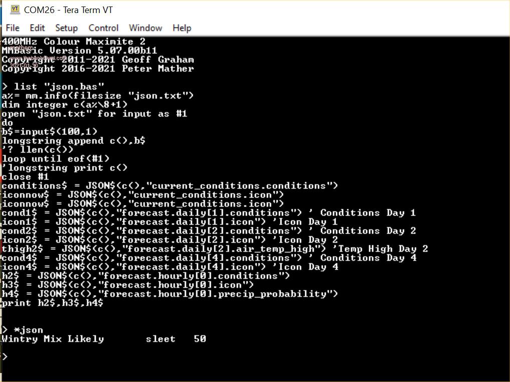

These are the 3 wget where json is collected
system "wget -q -O- "+q$+"http://swd.weatherflow.com/swd/rest/better_forecast?api_key=20c70eae-e62f-4d3b-b3a4-8586e90f3ac8&station_id=10170&lat=53.439&lon=-2.106"+q$,c() 'get forecast ready to parse - this data is large!
system "wget -q -O- "+q$+"https://swd.weatherflow.com/swd/rest/observations/?device_id=35102&api_key=20c70eae-e62f-4d3b-b3a4-8586e90f3ac8"+q$,a() ' get data from Air device
system "wget -q -O- "+q$+"https://swd.weatherflow.com/swd/rest/observations/?device_id=35103&api_key=20c70eae-e62f-4d3b-b3a4-8586e90f3ac8"+q$,b() 'get data from Sky device
If you meant how do I parse the data at present using just the pi?  here are some examples
conditions$ = JSON$(c(),"current_conditions.conditions")
iconnow$ = JSON$(c(),"current_conditions.icon")
cond1$ = JSON$(c(),"forecast.daily[1].conditions") ' Conditions Day 1
icon1$ = JSON$(c(),"forecast.daily[1].icon") 'Icon Day 1
cond2$ = JSON$(c(),"forecast.daily[2].conditions") ' Conditions Day 2
icon2$ = JSON$(c(),"forecast.daily[2].icon") 'Icon Day 2
thigh2$ = JSON$(c(),"forecast.daily[2].air_temp_high") 'Temp High Day 2
cond4$ = JSON$(c(),"forecast.daily[4].conditions") ' Conditions Day 4
icon4$ = JSON$(c(),"forecast.daily[4].icon") 'Icon Day 4
h2$ = JSON$(c(),"forecast.hourly[0].conditions")
h3$ = JSON$(c(),"forecast.hourly[0].icon")
h4$ = JSON$(c(),"forecast.hourly[0].precip_probability")
I can't parse the data from the Air or Sky devices at present I have to use the field$ command as below

Posts: 11982
Posted: 10:17am 30 Jan 2021
Sorry but could you also post a small simple json string and some relevant json$ function calls
lew247
Joined: 23/12/2015
Posts: 1709
Posted: 10:45am 30 Jan 2021
Easier to post the program, you can pick what you need because I'm not certain what you meant
notudp1.zip
Posts: 11982
Posted: 11:23am 30 Jan 2021
OK
I've got the json$ function working nicely on the CMM2 and can parse your large json string so you have no excuse now not to buy one
Seriously though, the limitations are that the CMM2 will never have an in-built networking capability so you always be reliant on an external ESP (NB the Deluxe version currently offered by Piotr has a header to mount an ESP-01 inside the box)
Also, it is important to note the maximum resolution of the CMM2 display is 1280x720. This is a hard limit imposed by the capability of the chip itself
