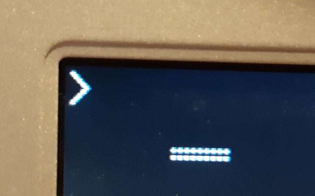

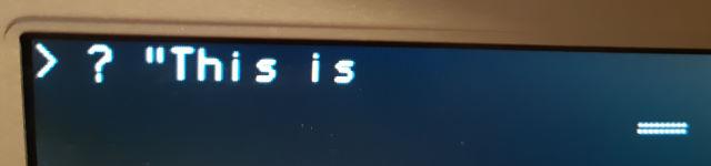

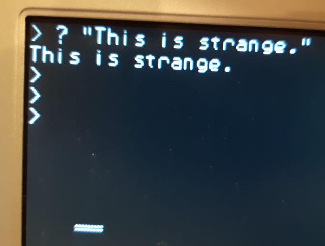

New weird thing.
If I exit the editor using F1, the underscore cursor is expanded and the system is in some strange video state. The video 'twitches' with the next command, the screen clears, then settles down.
Try 'F1' to exit editor, then immediately 'ls[Enter]' to list files.
Edited 2020-12-02 06:15 by vegipete

  Quote  New weird thing.
OPTIONS?
Edited 2020-12-02 08:50 by matherp

Posted: 01:28am 02 Dec 2020
OPTIONS?
The only option I've set is keyboard repeat.
> option list
CURRENT VGA mode 800x600 RGB332
CURRENT DISPLAY 50,100
OPTION USBKEYBOARD US
OPTION KEYBOARD REPEAT 400,30
Everything else is whatever happens from flashing firmware.
Same effect if I enter "option reset"
Anything mode command related fixes the problem. Some other commands do too. Generating a syntax error fixes it also.
The underscore cursor looks spread apart. The pixels are spaced one pixel apart. The character cell size appears double, although typed text is normal. Also, the CMM2 freezes once I'm 28 or 29 lines down the screen. The cursor disappears off the bottom at line 25 although the prompt character ">" is only half way down.
The individual cursor pixels are much more distinct than these photos show. The phote has blurred them together a bit.

Posts: 11904
Posted: 08:14am 02 Dec 2020
  Quote  I have to go back to few versions back, because after short time, my CMM2 locked up.
Rather than give up I really need you to identify the sequence of actions that causes the problems. For example if your are developing NC when this happens and you are using a CSUB then perhaps there is a correlation there.
I'm not going back to the 5.05 code base so this problem needs finding and fixing

Posts: 11904
Posted: 10:14am 02 Dec 2020
V5.06.00b11
This version fixes a memory corruption that occurs if you leave the editor with F1
It is strongly recommended that you upgrade to this version if you are using any of the V5.06.00 beta versions.
Note: The firmware is 758332 bytes long. You are strongly recommended to update using a USB A-A cable rather than over the serial connection. This is a lot of bytes to transfer over serial with no error correction!
