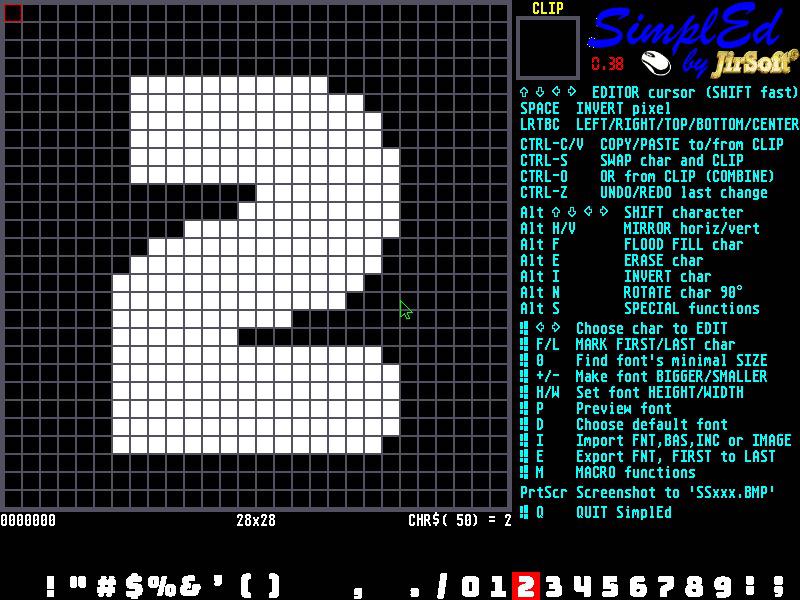

New version V0.38 with following change:
WIN+0 will find minimal WIDTH and HEIGHT for all characters from FIRST to LAST. It's useful after font scanning, so you can make the font size smaller. Be careful, the size is pure size (without margins). How to use it:
 go through font and erase random points from scanning
 get font size with WIN+0
 put all chars to RIGHT TOP (ERASE MACRO, RECORD MACRO, R, T, PLAY MACRO to FONT)
 adjust WIDTH and HEIGHT (WIDTH need to be multiplication of 4)
 put all to the CENTER (ERASE MACRO, RECORD MACRO, C, PLAY MACRO to FONT)
 go through font and with ALT+CRSR move chars to proper position if needed
This scanned font after 5 min of work...

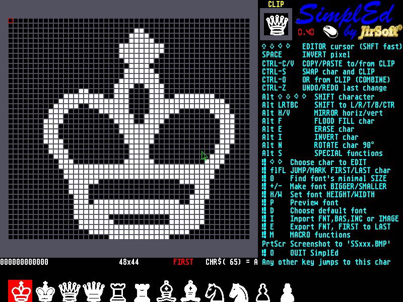

after some time I have updated SimplEd v0.40 with following changes:
+ IMPORT from image doesn't erase font, so you can import new characters from different images into same font
+ moving character cursor in image scanning is faster with SHIFT (10 pixels)
+ some shortcuts were changed
1. moving character LEFT/RIGHT/TOP/BOTTOM/CENTER is now with ALT
2. WIN+SHIFT+F marks FIRST char in font (USED for preview and export)
3. WIN+SHIFT+L marks LAST char in font (USED for preview and export)
4. WIN+F jumps to FIRST char
5. WIN+L jumps to LAST char
6. all other keys jumps directly to this char!
Enjoy!

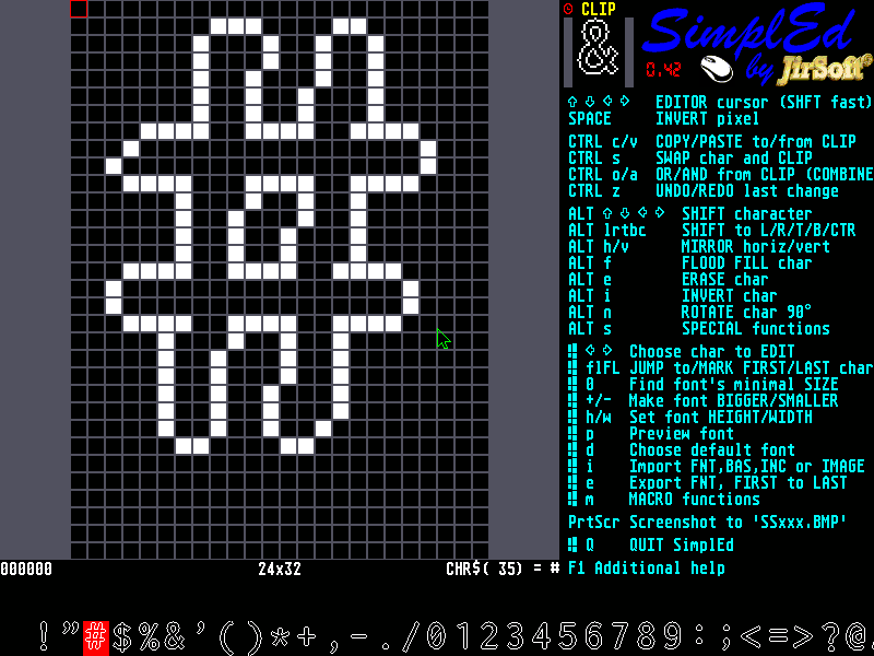

Hi all SimplEd users,
I have updated it to version 0.42. What's new:
1. edited char can be also ANDed with CLIP (it could be just ORed before), it brings some interesting possibilities (see below)
2. CLIP can be saved into memory and loaded back (in Special functions), so you can actually use 2 CLIPs
3. MACRO can be saved into text file and loaded back. You can build library of macros...
4. F1 brings short help on the screen with some hints
With this macro (MacroOutline.TXT on GitHub)
'SimplEd macro recorded on 17-07-2021 at 23:24:45
10  'Invert char
13  'COPY to CLIP
23  'Save CLIP to memory
10  'Invert char
13  'COPY to CLIP
 6  'Shift/rotate left
15  'OR from CLIP
 7  'Shift/rotate right
15  'OR from CLIP
 9  'Shift/rotate down
15  'OR from CLIP
 8  'Shift/rotate up
 8  'Shift/rotate up
15  'OR from CLIP
24  'Load CLIP from memory
22  'AND from CLIP
you can convert this fontto this one

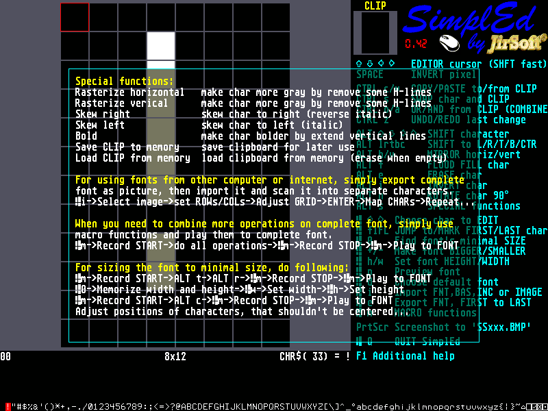

F1 help
Enjoy!

That is a really cool effect to dim the background for the help screen.
BOX AND_PIXELS 100,100,MM.HRES-200,MM.VRES-200, &h707070
Nicely done!
