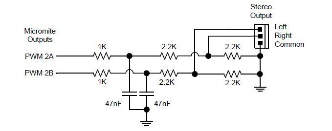

Are PLAY WAV and PLAY MP3 available on the F4 as on the H7? If so, is the circuit shown for the MM+ suitable (with DAC1 for PWM2A and DAC2 for PWM2B)?
Is the stereo output header shown suitably a mini-stereo socket such that speakers or a headset could be plugged into, or must it feed an amplifier like this or similar?

The armmiteF4 has DACs like the CMM2 so you don't need anything but a 4K7 series resistor may be prudent.
The ArmmiteF4 can play tones, wav, and flac but not mp3 (too much processing)

  matherp said  he armmiteF4 has DACs like the CMM2 so you don't need anything but a 4K7 series resistor may be prudent.
Thanks. 4k7 series resistor to a mini-stereo socket (for headphones or speaker) or to an amplifier?

Amplifier - not enough drive for anything else
