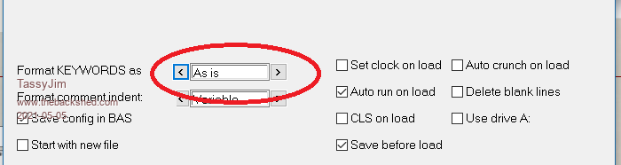

  Bowden_P said
My program is now quite large at 5482 lines and counting, with 2921 lines as code.
MMEdit seems to have slowed when saving or opening it with increasing size.
With regards, Paul.
MMEdit is written in an interpreted Basic so relatively slow.
One day, I will change over to PureBasic. (Some of the work is already done in helper files written in PureBasic.)
One thing you can do is set "Format Keyword Case" to "As is" in Preferences.

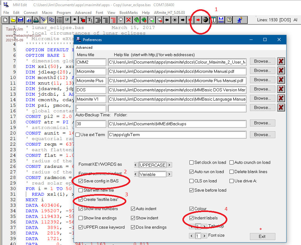

Posts: 6619
Posted: 06:03am 05 May 2021
Another source of slow saving:
As well as the normal .BAS file, MMEdit saves two other files.
First there is "lastfile.bas"  and then "lastfile.baz"
"lastfile.bas" is a copy of the last file and shouldn't be too slow but "lastfile.baz" runs through a MERGE and then CRUNCH before being saved. This will be slow.
These files make it easier to automate processes in external programs.
I will have a look at making saving these files as options.

Bowden_P
Joined: 20/03/2019
Posts: 174
Posted: 09:25am 05 May 2021
Hi disco4now and TassyJim,
Many thanks for your posts. I'll be updating #REPLACE a bit later today.
Just checked the "Format KEYWORDS as" setting - it is "As is" !
( When saving a file the cursor does much flickering between the mouse pointer and the hour-glass symbol - just like a manual crunch does - your MERGE and CRUNCH in action.)
With regards, Paul.

Posts: 6619
Posted: 07:18am 06 May 2021
Paul,
I have updated the version on MMEdit on my website.
It would be interesting to see if there is much improvement in the saving and loading speeds.
There is  a new option in Preferences - create 'lastfile.bas'.
If you don't make use of that feature, leave it unselected.

TassyJim,
"Format" in the old MMEdit behaved slightly differently to the new version in that most commands were spaced out from the l.h.s by at least 1 tab (except for SUB/END SUB). The new version only does this on the first "nested" and following commands. I know this is a personal preference, but I found the old scheme helped when spotting missing or excess ENDIF's or NEXT's etc. ( I find Format and the Indent Guides very useful!)
Also the current line keeps getting "forgotten" if the screen is changed to view a .pdf for instance - or even a Variables Report. This seems to get worse as time passes using MMEdit! (If there is some text selected this does remain selected, but the line highlight is missing, so the scroll wheel doesn't work.)
With regards, Paul.
Nothing so constant as change.
Posts: 6619
Posted: 09:49pm 08 May 2021
Paul,
Thanks for the timing data.
It is obvious that the delay on loading is between markers 4 and 5
Referring to the above image.
Item 1. The right arrow toolbar button is the one to go to a selected subroutine. If you don't have any sub highlighted, it will instead open a window with the full list of subroutines/functions. It is a function I use a lot but does need to scan the full file each time so will be slow for large files.
The rest are preferences which need resetting after the version change.
Item 2. Unselect this and it might make a big difference to loading times. Either way, I will know a bit more about where the holdup is after you remove that option.
Item 3. This is the one that was causing the slow saving. Keep that unselected.
Item 4. This is the one that controls the initial indent. Select it to have the formatting back the way you liked it.
