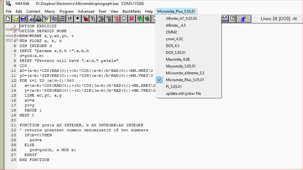

  palcal said  You have to download this file and put it in the MMEdit folder in 'Program Files'
File
I'm in, thanks a lot

Posted: 08:34am 22 Jul 2021
Connected with MMEdit and I'm just trying to do a simple A/D conversion on pin 31 and print it to MM Chat.

Sorry, Just re-read your reply and realised I am using the CMM 2 Chat.
I will see what other options there are.
Posts: 11744
Posted: 08:40am 22 Jul 2021
On the dropdown in MMEDit choose Micromite+
Glen0
Joined: 12/10/2014
Posts: 102
Posted: 11:11am 22 Jul 2021
Much appreciated,
I got as far as Micromite 5.05.01 which was more successful, but still had a count argument complaint. I will use your suggestion this weekend if I get a bit of spare time. Looking forward to getting it going.
