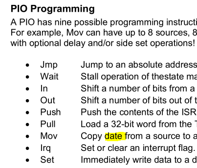

Drat! Data might be better than trying to use a PIO as a time machine.
Geoff?

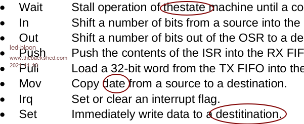

led-bloon
Joined: 21/12/2014
Posts: 210
Posted: 09:47pm 09 Nov 2021
Couple more in same paragraph (area) of text
led

  Mixtel90 said  Drat! Data might be better than trying to use a PIO as a time machine.
Geoff?
Thanks for doing this stuff, Mick! Tha's dun o-reet, owd mon
Would like to investigate further but I need to stay focused on the job-at-hand.
