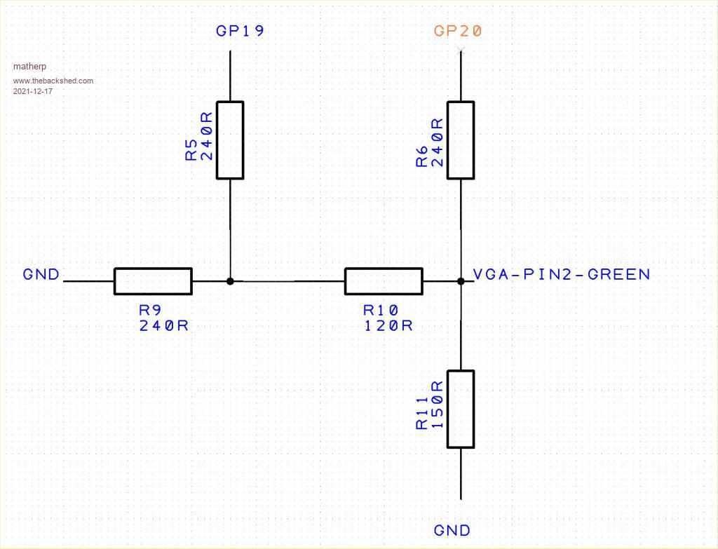

The pin for the mono VGA output has changed to GP20
Pins for colour VGA are:
GP18 - BLUE
GP19 - GREEN LSB
GP20 - GREEN MSB
GP21 - RED
In both cases connect
GP16 to VGA pin 13 (HSYNCH)
GP17 to VGA pin 14 (VSYNCH)
My wiring to get a good colour balance is as follows:
pin GP18 220R to VGA pin1, 1n4148 from pin 1 to GND

How critical are the resistor values to maintaining proper color balance? Use 1% resistors or is it acceptable to use cheaper resistors with greater variance in value?
What did you prototype with?
I'm also wondering if just simply routing R/B/G(MSB) (with resistor/diode) to VGA connector will look that bad for a simpler PCB (although since in that case we're not using the Green LSB I'm guessing the range of green will not be correct?). Also, the Green LSB will still be assigned for VGA colour use and not be able to be used for I/O?
Edited 2021-12-17 06:45 by flasherror
Posts: 3421
Posted: 09:53pm 16 Dec 2021
"How critical are the resistor values to maintaining proper color balance? Use 1% resistors or is it acceptable to use cheaper resistors with greater variance in value?
What did you prototype with?"
A) Human colour vision isn't too fussy and varies from person to person.
B) Monitors vary greatly.
Use a 220 ohm trim-pot for R10 and set it to what looks best to you on your monitor.

  Quote  Use a 220 ohm trim-pot for R10 and set it to what looks best to you on your monitor.
NO: Use a 220 ohm trim-pot for R11 and set it to what looks best to you on your monitor.

Isn't VGA connector pin 1 RED instead of blue so that GP18 (Blue) should go to VGA Pin 3(the Blue pin)? Same for GP21 (Red) that should go to connector Pin 1(the Red pin)? Is this correct and is a typo in the quoted post?
Edited 2021-12-17 09:32 by flasherror
Posts: 12085
Posted: 08:18am 17 Dec 2021
Oops - correction
pin GP18 220R to VGA pin3, 1n4148 from pin 3 to GND
pin GP21 220R to VGA pin1, 1n4148 from pin 1 to GND

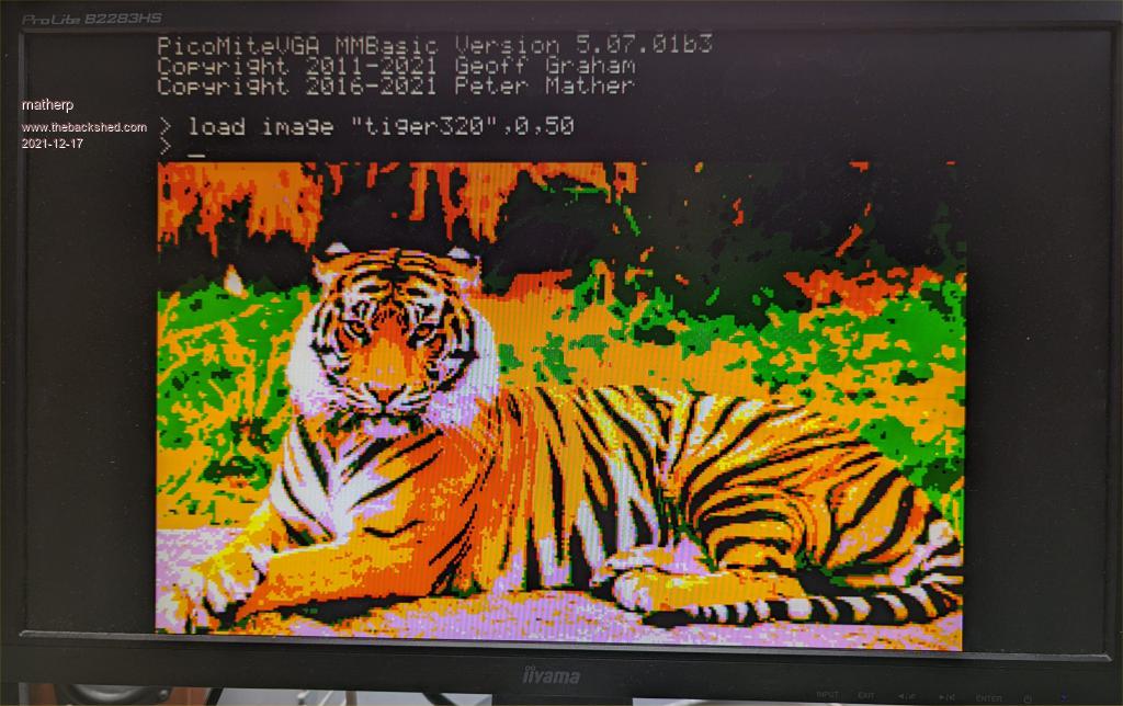

Posts: 12085
Posted: 10:53am 17 Dec 2021
PicoMiteVGAV5.07.01b3.zip
BLIT
PIXEL(
LOAD IMAGE and SAVE IMAGE now all working as per PicoMite manual.
Picture renders remarkably well considering only 16 colours available
This pretty much completes the PicoMite VGA edition with everything relevant from the normal PicoMite up and running and no obvious glitches or artifacts
As always if swapping between the PicoMite and PicoMiteVGA firmware you must clear the flash between each and it is always safest when loading new firmware as Basic tokens may have changed which will impact any stored programs

impressive stuff and being on the second core it has very little effect on performance(?)
