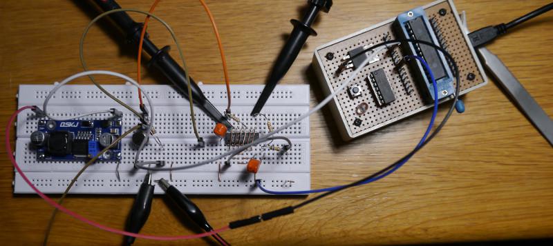

have had some success:
LT1021-5 reference, 74HCU04 powered from Vref (5v), with all gates paralleled, feeding via a 47k resistor into a 1uf integrating capacitor and from there via a 27k resistor into the LT1021's adjust pin. power is from a 5v->15v boost regulator running off the USB supply of the micromite.
using a 300Hz PWM i can achieve a Vref swing from 5.05v down to 4.82v, with about 2000 steps of adjustment available. that equates to a granularity of about 115uv (micro-volts), or 23ppm. this is nowhere near fine enough   :-(
using the combination of 47k/1uF/560k the swing reduces, becoming 5.016v down to 4.961v. now the 2000 steps available gives a granularity of about 28uv, or 5.5ppm. this is starting to get down to the level required to be useful for temperature compensation.
moving up to a 10kHz PWM frequency (still 47k/1uF/560k), i can trim to within 10uv, or 2ppm. typing at the command line PWM 1, 10000, -1227 produces a meter reading that flips between 5.00000v and 4.99999v   :-)
this is all built up on a solderless breadboard, with absolutely atrocious noise everywhere
next step is building a thermal chamber, and characterizing the drift of the LT1021-5 reference (untrimmed) over the range 5 degrees C to 40 degrees C.

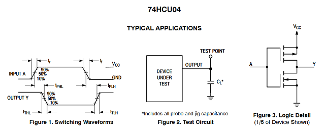

i'm following the suggested design put forward in the first post of this thread:
https://www.eevblog.com/forum/metrology/an-experimental-pwm-circuit-with-74hcu04/msg3921608/#msg3921608
there have been various discussions over the years about paralleling up CMOS gates to achieve the equivalent of a pair of closely coupled MOSFETs switching between supply rails. the onsemi datasheet for the 74hcu04 confirms:
(retrieved from: http://pdf-html.ic37.com/pdf_file_A/20200531/pdf_pdf/pdf4/ONSEMI/74HCU04_datasheet_830450/135209/74HCU04_datasheet.pdf)
you are 100% right, i need the full 5 volt drive on the PWM signal going into the 74HCU04. this explains a 0.15v low level output i was seeing when the PWM signal was driven high. will try convering the PWM to 5v levels this evening and see how it looks.

have added a BC547 to drive the input to the 74HCU04, with a 4k7 collector resistor to Vref and a 1k5 base resistor. this has improved the output swing of the 74HCU04 considerably. also added a few strategic filter caps to reduce noise. have also dropped the boost converter output down to 8v (from 15v, which was originally required for the AD587).
next is to add an opamp to buffer Vref prior to it being supplied to the 74HCU04. this should further reduce noise and in general tighten things up further.
the experiment is proving quite interesting

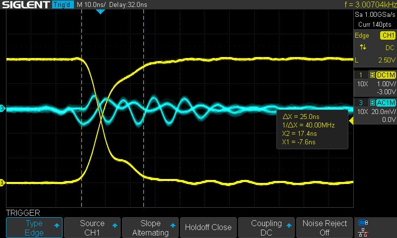

Posts: 6195
Posted: 09:43pm 23 Feb 2022
@Robert,
I am not sure if I can explain it in words. But there is one thing I have to warn you about.
The output of a PWM is dividing the input voltage by a factor DC (Duty Cycle).
This means that for a accurate output voltage, you need a accurate input voltage AND an accurate duty cycle.
The accuracy of the duty cycle is determined by the resolution of the PWM, but also the delays in the switch (74HCU04) and the level shifter.
The transistor level shifter (BC547 and 2 resistors) is relatively slow and highly a-symmetrical in delay (the output high-low is MUCH faster that low-high). Good for an experiment, but not suited for the final product.
To give you an idea of the speeds involved:
The PWM clock is 40MHz, so 1 lsb equals 25ns. To meet the 1 lsb resolution over the whole range, you need a switch that is faster than 25ns (The HCU is, but the BC547 not). So you will have to replace the BC547 with something that is fast, and translates 3.3V to the levels you require (5V or 6V or 7V). Preferably the slew rate is symmetrical (rise time = fall time). In example a 74ACT04 gate, or alternatively a 74LVC04 gate. And use a single gate input to connect to the MX170 output, otherwise you may load the MX170 output too much and it may become a-symmetrical also.
As much ridiculus  as it may look, I would build a chain.
MX170 -- 1xACT04 buffer -- 5xACT buffer -- 6x HCU switch -- RC filter
Get the first ACT buffer as close to the MX as you can, and add a series resistor (value to be tuned, but start with 22 ohm) between the ACT04 and the HCU04. This is to prevent overshoots at the HCU gate inputs that may cause misbehaviour. Put a solid ground plane under the MX-ACT-HCU section and good decoupling at the Vdd pins (for the ACT04 preferably with a ferrite bead to remove switching spikes from 5V. The ACT's are famous for this.
Happy experimenting....

Posts: 2552
Posted: 11:45am 24 Feb 2022
As much ridiculous  as it may look, I would build a chain.
good point, i had been hoping that the BC547 + 4k7 would be 'just good enough' for the job     this evening i tested a slightly simpler approach, reconfiguring the 74HCU04 as a single gate at the input end, that then driving into the remaining five. the BC547 et al are now eliminated, and the output at the 5x paralleled outputs looks like this:
the cursors (dotted vertical lines) are set 25ns apart, or the equivalent of one 40MHz CPU clock cycle of the micromite. as can be seen (yellow trace), both the high-low and low-high transitions now complete within this time interval, and are fairly closely matched in slope. the result is better than i expected!
the blue trace (AC coupled) shows ripple of 30mv or so on the reference output at each transition. note that both scope channels are set to 20MHz bandwidth limiting. my shoddy solderless breadboard assembly with long jumper wires is an RF nightmare.
