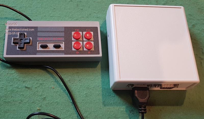

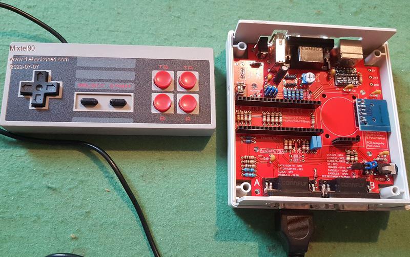

We usually order them from JLCPCB in China. You can get five rather nice quality boards for a Special Offer price because they are only 100mm x 100mm.
The PCB fits a nice little case:
This was a prototype:
