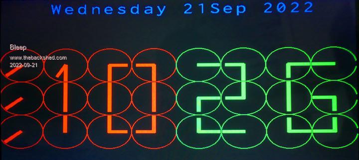

Hi Kevin,
I like the animations a lot, but observation of the screen shows there are animations that stretch out so long that the hands never pause. Nice to look, but if you want to use it as a clock, it should show the time at least 50 seconds per minute.
Maybe there is some tuning of the animations possible to achieve this.
Example: some animations move all hands (in fixed position relative to eachother) for 2 or 3 full circles, and then back for 2 or 3 circles. This simply takes very long, close to a minute (in combination with the movement to come from the time to this fixed position, en the time to get from the animation back to actual time.
Having said that
I defaulted to
animation=0
To avoid such long movements. Not sure if that is the best solution though....
You hear: I am actively using clockclock24....

Hi Volhout,
In normal operation, it takes about 20 seconds to change at the minute; every 6 minutes, which you can change if you want, (think it's a mod 6 somewhere) it does extra animation, with patterns, these take about 90 seconds, so you will miss every 6th minute, but all others should be shown. If not, use a faster CPU speed and or reduce the pause, there are two of them, one is only used when static, think it's 180, the other will speed up the animation, think it's 90, othrwise, from memory, there is a variable fine, which is set to 360 during the extended animation, if you set that to 180 everywhere, the extended animations will only go round once, instead of twice, so potentially will fit in a minute.

As per Peters suggestions, I have enabled the screen buffer, so animation is completely smooth now on VGA, I have also introduced the TILE command, so there is now colour on VGA, change, remove as you see fit. I have also increased the time between full animations to 12 minutes. Ref my previous post, the animation can be sped up by changing the constant 'udamn' which is currently 80mS.
Regards, Kevin.
