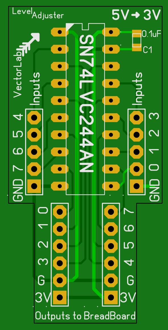

The beauty of Sprint is that if you need to do something like this... you just draw it.
So 20 minutes... call it done.
Tinine
Joined: 30/03/2016
Posts: 1646
Posted: 06:44pm 29 Sep 2022
Very professional

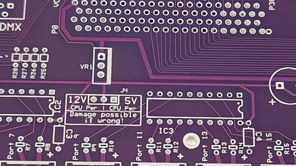

Meanwhile, elsewhere, "Production board just arrived":
Whatever it is, I ain't buying one
@pwillard
You have a white silkscreen but how'd you get the black border?
Clearly there're lots of little SL6 tricks that I'm unaware of.
Craig
Posts: 9029
Posted: 09:08pm 29 Sep 2022
The "border" is a cutting line on layer O. The top silkscreen is on layer S1.
I normally have layer O yellow, but you can set colours.
Posts: 10009
Posted: 12:37am 30 Sep 2022
  Tinine said  Meanwhile, elsewhere, "Production board just arrived":
Quite.
I guess it will work fine electrically, but I always like to make my boards look neat and tidy.  There is no electrical reason to do so, and if time is absolutely of the essence, then OK, but if you have the time, I always like to make the boards neat with equal track spacing and 45-degree track angles etc, to give the board some sense of dress.
That's just me though.
Tinine
Joined: 30/03/2016
Posts: 1646
Posted: 05:31am 30 Sep 2022
I have zero tolerance for sh*te craftsmanship. Takes the same amount of time to do a neat job.
