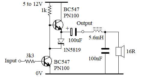

Posts: 3430
Posted: 01:11am 30 Nov 2022
"Volhout's filter makes is of no consequence to me. I expect that what you hear when using the switching transistor is the audio harmonics in the signal filtered out by the frequency response of the device and your ears."
That is also my experience.
This morning I have tested this Class-D push-pull amp. It gives more volume than a single transistor.
The output filter makes no audible difference, though the scope shows it greatly reduces the 44kHz at the speaker.
Transistor types, resistor and capacitor values are not critical.
It just increases the amplitude of the 44kHz modulated square wave.
These days most cheap audio stuff uses class-D.

Posts: 9329
Posted: 07:54am 30 Nov 2022
If it's a piezo or a passive magnetic type then an H bridge is ideal. If it's an active type then you can't use an H bridge.
If Tom's device is actually a 16R magnetic type then it's a normal magnetic speaker so polarity is unimportant.

Posts: 6254
Posted: 02:16pm 30 Nov 2022
@cosmic frog, @mixtel90,
Can you please check if PAM8403 works ?
The PAM8403 changes a (small) analog signal into PWM (class D) and feeds it to the speaker.
In picomite case there is no analog signal, there is a PWM signal (44kHz). If I feed that unfiltered to a PAM8403 you PWM modulate a PWM signal.
That may very well not work at all.
If you need to convert the picomite PWM signal to analog (the filter with inductor, or the 1 transistor active filter), then attenuate it, then feed it to the PAM8403,  you might as well connect the loudspeaker directly to the filter/buffer.
Maybe Phill's solution is the best and simplest. Use the PWM at GP0/GP1 and use it to drive the speaker directly (via a 100uF capacitor), and it is tested !!!
