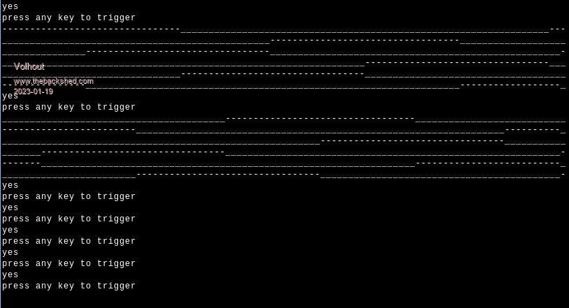

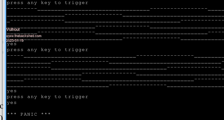

Posted: 06:59pm 18 Jan 2023
@Peter,
When I use the normal DMA RX (no ring buffer) in below program, every keypress samples a new set of data from the GP0-5 pins.
But after some 6 or 7 times, the program exits with a panic.
I have tried forcing the DMA to a stop, and the message is DMA not running.
So the DMA has stopped, but MMBasic has problems.
Is this a memory leak ?
' Test signal: Three phase motor drive - picomite V50706+
' runs autonomously on GP0...GP5 50Hz
 SetPin gp0,pwm  'CH 0a
 SetPin gp1,pwm  'CH 0b
 SetPin gp2,pwm  'CH 1a
 SetPin gp3,pwm  'CH 1b
 SetPin gp4,pwm  'CH 2a
 SetPin gp5,pwm  'CH 2b
 PWM 0, 50, 33.33, -66.66, 1, 1
 PWM 1, 50, 33.33, -66.66, 1, 1
 PWM 2, 50, 33.33, -66.66, 1, 1
 PWM sync 0, 100/3, 200/3
 Pause 20
'----------------------------------- LA code PIO --------------------------
'PIO code to sample GP0..GP6 for logic analyzer
 PIO clear 1
'in this program the PIO reads GP0..GP5 brute force
'and pushes data into FIFO. The clock speed determines the
'sampling rate. There are 2 instructions per cycle
'taking 10000/2 / 50 = 100 samples per cycle.
'the PIO program
'address    code    mnemonics         comment
'  0      2016       WAIT GP22=0        wait for trigger to become low
'  1      2096      WAIT GP22=1       wait for trigger to become high
'.wrap target
'  2      4006      IN pins 6       read 6 pins
'  3      8020      PUSH block        and push
'.wrap
'program pio1
 PIO program line 1,0,&h2016
 PIO program line 1,1,&h2096
 PIO program line 1,2,&h4006
 PIO program line 1,3,&h8020
'configuration
 f=1e4   'PIO run at 10kHz
 p=Pio(pinctrl 0,0,0,gp0,,,)       'IN base = GP0
 e=Pio(execctrl gp22,2,3)          'wrap 3 to 2, gp22 is conditional JMP pin
 s=Pio(shiftctrl 0,0,0,0,0,0)      'shift in through LSB, out is not used
'write the configuration, running 10kHz (data in FIFO 10us after rising edge GP0)
 PIO init machine 1,0,f,p,e,s,0     'start address = 0
'---------------------------- LA code MMBasic ----------------------------------
'prepare trigger signal set to idle
 setpin gp22,dout
 pin(gp22)=0
'do not start PIO, the DMA will do that.
 Dim a$(1)=("_","-")
 length%=64
 Dim data%(2*length%-1)        'array to put the 32 bit samples
 Dim packed%(length%-1)        'DMA array to pack 32 bit samples in 64 bit integers
'  PIO DMA_IN 1,0,2*length%,packed%(),ReadyInt
'let the machine run, and wait for trigger
 do
   print "press any key to trigger"
do:loop while inkey$=""
   print "yes"
   pulse gp22,1
   pause 200
 loop
End
'-----------------------------------SUBS MMBasic --------------------------------
Sub ReadyInt
 PIO stop 1,0
 Memory unpack Peek(varaddr packed%()),Peek(varaddr data%()),2*length%,32
 For j=0 To 5
   mask%=2^j
   For i=0 To 2*length%-1
     Print a$(((data%(i) And mask%)=mask%));
   Next i
   Print
 Next j
 'PIO DMA_IN OFF
end sub
Edited 2023-01-19 05:01 by Volhout

Posts: 6136
Posted: 08:02am 19 Jan 2023
  matherp said  See if this improves things.I assume you are developing on VGA?
PicoMiteVGA (2).zip
Hi Peter,
This is improved.
The ***PANIC*** message is gone. But the code simply refuses to do a DMA after a few tries. (-or- the DMA's do not complete).
I am developing on the standard picomite. Since I try to bring maximum functionality to the VGA version, I need to use all available IO pins on the VGA version. That leaves me with no IO pins for debug. So I develop on the normal pico, and keep VGA in mind. On my standard pico, I have SDcard connected to the VGA pins (GP16...GP21), to get a group of 16 successive IO pins free (GP0...GP15) for PIO debugging.
Currently I work with 2 arrays. One packed array, and one data array. The packed array is resulting of the DMA action. The data array is where the display, data analysis, zooming etc.. will happen on. Until the moment that we can use a small data array and intelligen "unpacking" from the packed array (unpack small sections, like with a magnifier glass) the packed array is just eating up memory. At the moment I jave the data array (100%) and the packed array (size 50%) eating 150% variable space.
This could be overcome by adding the "64" size to the DMA (currently 1,4,8,16,32). In that case storage in the "packed" array would be wasting 32 bits per sample, but the data would be in integer format. No need for a "packed" array anymore.. Or am I dreaming..?
Edited 2023-01-19 18:04 by Volhout
Posts: 11914
Posted: 09:39am 19 Jan 2023
OK, I think I've found it. You need to re-initialise the state machine after each run. The DMA call just enables it which runs from wherever the program counter happens to be. In the attached I've modified the PACK and UNPACK commands to match the manual
PicoMite.zip
Here is your code with the mod to make it reliable (call init in the interrupt routine)
'.wrap target
'.wrap
'program pio1
'configuration
SetPin gp22,dout
Pin(gp22)=0
Dim a$(1)=("_","-")
length%=64
  Print "press any key to trigger"
Do :Loop While Inkey$=""
  Print "yes"
  Pulse gp22,1
  Pause 200
End
Sub ReadyInt
PIO stop 1,0
Memory unpack packed%(),data%(),2*length%,32
For j=0 To 5
  mask%=2^j
  Next i
  Print
Next j
'PIO DMA_IN OFF
End Sub

Posts: 6136
Posted: 10:10am 19 Jan 2023
Yes, there seems to be a relation with timing. See snip:
 Pause Rnd*200+200
If I remove the PAUSE, the PIO could potentially put one value in the FIFO before the DMA is ready. After few (6 or 7) triggers the codes tarts putting out "." (done%=0).
If I change the pause to PAUSE 20 (1 whole cycle of 50Hz), the DMA should be ready, but after 6 or 7 triggers I get:
Error: Invalid address - resetting
So you are right, there is a critical timing somewhere. Could this be because you have put the priority of the DMA too high (conflict with USB ?).
Posts: 11914
Posted: 10:16am 19 Jan 2023
Just completely changed my post - see above

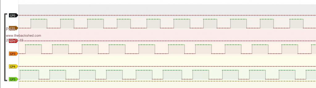

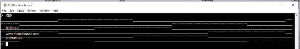

Posted: 11:31am 19 Jan 2023
Peter & Volhout, you are doing a great job!
I am following with great interest. I made some speed testing and in my opinion it looks very promising.
option list
PicoMite MMBasic Version 5.07.07b5
OPTION SYSTEM I2C GP16,GP17
OPTION FLASH SIZE 4194304
OPTION CPUSPEED (KHz) 378000
OPTION DISPLAY 50, 150
With PWM frequency set to 40MHz and PIO frequency set to 378MHz the program still works. Although the PWM output looks quite miserable.
option list
OPTION LCDPANEL SSD1306I2C32, LANDSCAPE
________________________________________________________________________________________________________________________________
__--__--__--__--__--__--__--__--__--__--__--__--__--__--__--__--__--__--__--__--__--__--__--__--__--__--__--__--__--__--__--__--
-__--__--__--__--__--__--__--__--__--__--__--__--__--__--__--__--__--__--__--__--__--__--__--__--__--__--__--__--__--__--__--__-
Very similar outlook by the logic analyzer. A few of the traces are just lines.
'PIO DMA_IN OFF
End Sub
PIO frequency can then be adjusted "on line" via GUI while the program is running. A possible route for adjustment of sampling speed for Zoom-in and Zoom-out?
Posts: 6136
Posted: 12:43pm 19 Jan 2023
Thanks,
Now it works...
Thanks you for helping out...
