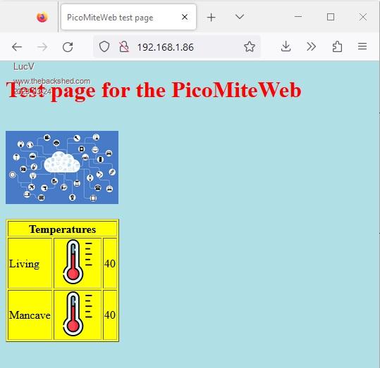

In this chapter we are going to enhance the webpage more.
First thing is to add a table to the page so we can put some order to our data.
Next step is to give the table a header so we know what it's about.
Then the chapter shows how to give the table a different color as the standard webpage background
Then comes the fun part.
The previous chapter shows how to put a graphic on your webpage.
This chapter shows how to put significant graphics in the table so your data really looks nice.
Here is how the webpage will look:
And here is the chapter that puts it all together:

When you start the server09.bas program the first thing it does is to show you the IP address the PicoMiteWeb automatically got assigned from the router.
In my case that looks like this:
Your IP address is : 192.168.1.86
Now the only thing you have to do is to point your browser to this address.
And with browser I mean any browser on your PC/Tablet or Phone. And on any device be it PC/Mac/Android or Idevice.
Each device has a browser and all browsers support HTML because every webpage you visit is just plain HTML code.
