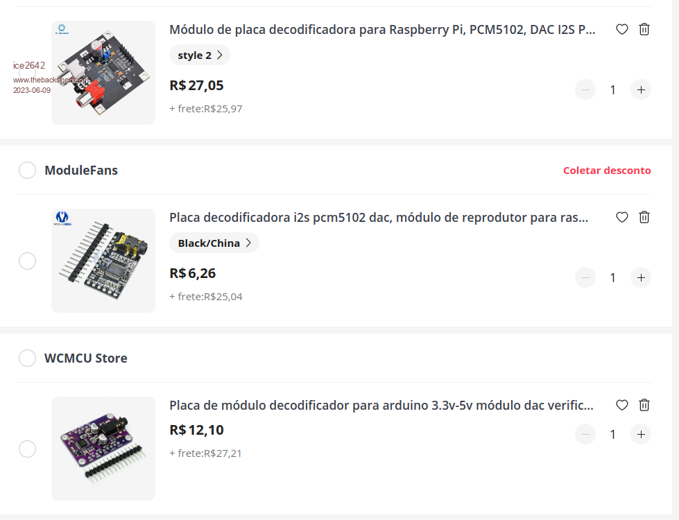

Can you sugest a good DAC for use with PicoMite in Aliexpress?
I am looking this models in the attached image.
PCM5102 the first 2 and UDA1334a

The PicoMite supports the MCP4822 DAC chip (and other members of that family). I got some through-hole ones from AliExpress.

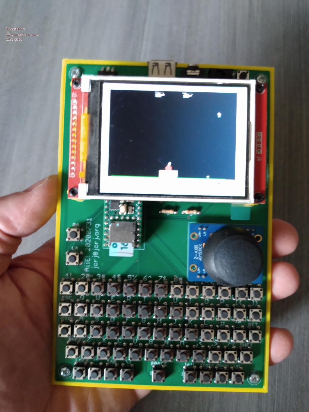

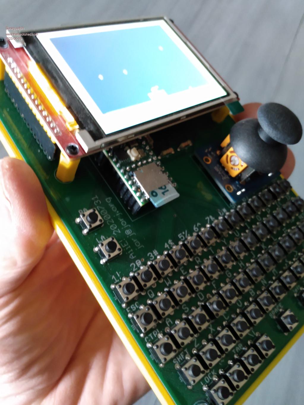

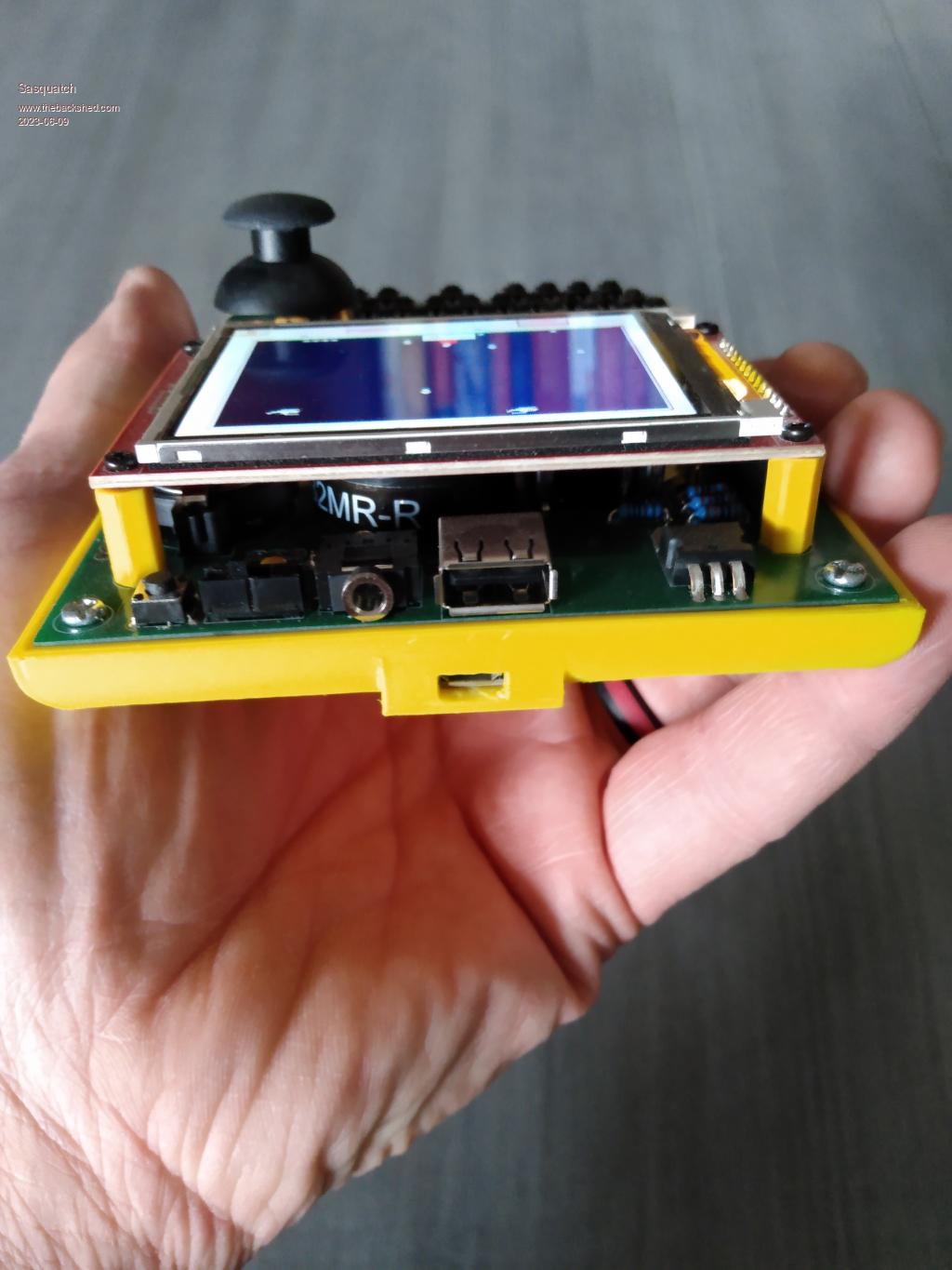

Thwill said:
  Quote  uncased this is never going to be a particularly robust device
I have started 3D printing "Trays" for my "Uncased" PCB's  The "trays" cover the back of the PCB and prevent shorting out the solder joints.  The "trays" also give some stability when sitting on the bench or table.
Here are some photos of a tray I printed for a similar project.  The project is an Apple//e emulator using a Teensy 4.1 (on GitHub as Aiie by JorjBauer.)  The main PCB is screwed firmly to the tray and the tray encloses the LiPo battery and charging/boost module.  You can also see the custom printed standoffs supporting the LCD module (in this case the LCD is only supported by pin-headers on one side.)  I used lower profile machine pin headers for the Teensy module and raised the LCD headers slightly to allow clearance under the LCD module.  You can see the micro USB charge port on the top edge of the tray.  This tray has rounded edges and fits nicely in the hand.  I considered adding a top to the tray kind of clam-shell style but I think leaving it open gives the project a nice retro look.
-Carl

Wow! I like the mini key board! You guys

  Sasquatch said  The project is an Apple//e emulator using a Teensy 4.1 (on GitHub as Aiie by JorjBauer.)
How do you (effectively) play Sabotage without a paddle?
I've ported it to the CMM2, steerable shells and all. Works very well - with a potentiometer providing an analog input. I re-wired a standard Apple paddle with a 4 conductor cable. Retro...

  vegipete said  How do you (effectively) play Sabotage without a paddle?
The large knob is actually an analog joystick so it works quite well for left/right control.  As you may be aware the joystick for apple][ was actually wired the same as two paddles for X and Y.  Sabotage is playable on apple][ keyboard (using "D" and "F" for left/right) although not nearly as nice as a paddle or joystick!
Sabotage might be a good candidate for the PicoGAME LCD using the gamepad controls or a potentiometer as a paddle.
Sabotage was one of the iconic games I remember from the '80s I was wondering who would recognize it. I'd love to play Sabotage on my CMM2, did you ever upload it to the forum?  Let's start a new thread for Sabotage if you want to discuss further!
Edited 2023-06-09 07:58 by Sasquatch
-Carl

That's the same sort of joystick I've been playing with. :)

Hi Carl,
  Sasquatch said  I have started 3D printing "Trays" for my "Uncased" PCB's  The "trays" cover the back of the PCB and prevent shorting out the solder joints.  The "trays" also give some stability when sitting on the bench or table.
Very, very nice.
Whilst not as pretty I've found the Bintendo's two PCB sandwich provides similar stability and a level of protection against shorting. The Bintendo suprisingly has reasonable weight and ergonomics, especially for the minimal effort it requires (I've made a deliberate decision to have nothing to do with 3D printing or CNC at least until I retire; there aren't enough hours in the day as it is.)
The final hardware will be licensed under CC BY 4.0 so perhaps someone else might choose to take it further, I know @bigmik has some ideas about squeezing this all into the existing enclosure from one of those cheap Chinese "NES on a chip" handhelds.
