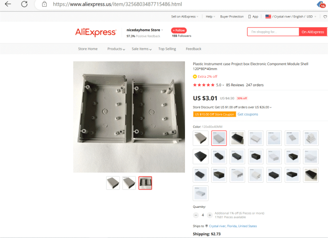

Here's a box, 120mm x 80mm x 40mm, which comes with removable end panels. PCBs of the size of those panels with the cutouts for the desired connectors could be produced.
The boxes only cost $3.70 U.S. each with shipping if 4 are bought (I don't know if or at what point shipping costs would begin to rise). You could get both end panels off of a single JLCPCB design, so the end panels for 5 boxes would be about $6.40USD with shipping, giving a total cost of about $5 per box.
The top would still need a cutout for an LCD--ILI9341 or ILI9488. With care that could be made with a jig and a side-cutting bit on a drill press. Long pin female headers could stand the LCD off the PCB through the top.

If you are thinking of boxes then I would suggest that you ignore all but Hammond. They have been around a long time, make excellent boxes, have worldwide distribution (not at the whim of a small Chinese company who are buying in unknown stock from another unknown Chinese company) and produce very good drawings for all their boxes. I know there's a cost issue, but if you want a system that's repeatable, possibly over several years and in different countries, then there aren't a lot of options. I wouldn't risk ebay, AliExpress etc. unless you are buying in all you will ever need in one batch. I've been bitten before.
The only others that I can think of are the "adaptable boxes" produced by electrical companies as terminal boxes. They are pretty much standardised on sizes now and are used in huge quantities but are generally "industrial ugly" and nowhere near as nice to use as the Hammond cases.

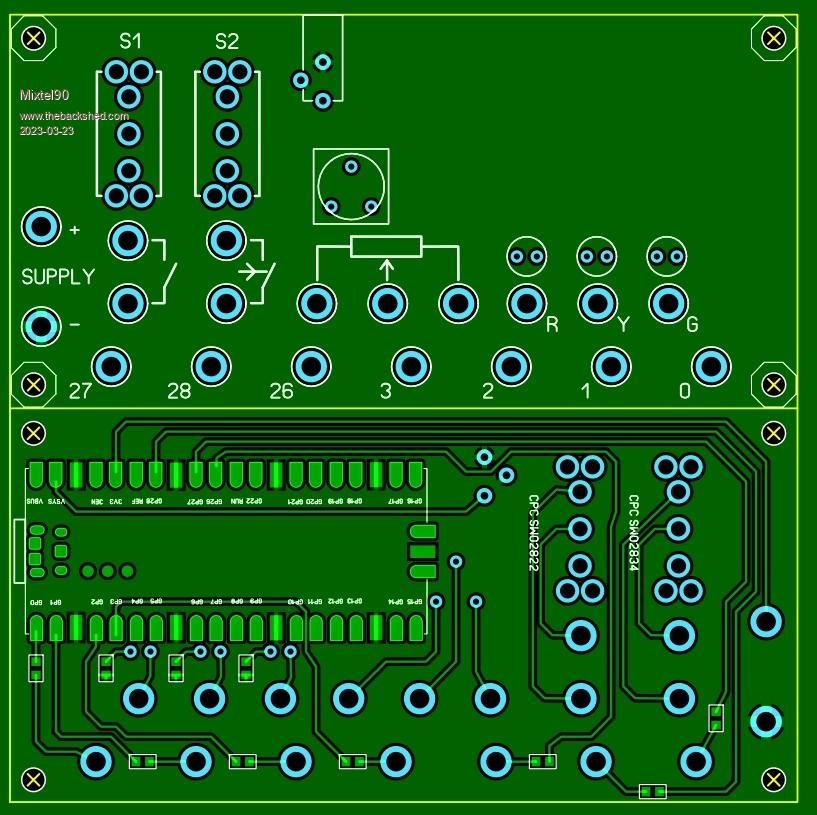

I'm coming round to thinking the top should be single-sided PCB (copper on the bottom). Maybe just decorative copper on top. Components mounted through it and soldered in position, as are those 2mm sockets I mentioned. Short leads with 2mm plugs on each end link switches, LEDs etc. to, say, eight GP pins from the PicoMite. This board has a downward-facing female header.
Next layer is double-sided PCB. PicoMite is on this layer, now this could be surface mounted as it would be stronger and reduce costs. If it's plugged in then it needs tie-wraps or screws to secure it - it also takes longer to assemble. If a potentiometer or rotary encoder is used it would probably have to be mounted here, with the shaft poking up through a hole. This board has an upward-facing male header and is mechanically connected to the top using threaded 9mm f/f pillars and screws.
Bottom layer is just perspex. It is fastened to the middle layer using 5 or 6mm m/f pillars and screws. Four stick-on plastic feet complete it.
This design has no side protection, but the 9mm gap could be reduced to 5/6mm if the PicoMite is surface mounted. That might mess with some horizontal connectors though.
I suppose an optional layer could be added, holding a battery and charger/protection circuitry.
Rather than just connect spare pins to a socket somewhere I'd be happier if we could use as many as possible, only connecting out, say, I2C, 3V3 and GND. Relatively simple expansion modules are then possible without bulky connectors (but needing a bit of software support) - something like the connector used for landline phones would be fine.

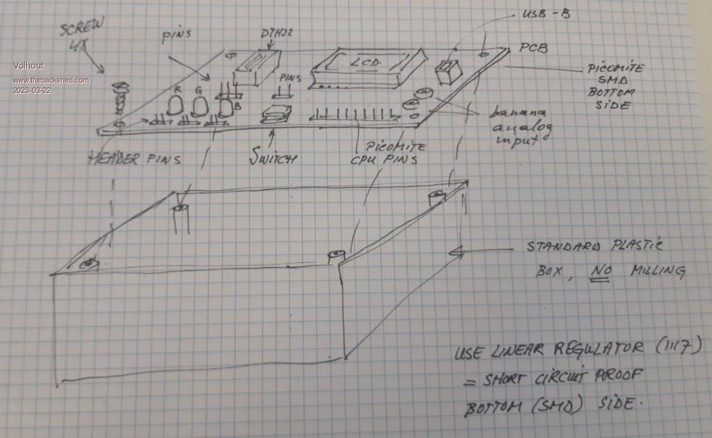

Had only few minutes, so this is my way of looking at it.
All pins on top side (accessible) are ESD protected with series resistance and diodes. Power is from linear regulator (inherently short circuit protected) banana plugs give access to ADC via resitor network, so you can measure +- 10V
LCD is fixed wired to picomite. No access.
DTH22 is accessible.
LED's and switches are accessible.
The PCB acts as lid on the box. No milling, just 4 screws to put together.
Linear regulator and picomite are SMD mounted on the bottom, so not accessible.
Edited 2023-03-22 22:55 by Volhout
Posts: 4366
Posted: 01:38pm 22 Mar 2023
I think N is "she" :)
But of course er, they, should decide overall.

Posts: 9030
Posted: 07:35pm 22 Mar 2023
Right, this is only something to start with. I know it's incomplete, but I wanted to see what it would look like and how awkward the track would be likely to get. I've shown the front and the back of the board. it's shown as 50mm x 100mm but as you can see, space is restricted. This is about as cheap as it's possible to go, single PCB stood on short spacers. The pot is a square trimmer with a built-in knob. The switches are Multicomp from CPC and I left off the power switch, SD card and sensors. Putting stuff on top of a surface mounted PicoMite isn't good so it may have to be plug-in. That's awkward when you don't want to have the pins poking through.
