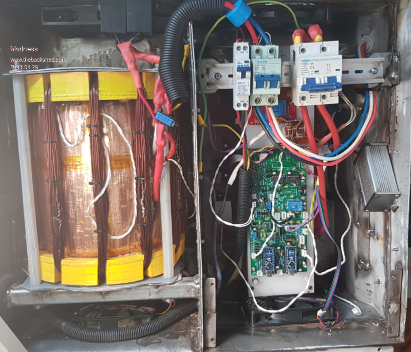

I have hit a brick wall and my head hurts!
Yesterday I removed one choke from this new big inverter thinking that perhaps I have too much choke. After that, it ran fine with the 2XSINE code (as was when I had 2 chokes) so I connected the inverter to the house very late in the afternoon and ran it overnight without an issue. But as the sun came up and the 3 GTIs started producing power glitches started appearing in the sine-wave and they would disconnect and reconnect and as their output increased it become worse. So I switched the off-grid inverter off and thought about what to do next.
Next step I put one of my EG8010 controller boards in the inverter and tried that. The bloody thing was playing up just the same as with the Nanverter controller! Should have tried that earlier, anyway I now now there is something not quite right in either the power board, choke or the toroid. Without connecting a GTI it runs fine so I am scratching my head ATM.
The 2 controller boards, Nanoverter and EG8010 ran fine on the small test inverter and I get the same issue with either in the big inverter so I am fairly confident there is not a problem with them. Fortunately, I have plenty of everything to swap bits around to isolate what is wrong. I know the small test inverter ran really well with the Nanoverter 2XSINE so I also am fairly confident that it will be fine in the big inverter once I get it sorted out. It has me mystified as to why it runs so well until the GTIs start working a bit.

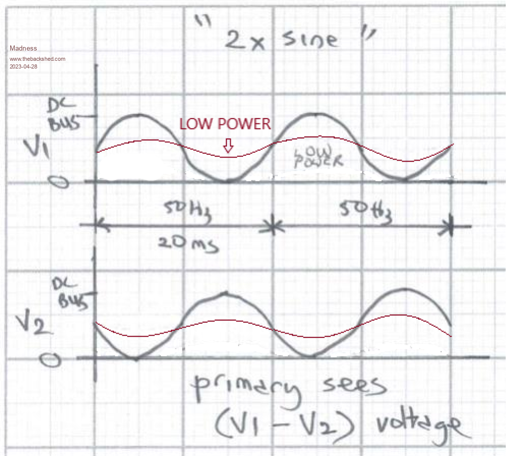

  poida said  Madness:
just a detail on the 2x Sine modulation that needs to be cleared up.
In the above diagram I show incorrect "low power" voltage traces.
The incorrect trace has them close to zero DC volts.
The CORRECT trace should have the voltages close to 1/2 DC supply volts
with the small amplitude 50Hz deviating from that mid point location.
It results in the same voltage difference (V1 - V2)
With zero modulation amplitude, that is, at the start of the soft start
or the end of the soft stop, both V1 and V2 will be 1/2 DC Volts.
I just wanted to correct that error now, since it looks like
more interest in the 2x Sine modulation is happening.
I have corrected the sketch here.

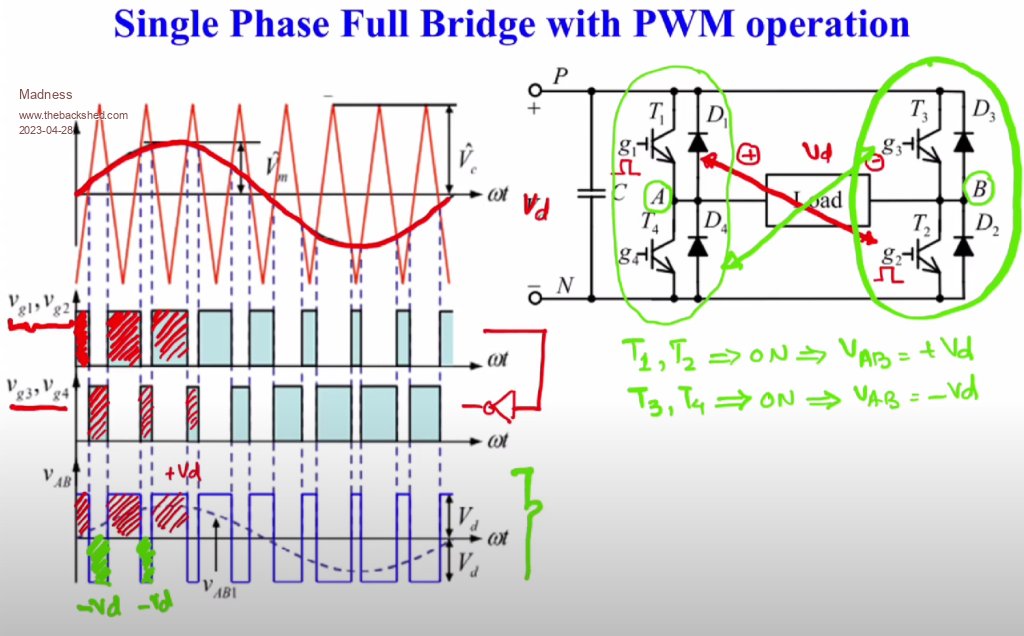

I believe this is produced by this Bipolar modulation. From this video
analog8484
It's actually unipolar modulation.  Different PWM modulation can certainly affect the inverter behavior but it can't stop backeed charging from AC coupled GTI's.  GTI's are current sources that will push the island grid voltage as high as it needs to pump as much power as possible (limited by PV/sunlight).  So, the backfeed current will charge the batteries through the body diodes in the inverter MOSFET's when the voltage gets high enough even if the MOSFET's are turned off.
I took a quick look at the nanoverter code (2xsine) and it appears to have a pretty slow control loop with pretty high PID gain.  It appears to assume fairly stable and linear loads which is not really valid for AC coupled systems.  In AC coupled systems, island grid voltage can jump 10's volts mid cycle (e.g. large load turn off's) and some GTI's can continuously inject periodic and non-linear power disturbances due to anti-islanding mechanisms.
Your GTI problems could be due to transient voltage instability caused by the interaction between the voltage rise driven by the GTI's and the inverter control loop response.  Since you are off grid, if your GTI's are IEEE1547/UL1741 compliant and has configurable grid settings then I suggest you disable anti-islanding and set the range for voltage and frequency to as wide as possible, and set the trip time for out of range voltage and frequency to the max allowed (default is typically 160ms).  You may also need to tune the PID gain parameters.
The video in the link also shows unipolar modulation, but the screenshot I posted is what they call Bipolar. I am just going off what they say, if anyone has more information on the subject I would be interested to see it.
Edited 2023-04-29 06:42 by Madness

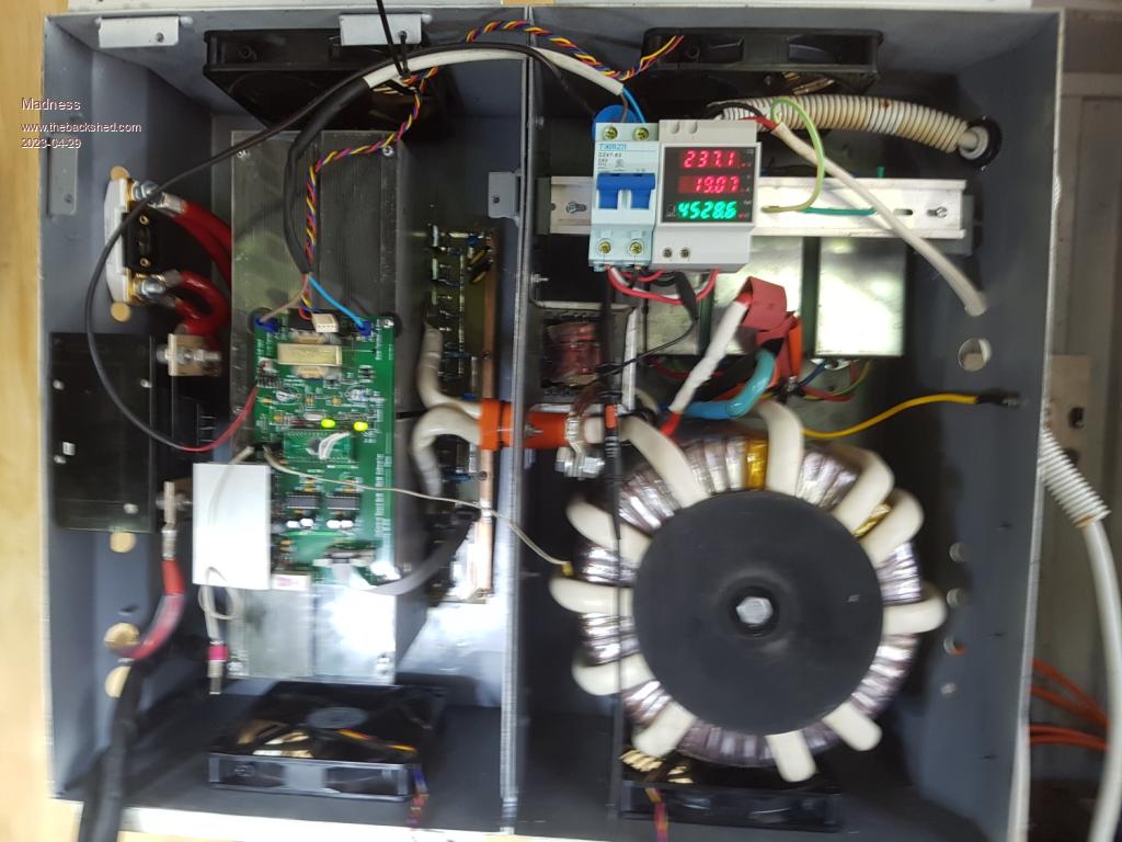

  analog8484 said
  Madness said
Now the house is being powered by the EG8010 which has been powering the house for the last 7 years. The GTI's connect to it happily and run all day without a single disconnect or complaint of any kind.
I am just catching up on this interesting thread.  Is this the OGI system that has been AC coupled to 3x5kW GTI's for 7 years?  If so, can you share the general specs of the EG8010 OGI (# fets or kW) including the battery system (type and kWH) ?  Also, what is actual max backfeed/excess power from the GTI's that you have seen?  I am curious because the general rule for reliable AC coupling is 1:1 ratio between the OGI and GTI rated power capacity and the continuous backfeed charging current must not exceed 0.5C of the battery system.
The OGI is my modified version of the Ozinverter which includes the 24 fet power board that I designed and is mentioned many times on this site. It has a toroid that I rewound from 2 3KW Aerosharp GTI toroids, battery is a 48V 37.5KWH FLA forklift battery. I have seen 120A current to the battery from the OGI, it is now regulated to 80A maximum. The back feeding ratio has never been an issue, I can be using 500W while 80 plus amps are going to the battery and it is 100% stable. There have never been any disconnections etc except with this new inverter which has now been found to be faulty.
This is the OGI I have been using for the last 7 years. The photo was taken ‎Wednesday, ‎23 ‎November ‎2016 so not quite 7 years.
This is the new OGI that I am working on. Same power board, 3 core torroid and Nanoverter control card.
