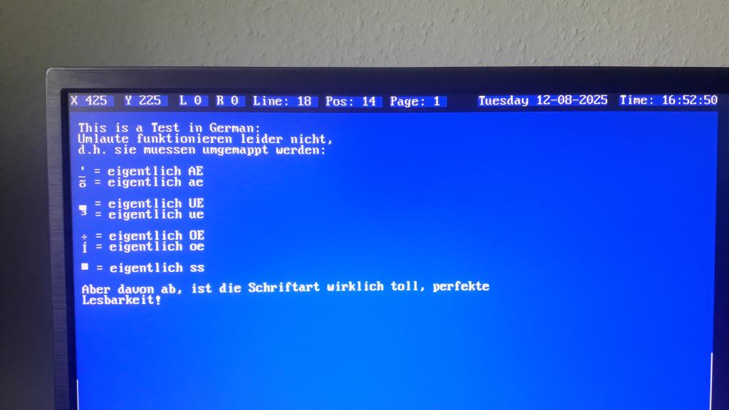

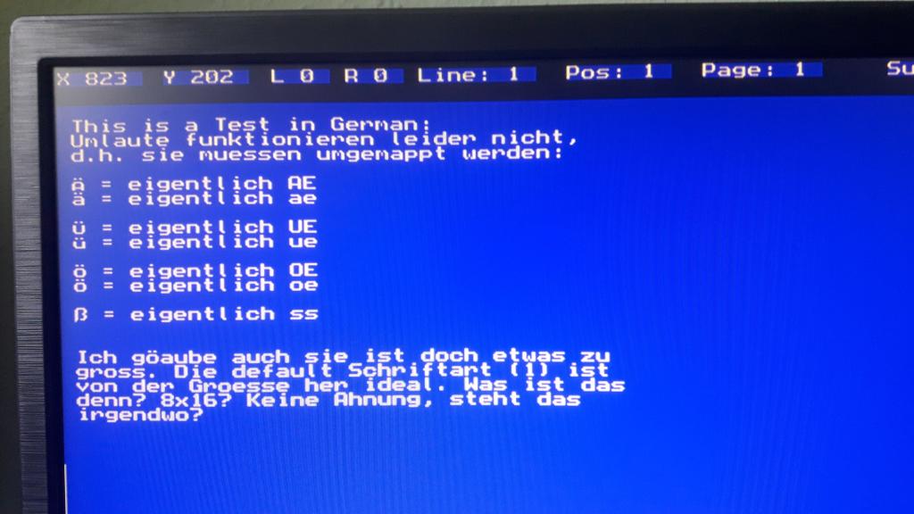

I didn't expect, that you do all the work!! But I tested the new font and there are some problems:
At first: the Umlaute have to be re-mapped. In general this isn't a problem at all, BUT: for re-mapping I am using the PS/2 keyboard "catch" commands via MM.Info(PS2) and therefore it is possible to re-map it of course, but I plan to make things also available fpr the USB variants and then I ALSO have to re-map the Umlaute again, and I don't even have a clue if there I can catch the USB keystrokes like with the PS/2 version. If this is also possible with USB, it is fine, just more re-mapping. I just wanted to explain why I prefer the "Amiga Font", there are all Umlaute on their right ASCII places.

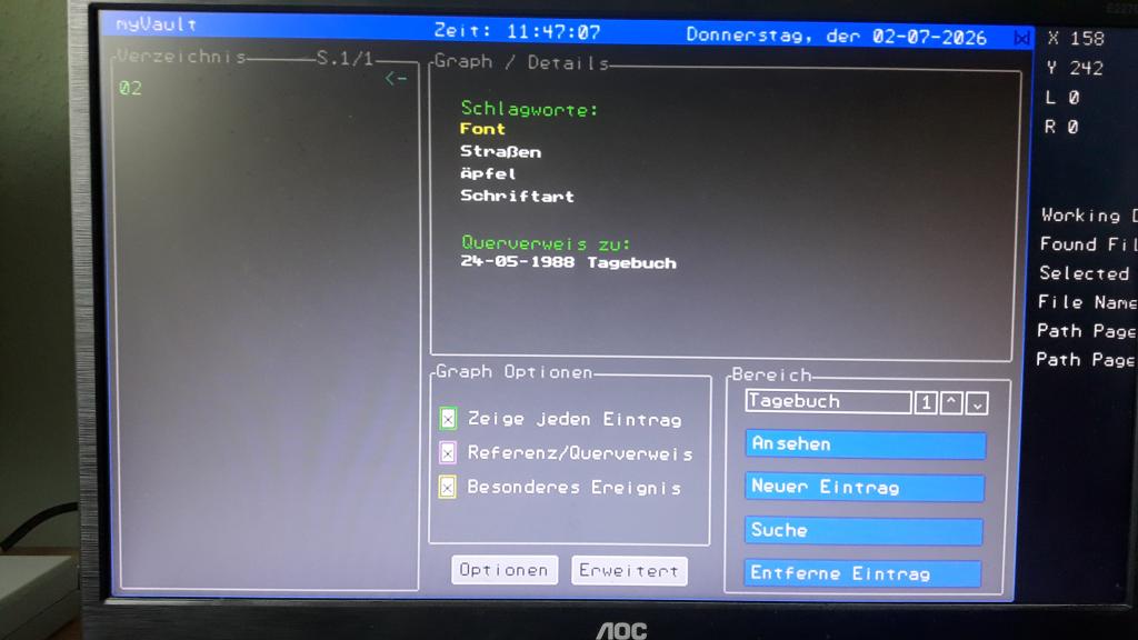

If you (or anybody from the german members) are interested, I attached an early version of my text-editor with both fonts integrated already (your new and the amiga font) including the example text. As you can see, on the Amiga font, everything works "out of the box", same text on the "new codepage font" didn't work so well. I also think it is too big, as it seems. I think the sweet spot is Font 1 of the PicoMite, does anybody know what size it is?! I thought it is 16x16, but as it turns out it isn't.
Images:
Your new Codepage Font:
The well proven Amiga Font:
And both programs you see in the picture with included font and example text:
schriftart_text_editor.zip
Since this is a english forum, of course I isn't friendly to write german without translating the text, you can see on the pictures:
In a nutshell I have just written what I wrote here on english: "I think the font is too big and I still have to re-map the characters for their respective ASCII codes"

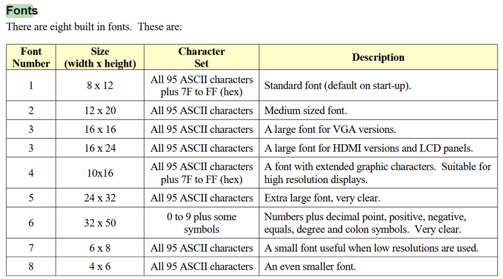

oh this is awkward! This seems to be from the manual, right? I must have missed, that there is written what Size each font has
I think the best font of all is still FONT 1, (8 x 12). It is the "sweet-spot" between high and low resolution and slightly bigger than the Amiga-Font.
When it comes to your Codepage font - I really have almost no special requirements - except that all ÜüÄäÖöß should be on their correct places when it comes to ASCII values. This prevents re-mapping. Of course this means the Font MUST be a full-size 224 char Font like your Amiga font. It is called " font_Classic
' Font type    : Full (224 Characters)" - just looked it up
I am well aware that this eats memory space - but as said, If one would pack it in the flash library, there isn't a problem.
The font itself should be well readable, maybe an old Windows / (Dos?) font like your codepage font would be ideal - in fact I love that DOS look! About all the other "special" characters, I have no requirements, so you could fill them with the ones you like. As said, only the Umlaute should be an their correct places.
Greetings
Daniel

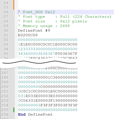

Hallo Daniel,
Here we have a font based on the DOS-VGA characterset with umlauts and 8x12 pixel, i.e. the same size as font 1.
Font_DOS8x12.zip
hope it fits like this
Martin

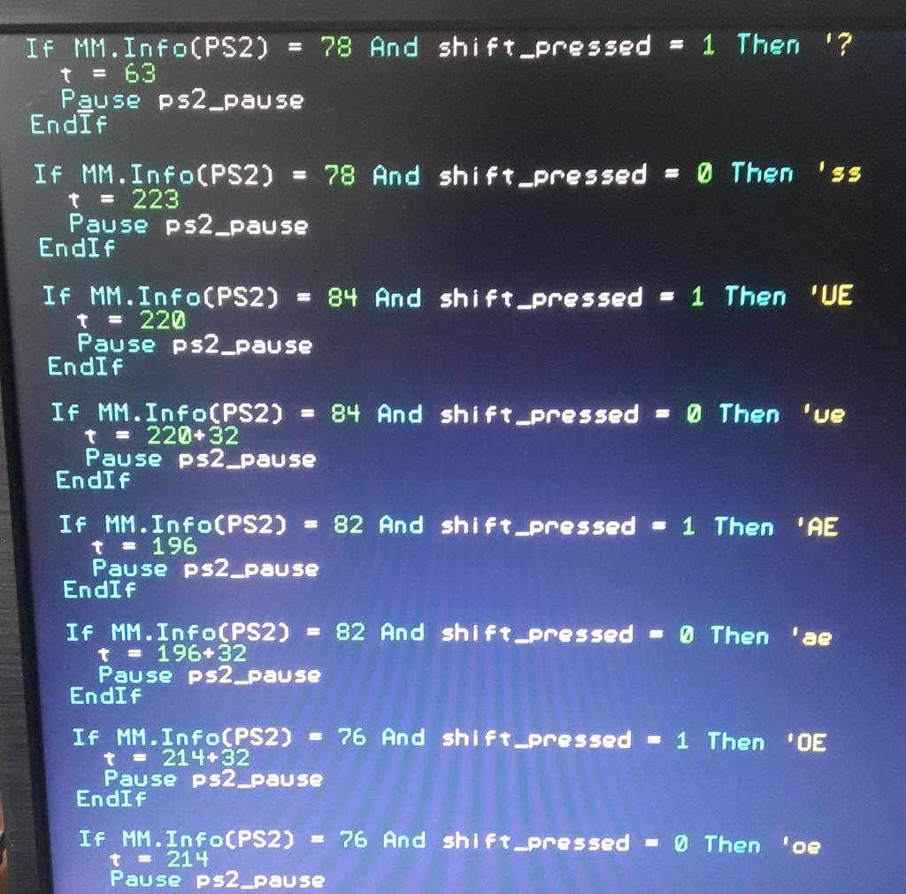

For my PS/2 programs it is no problem with re-mapping, but I looked in the manual and thought I found the equivalent of MM.INFO(PS2) = MM.INFO(USB) but it is not! This only gives the device number... I have no clue if re-mapping USB-keyboard inputs is possible at all, so I can "catch" the usb-code before the (re-mapped) Font character is printed. Peter ?? Anyone??
Is THIS possible with USB variants? :
If this is also possible with USB variants, no problem.

Here is a quick, unconventional possible solution.
If you look at the font data in a text editor (e.g. Notepad++), you will notice that each letter is stored in its own line.
If you now fill the lines above with blank lines until the first character line is at 32, each letter is next to its character code.
By simply exchanging the lines, you can place the umlauts on the character code where you need them.
Give it a try
 Martin
