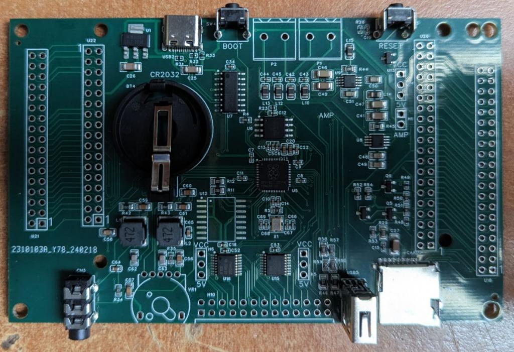

The PCBs have arrived and electrically they work perfectly
Physically they are poor to rubbish
The concept is a single board computer with ultra-fast graphics
It supports any of the standard 16-bit parallel TFT displays and includes the usual RTC and audio (including stereo amp).
To keep costs down I left most of the non-surface mount off the build by JLC hence the missing bits on the board.
The physical issues are:
Upright USB socket means that the display has to be spaced off the board using a stacked socket
USB connector and volume control too close to the 26-pin expansion connector
Speaker connectors too close for individual sockets and not spaced correctly for a 4-pin socket

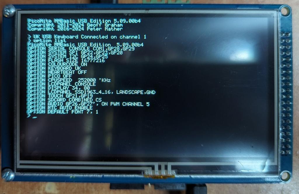

Loading the MMBasic firmware is a bit idiosyncratic. Obviously it uses the PcoMiteUSB firmware variant but doesn't use the standard serial console pins so the process is as follows:
Flash the firmware via the USB-A port
Connect a keyboard
Enter the following commands blind: OPTION PICO OFF, OPTION SERIAL CONSOLE GP28,GP29
Then you can connect to a comuter and finish configuring or continue with the keyboard as per the instructions on the back of the PCB
I've re-done the physical layout of the PCB to fix the issue and will post the designs on the PicoMiteUSB github page soon. Cost for 5 boards fully built as pictured £115.

I have been wondering,  what are the pink lines and dots I see on many of your 3D renders?
Posts: 3412
Posted: 12:23am 01 Mar 2024
They look like orientation markers for the Pick-n-Place robot. The dots are all near pin 1 of the chips.
