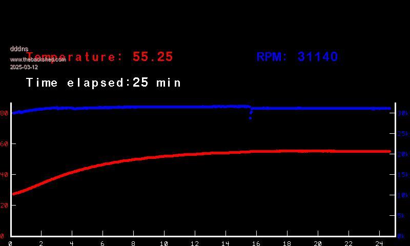

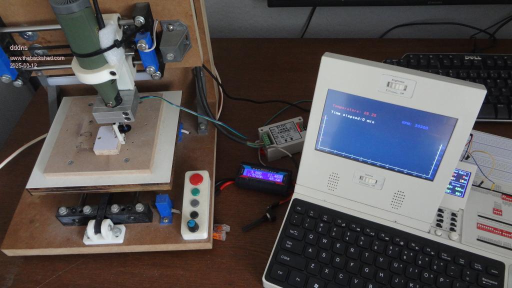

Posted: 06:38pm 11 Mar 2025
My Proxxon and me have something in common, we both are broke..
I took a Chinese 2700 Kv outrunner used for drones and a BDLC controller I bought a year ago. I always wanted to check out these kind of motors, now it is time to ;)
I took a piece of aluminum and an old heat sink.
And I designed roughly a lid.
Here is the story how to pimp a Proxxon to 32.000RpM :))
I will test it..might get to hot but the original 20.000RpM it will surely do:
Edited 2025-03-12 04:41 by dddns

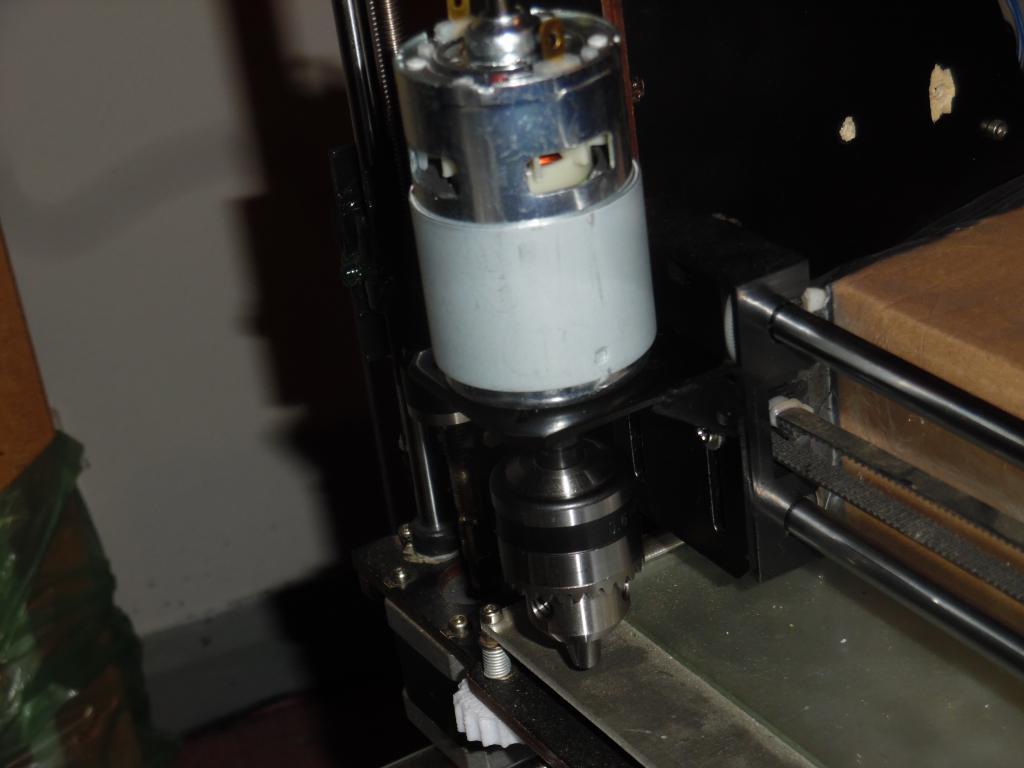

Posts: 2807
Posted: 08:19pm 11 Mar 2025
Thanks for the info @dddns sir. the anet a8 is not going to take much resistance, it's poor design. I may try it for pcb and use existing 3d print software with 1 layer.
my other 3d a8 is acrylic and much better like the x axis is 2 bars horizontal not on top of the other and the extruder mount is metal not plastic and cable wraps but that's why I want to keep it.
I stepped back and thought what do I need it for if only pcb whereas 3d printer lot of fun.. stuff off thingiverse.
this would be better for a router but good as is as printer, cheap..
Edited 2025-03-12 06:44 by stanleyella
Posts: 2807
Posted: 09:32pm 11 Mar 2025
The motor is the one recommended by Mick earlier, £12 but can get for £10 free postage. the mounting bracket is steel. it would be more solid on the other printer without any bracket as it's metal but holes need drilling to mount motor.
lots of people done this but some say the motors don't last, bearings as not meant for lateral stress. others say dremel best others say no.
dddns
Joined: 20/09/2024
Posts: 925
Posted: 09:45pm 11 Mar 2025
I am honest and my opinion is, that this motor is not suited for milling and neither the clutch. The motor can't stand axial forces because of the brass barring and the clutch no radial forces because its made for drilling.
But some million turns the motor will do and maybe the clutch is just fine and runs concentric..
Look at the last picture of the proxxon above: the tiny (high speed/high precision/industrial-grade) ball barring at the tip holds both forces. the motor mounted above just needs to be 100% in line and concentric with the spindle axis. In this type of construction your motor would work as well.
But the Chinese took the shortcut and directly welded a clutch to the motor itself..
Edited 2025-03-12 08:11 by dddns
dddns
Joined: 20/09/2024
Posts: 925
Posted: 12:33pm 12 Mar 2025
It does better than I dared to hope. The test environment was a light barrier for measuring RpM and a 18b20 temperature sensor and of cause PicoMite.
After a runtime of around 18min at 31.000 RpM the temperature rise stopped and kept being further on at 55,5°C. That is more than satisfying as it can run permanently at 32.000!
Posts: 2807
Posted: 02:06pm 12 Mar 2025
@dddns. I agree about the £10 motor/chuck- "a drill" not a "dremel" which is meant for hand use and grinding and using lateral force.
The 3d printer with the spindle motor has too much "play" if the bit met resistance, imho.
