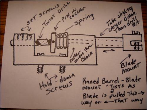

I machined the main body, the blade-end flange and hub (with set screw), the alternator-end flange and hub (with set screw), loaded the stator with sixteen 1/4" neo-magnets spaced evenly around the perimeter and "temporarily" affixed it to the windmill's shaft for testing before permanently locking it down.
In short, it's starting to look like something. Pictures will be taken and posted this week sometime, I suppose. With the pick-up coil(s) set with a 1/32" air gap, there's slight cogging, but I don't think it'll be enough to pose a start-up problem. .
If it does (pose a start-up problem), I'll build up three of those spring-loaded pitch-changer things I discussed away back in the day and put one on each outboard blade tip, one per blade. Each of these (if necessary) will default to a 45-degree pitch (when stopped) and feather to the blade's "running" pitch at speed. They will provide a 2-inch section of blade set at maximum pitch on the outboard side of each blade to take advantage of leverage for start-up.
Peter thinks it'll shake apart, because the individual spring tensions will not pull at the same speed or timing. I don't think it'll matter, since they deploy as speed decreases. Then again, Peter might be right, I dunno! All we can do is hide and watch, eh?

Posted: 08:11am 02 Feb 2010
You grabbed my attention with your pitch control.
Could You post a drawing or photo of that...
or point me to the posting where You discussed that.
I don't think it'll shake apart.
If the timing is a little out of sync, the blade with
the coarsest pitch will be a momentary aerodynamic
break and put no more stress on the prop than
the ever present turbulence and directional shifts you
have in winds close to ground level
(= "ground roll" & extends to ~ 500 feet a.g.l.)
If you allow me to play "devil's advocate" with
your idea...I don't think it will shake apart,
but might constantly modulate up and down.
...unless you have springs with the exactly right
"D" constant.(force/travel)
Of course I have to guess here how your pitch control
works..and I can only assume it is rpm sensitive
sensing centrifugal force?
As the wind speeds up, you generate more power
and if you use it, it will therefore lower your prop speed.
A spring which acts against the centrifugal actuator
if not exactly right will now begin to set your
pitch a little coarser....lowering your prop speed
even more....
This means of course you crank out less power and
in turn lowers the torque load on your prop...
With a lesser load the prop will speed up again
and the way your pitch control works this "up cycling"
will be aggravated by now adjusting the pitch to
"fine"
So unless the spring tension or compression is
exactly right your rpm might cycle up and down
even though the wind speed remained constant.
And the only way your pitch control does
not cycle up and down at a given constant wind
speed
is when you draw no power from your mill.
Its a problem with any servo control system unless
you have tuned just the right output response amplitude
to a given input signal...otherwise the damn thing
oscillates up and down
...or goes on-off-on-off..."telegraphing"
...instead of on----staying till set limit---then off.
But like I said, I am only playing the devil's advocate.

First off: Your 4m posting is "truncating" and looks like a poem. I use a Mac and mine used to do that too. Glen (Gizmo) fixed it somehow. You might want to PM him and ask him what's up.
My pitch control is a bit "off the wall" in that it uses three different springs and therein lies the rub. A 4m member, Dinges (Peter) pointed out early in the game and noted it would cause each blade to feather independently.
Blade-feathering systems that actually work use some kind of gear to link each blade so they all work together. Mine doesn't work that way and therefore, I decided to use it on the wing tips to affect start-up problems from cogging. As the blade slows, the tip pitch deepens, increasing the torque.
Basically what I concocted is a drill bit trapped in a housing with a barrel riding loosely around its outside. The barrel has a pin, which resides inside the slot on the twist drill and is backed up by a spring. As centrifugal force increases with blade spin, the weight of the moveable portion of the blade pulls (against the spring's force) it outward and the pin in the groove follows the pathway (twisted) and turns the blade. Easy; maybe too easy!
I drew a picture way back when and if I can find it, I'll post it here.

Okay, I couldn't find the picture I drew a while back, so I scribbled up another one:
Once again: a twist drill is locked in place in one end using two set screws, held in a hole it drilled, by the way! A collar drilled one size larger than the twist drill slides over the twist drill and through the other end of the block.
Whatever diameter you make the collar, just jump up to the next-size drill bit (use a chart and don't guess!) and drill a hole for the collar to rotate within. A set screw or pin is threaded through the thickest portion of the collar and that pin rides inside one flute of the twist drill.
The blade is locked into the outboard portion of the collar. As the windmill turns, centrifugal force pulls the collar against the spring, which attempts to keep it inboard. As it pulls either direction, the pin follows the twisted groove (flute) of the drill and the collar-and-blade combination twist that amount.
To make it work in a true "feathering" manner, all three blades would have to be synchronized using gears, so each one turned the same amount as any other, otherwise, one blade will have more pitch than the other two, throwing things out of balance. I don't have any need for it to feather, but if I ever do, I'll design a synchronous system and post it here. I need this to default to 45-degrees as I am interested only in torque at this time.
Edit: If you are interested in a full-feathering arrangement using this method to actuate it, let me know and I'll work it out. I had the privelege of meeting and talking to "Mr. Jacobs" of Jacobs Wind Electric back in the early 1970's and he allowed me to fiddle with one of his rigs. I paid close attention to his feathering device and I think I can approximate it from memory using the twist-drill as a motion inducer. Just let me know.
