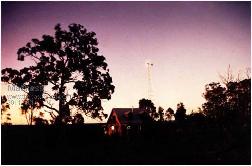

This thread brings back some memories, I had a 1500 watt Dunlite. Only problem was the rollers in the end of the forks in the governor system kept flogging out due to turbulence. Even though it was up an 80 foot tower it was hit with an updraft through the trees. In the photo the trees to right where the problem the big one on the left was well below the generator.
The photo was taken with 15 second exposure about 30 minutes after sunset.

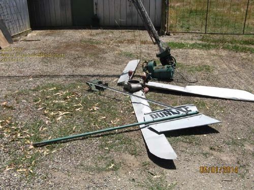

Sadly my Dunlite model L is no more, snapped a guy wire today and the whole lot came crashing down! Damage is pretty catastrophic, about the only thing that survived unscathed was one blade and the dynamo itself. I have no desire to try to source parts and repair it so the remains are available to anybody who can use them, the sooner I don't have to see it anymore the better.... Don.
Please note that you would have to pick it up from Geelong.
