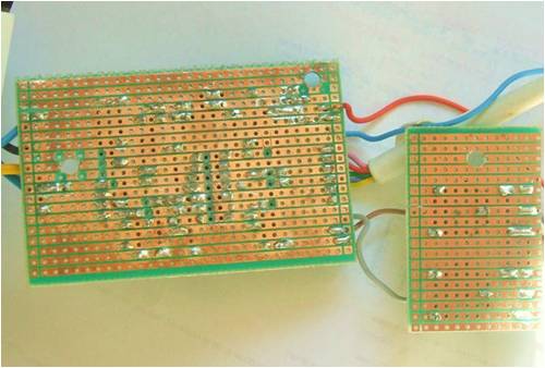

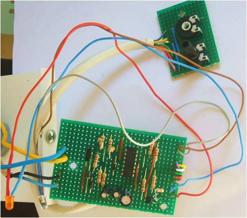

Here are the photos at last.
I have changed the resistors as suggested but no difference. The relay still trips out when the voltage is changed not when the low volt pot is altered. I have reached my limit of knowledge. Is there anyone prepared to make me one? I will obviously pay costs, postage etc. It is now becoming quite urgent. Help would be greatly appreciated.

Here they are, I think!!

Posted: 08:07pm 10 Jul 2010
I cant see what the purple and pink wire is connected to from the trimpots on the main board.
Looks like you have cut the track but not connected any thing to them.
Pete.Edited by Downwind 2010-07-12

The 2 outside wires are from the outside terminals of the pots. They were soldered on before I realised they weren't needed. I presume the pots are OK. I miss ordered. In this part of the world I have to buy from Britain or America. There are places here but it is still cheaper to buy from abroad. The only other thing I can think of is that the op-amp was shorted and is soldered directly to the board. Could this have been damaged? The large yellow and blue wires go to the relay, the finer blue and black are the power.
As far as manufacture, all I need is the board. I have a box for it.
Shelly aka Brian

Posted: 08:43pm 10 Jul 2010
Working through the pin voltages you posted last i am troubled with pin1 as the voltage dont change so you might have a solder brige on pin 1 or a damaged chip.
Retest the voltage on pin 1 as you adjust the voltage it should switch from about 1.5 volt to about 7 volts........there is a problem there.

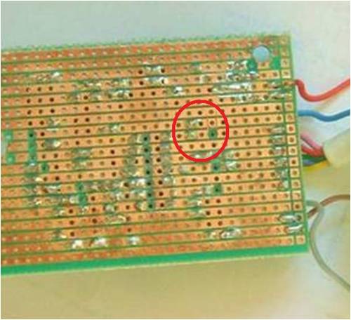

Joined: 09/09/2009
Posts: 2333
Posted: 08:56pm 10 Jul 2010
I think you might find a copper bur next to the jumper off pin1 where you cut the track.
Your problem lies around pin 1 look very carefully you will find a bridge or short there some where.

Posted: 09:23pm 10 Jul 2010
OK one by one!!
The pots are 10k and will switch the power on and off so I presume they are Ok
There are no solder bridges anywhere. I have scored between the strips with both a steel dental pick and a broken hacksaw blade and finally brushed it down with an old toothbrush.
I think the op-amp is damaged and will replace it and use a "plug" this time so it's not soldered.
As can be gathered, electronics is not my hobby, model railways is. The circuit diagram for the desulfator is Ok? If it is I'd like to make one to see how effective it is and I can order all the bits in one go to save on postage. I'm also looking for a circuit or kit or ready made to switch a 230v ac on and off. It's for a small pump of 40 watts that circulates water around a couple of small ponds. I want to prevent the ponds being pumped dry in case there is a leak. Not renewable energy but I'm sure a use could be found for something like this, for example protecting a water heating system.

Posted: 02:01am 11 Jul 2010
I see what looks like the same copper bur next to the jumper off pin1 that Pete dose.
Also I like the idea of using a socket for the op amp; it helps to keep heat and static of the chip during assembly as well as easy replace should the magic smoke get out. Install the chip last.

Posted: 08:25pm 12 Jul 2010
Thanks for all the help. Since the photos were taken I have cleaned the track several times. I am sure there are no bridges. When I have an order worth sending I'll get a new op amp plus socket. Whilst this is not a hobby I do find it interesting if not a little frustrating!
