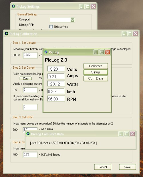

Posted: 08:39am 15 Aug 2010
I've been porting the PicLog code to Just BASIC. Most of the code has been rewritten from scratch, JB doesn't support a lot of the commands I was using in VB, so I've had to write a few functions to get what I want. JB handles string and numeric variables much better than VB, but is lacking when it comes to date functions. JB will only let you have one timer function running at once, where VB will let you have many ( PicLog 1.5 uses 4, depending on what version you have ), so I've set it to 1 second intervals and use counters to keep track of timing for different events.
At this stage the serial communications, setup and calibrations screens, remote and local logging is working. I'm yet to start on the graphing section, and I might write this as a separate application to keep it simple.

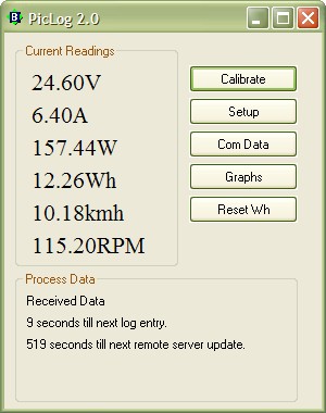

Posted: 01:18am 19 Aug 2010
The PicLog version 2 is coming together nicely.
I've added a reset Wh button. Clicking this will open a small window to let you reset the watt hours to any number you want, 0 by default. The new PicLog will also remember the Wh figure if you accidentially close/crash the PicLog program. When the program is started, it looks for log files for that day, and if it finds one, the last Wh entry becomes the new Wh reading instead of 0.
Just BASIC communicates with the Windows API very well for a simple language. One problem I heard about with the old PicLog is lack of support of com port numbers over 8, a limitation of VB6. Just BASIC will support any com port number, my running copy of PicLog 2 is currently using com port 20.

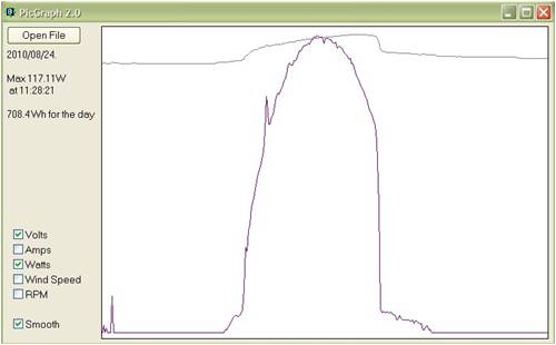

Posted: 11:37pm 27 Aug 2010
How did you go AMACK?
The PicLog version 2 is getting closer to release. Pete(Downwind) is helping out with the testing too, I wanted to make sure the new PicLog would work with his power logger circuit boards. So far the new version seams rock solid compared to the old PicLog, mines been going for days without a single error.
I've started on the graphing program. It will run as a separate program to the PicLog, and this is how I think we should develope the PicLog in future, as separate modules/programmes. The PicLog program connects to the hardware and logs the data, a separate program called PicGraph will display the data. Later I'll write another module to display the live data as analogue screens, like Windman did with his PicLog. All the individual programs can be running at the same time.
This is a screen shot of PicGraph, as you can see, early days. You'll notice the Smoothing option, this cleans up the display if your logging at a high speed.

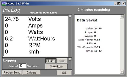

Glen, I have been able to get V1.3 to work and am still having truble getting it to send to the web. Can you give me any direction to how to set it up to send. I can not seem to find the extra screen to config the logger to send to the web.
This is the screen I need to find.

Posted: 02:07am 30 Aug 2010
Hi AMACK
Version 1.5 has the extra screen and code to send data to the remote server. You can download it here...
http://www.thebackshed.com/windmill/forum1/uploads/Gizmo/201 0-07-20_230235_PicLog_Ver_1-5b-beta.zip
Extract the download and copy the PicLog.exe file into your existing PicLog directory, run the program, and go into the Program Setup screen to enter your remote id and pin number.

AMACK
Joined: 31/05/2009
Posts: 184
Posted: 10:27pm 30 Aug 2010
I GOT IT WORKING
I AM NOW ABLE TO SEND DATA TO THE SITE..

Posted: 10:23am 02 Sep 2010
Hi AMACK
Yeah in the next PicLog the watt hours are saved with the log files. When you start the program, it looks for log files for that day, and if it finds it, grabs the last watt hour reading and starts from there. You can also edit the watt hours value manually. I've added a button called Reset Wh, and it opens this window, where you can leave it as 0 or enter any value, and the watt hours will increment from there.
The Wh is reset at midnight by default also, but you can turn this off so it just keeps incrementing until you reset it manually.
