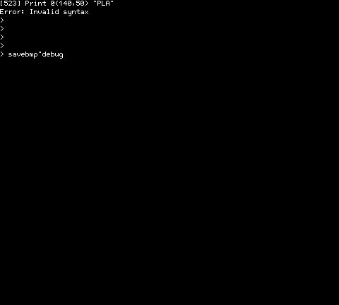

Here is the screen I get when I RUN it...
Now, I could fix it but it would be nice if we could upload *working* programs for the public to see. Edited by Nick 2012-01-15

Nick,
By the error it looks to me that you havn't installed the latest release 3.0A of mmbasic that added the 'print @' command.

Hi ,
This version is for MM Basic v3.0A.
The 'syntax error' can only be the Print @(...) command who
wasn't present in older version.
I will always use the latest version and tell it in the reply
when i post a new one.

Geez! There's a new version already?! I only updated to 3.0 last week.
Ok, I've updated firmware to 3.0A and run the program. No more error but I'm now back to being unable to start and play because this latest version of Invaders still uses the non-standard switches for it's control.
I'm back to where I was when I started. Is there a problem with writing the program to use the keyboard. Everyone has one of these right?
