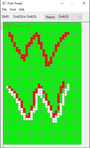

Posted: 09:15pm 04 Mar 2016
This update lets you load/create fonts with any width (within reason).
The only requirement is that the width x height is a multiple of 8.
This change needed a major redo of some critical areas so I need test reports.
I have also made the file reading a bit more forgiving with the file formats.
If you come accross ant files that don't read correctly, please send me a copy and I will investigate.
It should now prompt you to save any changes before loading a new file.
The ZIP includes the 12x20 font that is built in to MMBasic as a BAS file.

Posts: 3002
Posted: 12:41am 05 Mar 2016
Thanks Jim for this 'updated' version. I am busy this weekend but will test ASAP and report back . . .
One thing that is a request from me - just something for you to think about whether it is easy or not.
If x = y (and only if x=y), can you include (enable?) a 'Rotate' button that rotates the current design on view by 90degrees. Only need to rotate one way; as three 'spins' would be the same as an 'opposite' single rotation.
I believe this feature could prove useful to others too!
WW

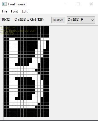

paceman
Joined: 07/10/2011
Posts: 1329
Posted: 03:46am 10 Mar 2016
Hi Jim,
On my XP system I can't get this latest version (with Flip etc.) to open the 6x8 Nokia font that MatherP converted as below.

It seems to start opening it (with File/Open) but then goes off into la la land and doesn't respond - the character select box stays blued out.
The 12x20 font you included in the zip file opens OK and all the characters are available - what am I doing wrong?
Greg
Edit: the font file above works OK with Peter's new Nokia driver.Edited by paceman 2016-03-11
Posts: 6641
Posted: 10:33am 10 Mar 2016
Bugger....
I had tested that font.
Put one or more blank lines or comment lines at the start of the file and all will be OK
I will fix it in the next release.
paceman
Joined: 07/10/2011
Posts: 1329
Posted: 04:38pm 10 Mar 2016
Yep, that fixed it, many thanks - I've got a much nicer looking "@" now.

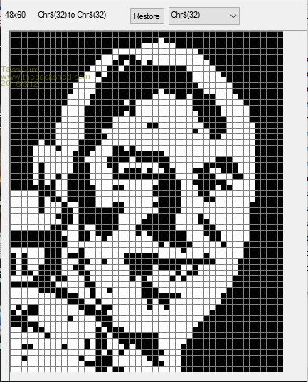

Posts: 6641
Posted: 08:03pm 11 Mar 2016
Working on the next step:
The image is of a 48 x 60 character but the font below is 64 x 80
cls
text mm.hres/2, mm.vres/2, " ",CM,8,1
end
' Font type : Special (1 character)
' Font size : 64x80 pixels
' Memory usage : 644 bytes

Trying to get a decent black and white from a photo can be challenging and takes a bit of tweaking.

The image to font code is not in yet.

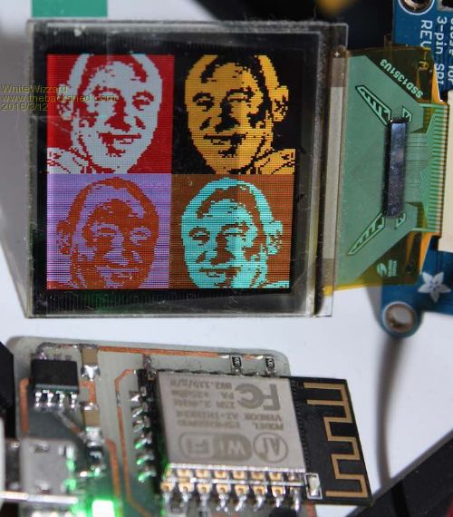

Posts: 3002
Posted: 10:28pm 11 Mar 2016
Someone had to do this . . . . . . .
Move over Andy Warhol !!!
paceman
Joined: 07/10/2011
Posts: 1329
Posted: 02:48am 12 Mar 2016
We want Marilyn! We want Marilyn!
Jim - getting better and better; move over Apple art! The auto file select is very handy too - I was about to suggest the OPEN default be changed to .BAS but you're way ahead. Great stuff.
