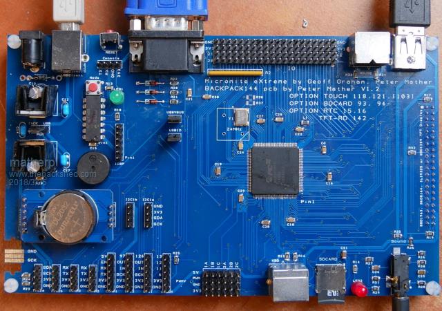

  matherp said   Graeme (OA47) has just had some boards made up to the MX144 V1.2 gerbers in the previous post and kindly sent me one. I moved the parts across from my original prototype and have fully tested the new layout. I'm happy to report that the V1.2 gerbers have no known errors in either the wiring or the silkscreening.
Note in the picture R37 and R38 are not installed. When using the through-hole 5V oscillator these make a potential divider on the output to reduce the signal to 3.3V for the PIC . I'm using the optional SMD 3.3V oscillator so these are not needed.
Links USBVBUS and USBID are made enabling a USB keyboard to be connected (Top right)
Hi Peter
Appreciate you producing MMX-144 v1.2 PCB's & having them made available.
What would be the changes over v1.1 - is there a change-spec doc or a back-of-serviette-list available anywhere ?
Or is it as "easy" as comparing the schematics and/or the gerbers ?
Ken
Posts: 11937
Posted: 09:56am 03 Sep 2018
  Quote  What would be the changes over v1.1
V1.1 has a through hole oscillator that is really only specced for 5V running at 3.3V. V1.2 has either a 3.3V SMD oscillator or a 5V through hole version operating properly at 5V with a voltage divider on the output driving the MZ
