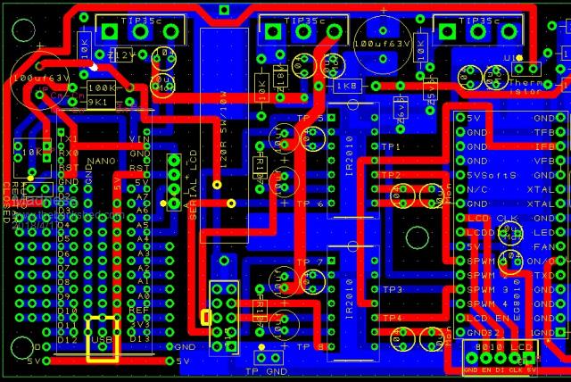

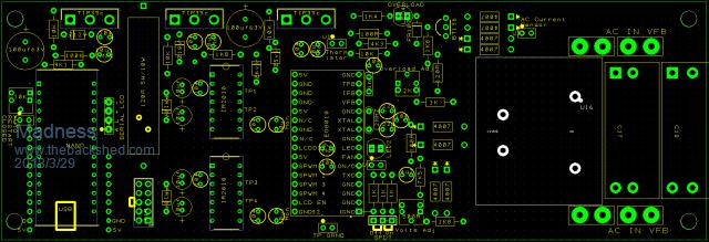

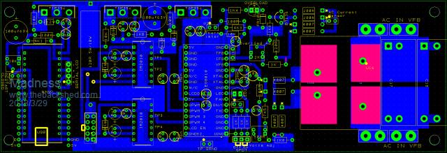

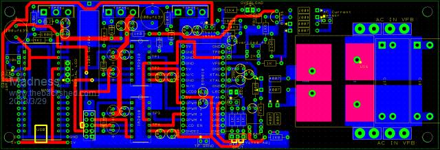

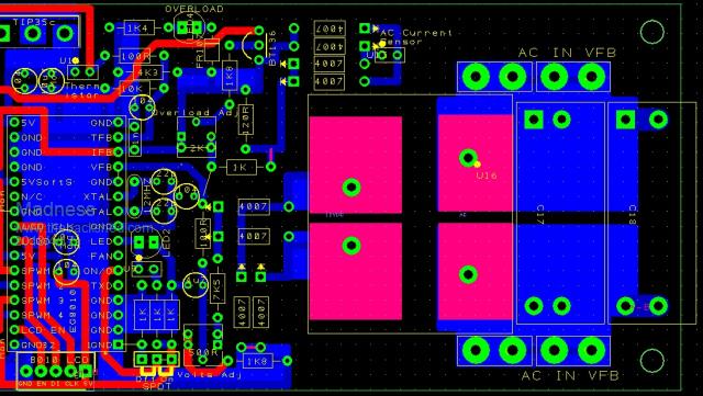

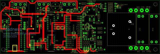

I have completed the new version of the control board and have done a preliminary check but would appreciate if anyone out there interested could check these for me also please. The circuit should be identical to Oztules latest version except for the Arduino Nano that I have added to for Low voltage shut down. I have made more use of the top side than Oztules version as he did this originally with the intention of DIY single sided PCBs.
Edited by Madness 2018-03-30
Madness
Joined: 08/10/2011
Posts: 2498
Posted: 06:24am 29 Mar 2018
I have made PDFs but they are still not super clear I can email much better images to anyone who would like them.
2018-03-29_162306_All.pdf 2018-03-29_162334_Bot.pdf 2018-03-29_162403_Top.pdf 2018-03-29_162424_Silk.pdf

Mad, The way I check PCB artwork is drawing the complete schematic (I know you don't like doing that ) and then colour trace each connection as I check it on the board.
With that neat feature of track highlighting of the PCB software you use that task should be easy.
You will find having a neat schematic pays off many times over in the case you have to trace a problem down the track .
Another thing I found useful is putting the project aside a few days before checking it, surprisingly often I had realised that I'd forgotten to include something on the board. Hindsight is quite useful at times.

That sounds a good reason but that person would require the full knowledge of exactly what the board does. And you have introduced new parts with that low voltage sensing, nobody but you would know as yet what this involved.
Now, I do not require any boards but I could not check your artwork without that knowledge. And that means a full schematic for me. Its actually not that difficult to draw one if using one of the free programs. Much easier than laying out the PCB, imo.
Does not take long either once one has worked out the basics of the program.

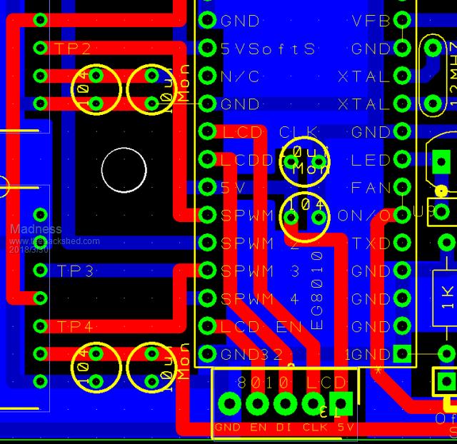

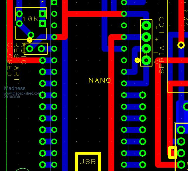

Some comments from the .png pictures:
Are the 2 capacitors under the EGS8010 adapter pcb low profile and will not interfere with the bottom of the adapter pcb?
There seems to be a 4-pin serial LCD interface. If you are using I2C, please check the signal pin numbers of the I2C coming from the nano.
From the pdf, looks like mounting holes are spaced about 2.8" (71mm) and 9.5" (241mm). Maybe add mounting hole in the middle of the 241mm so that the PCB will not flex too much when inserting/removing the adapter pcb.
Too busy at work right now, if I have extra time I will look at them some more later.Edited by tinyt 2018-03-30

Thanks Tiny well spotted the Serial LCD was incorrect.
I have added a hole for support next to the EG8010, also added a connector for the LCD for the EG8010, I know Oz thinks it is pointless but it is there if you want to use it. The 2 Monolithic caps under the EG8010 have plenty of clearance so no problem there.

Posted: 10:37am 17 Apr 2018
Just made some changes to the Nano section of the Inverter Control PCB, re waired the voltage input and adjustment and added a playground for future experiments with the Arduino.

Mark all it needs is another pair of eyes to compare the PCB with Oztules. There is the left-hand side that is new but the rest is the same excluding the LCD connector. Sometimes there can be a mistake but no matter how many times you look at it you don't see it where to someone else it sticks out like dogs balls.
oztules
Joined: 26/07/2007
Posts: 1686
Posted: 09:58pm 19 Apr 2018
If A7 for input, D2 for output to temp, then looks good to go to me.
......oztulesEdited by oztules 2018-04-21
