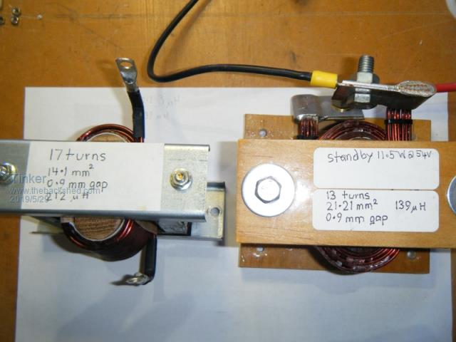

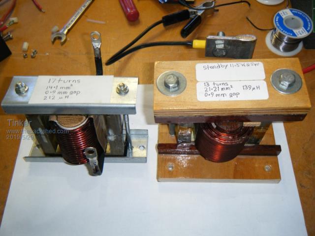

Nice picture, very informative. You are game gluing the cores together, I prefer being able to take it apart since I'm always modifying things .
I will try that dual ferrite core idea, a good excuse to take the ferrite E-core chokes sitting here, doing nothing, apart and turning two into one. This is something I did not think about.
Perhaps the ferrite choke is better with high frequency distortions. My rarely used microwave certainly does funny things to the otherwise neat sine wave.
I did try turns around a large ferrite ring, about 100mm diameter, but that did not work well at all.

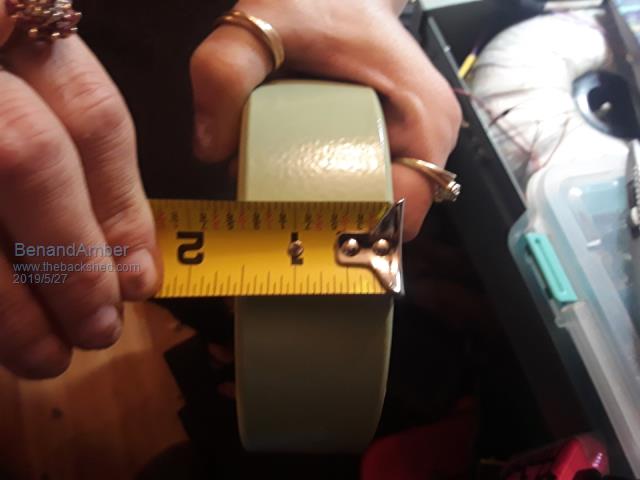

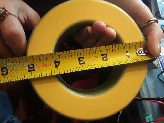

I have this very large ferrite toroid choke in my 10000 watt China inverter board
About 130mm by 40mm
the choke was originally designed for a inverter
It had a lot more turns On It originally then it does now
It took 18 or 19 turns to get the uh two around 50
that was very surprising to me I figured it would only take a few turns
I am really hoping for good results
I was able to use 16 in hand instead of just 10 on the smaller choke I made
From some of the stuff I've read the bigger the better
other stuff I've read people said they haven't worked out
just like was stated above in this post
I have two other chokes ready to go if this one don't work out
Question is if it don't work out does it blow everything or is it just as simple as changing out to a different one

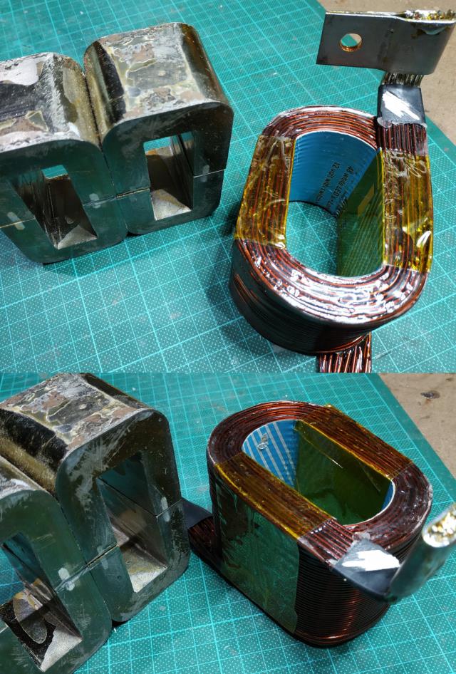

Here's what Klaus means to wind the choke properly with a lathe - 18 turns/45mmsq.
He wound this one for me, thanks Klaus

Andrew, that saturation tester is a must if you want to build chokes like mine. However, a lathe is required to do wind these.
You will find it much harder to wind a tight winding with 3mm wire, I used 1.8mm wire wound two strands simultaneously (5mmsq).
I did try to re configure the existing windings of these chokes with no satisfactory results. I found winding just one coil worked best, to get a bigger core area I use the E-core conversion trick.
To your question above what I wind it on, forget using any soft bobbin material like wood or plastic. The wire will bite into this at the corners and you can't remove the bobbin, even with a big press the epoxied coil collapsed before it came out at my first try.
I now have a metal winding jig, it is pictured somewhere in my inverter building posts. Using that, a layer of thin cardboard is placed on the center bit first and the wire wound onto that. The layers are covered with epoxy which binds the first layer to the cardboard. That and a very slightly conical center bit lets me press it out - from the right side - without doing any harm to the wire .
There is a lot of force on that center bit, think boa constrictor , and the whole winding jig must be very sturdy, including the cheek plates.

Andrew, what I wrote about the inductance of my big E type Aerosharp choke may be wrong, I cannot find the scrap of paper to confirm it and the chokes are in use now.
The A/t figures are correct.
However, I have two different smaller E type core chokes here which I made for my experiments.
You can see the data on the pics below. I measured the inductance with my LC tester, its near enough to calculated figures but not 100% I guess.
You might also see that the available winding space is not fully filled.
The one on the left was wound with the recycled 3mm wire that was on the bigger choke.
That wire is wound two in parallel, one atop the other. There is room for 4 in parallel but it is *extremely* difficult to get subsequent turns to sit right atop the wire under it, with that 3mm wire.
The choke on the left was wound with 1.5mm wire, two wires side by side which is much easier to wind.
Have fun with that 3mm wire, you will find it a challenge .
