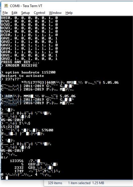

My F4s arrived today--6+ weeks after I ordered them. Flashing went successfully, but as was the case for some others, I got no com port in Win10 when plugging in the USB cable after the BT0 and BT1 jumpers were reset. All went well with a CH340 usb/serial and Teraterm connected to Rx and Tx. (This with two different F4s.) Thanks, Peter--Yay!
But I got weirdness after setting OPTION BAUDRATE 115200 and resetting. Numbers and at least some upper case letters print correctly, but the rest are hieroglyphics.
If I type PRINT DATE$ or PRINT TIME$, all is as it should be, but if I type "print date$", the output is correct but the command is mangled. Is this possibly a Teraterm issue? If not, any idea what is happening?

  Quote  But I got weirdness after setting OPTION BAUDRATE 115200 and resetting.
This is a standard teraterm issue after it sees a junk character (e.g. at the wrong baudrate). Just close teraterm and re-open and set the new baudrate BEFORE sending it anything

  matherp said  This is a standard teraterm issue after it sees a junk character (e.g. at the wrong baudrate). Just close teraterm and re-open and set the new baudrate BEFORE sending it anything
Ah ... OK .. that worked. Thanks.

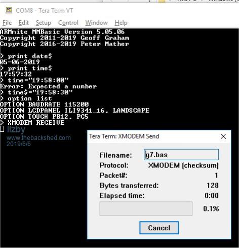

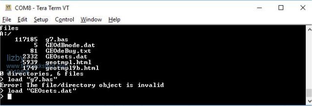

I'm trying to load a file which is 123,356 bytes long (2,998 lines). When I try and xmodem transfer (F11, then in Teraterm, File, Transfer, XMODEM, Send), it freezes without sending anything. Ctrl-C returns the ">" prompt.
If I try copy and paste after F10, it freezes near the end, requiring a reset.
The last hundred line or so are comments. If I copy omitting those and then paste after F10, it goes to completion. SAVE "g7.bas" saves it. I can see it with "FILES".
But if I try to load it, I get an error: "The file/directory object is invalid".
What is happening? (Note--I had the freeze problem on the H7 with F10, copy and paste, but the XMODEM transfer worked--and file LOAD worked.)

  Quote  I'm trying to load a file which is 123,356 bytes long (2,998 lines). When I try and xmodem transfer (F11, then in Teraterm, File, Transfer, XMODEM, Send), it freezes without sending anything.
Try slowing down the serial port and also try the USB connection. The STM32F4 doesn't have a FIFO on the UART so I suspect it is dropping a character whilst processing
