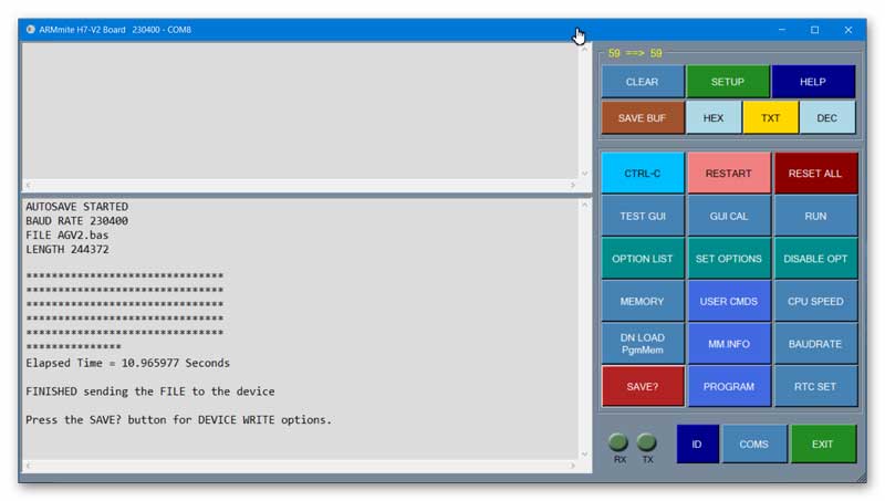

I now detect the Z1 or Z12 boards in my app. I also modified the transfer of a Basic program to device Memory, in this case H712.
Up-loads a 244Kb to the H7 in 10.9 seconds.
Sending the typical small program file is just ridiculously fast, even on an M100+.
BTW: Time to download 244Kb of program memory to the PC is just under 15 seconds.
Posts: 3888
Posted: 02:44pm 17 Nov 2019
What is the above a screen shot of?

Posted: 10:01pm 17 Nov 2019
Hello lizby,
This is a program I wrote to consolidate all the programming apps, an Editor, Terminal, loading firmware, quickly uploading code files and downloading them from memory to the PC, having selectable option lists available for my various MMBasic platforms (M100, ARM and others) and being able to upload the complete option list with one click. Lastly, having common setup options like GUI calibrate, test, reset, RUN etc at the touch of a button.
EG: I use Tera Term as the terminal editor, when launched from my app, Tera Term is automatically set to 132 columns wide, the device port (open in my program) is then handed over to Tera Term and Tera Term opens connected to the device and ready to go.
So swapping between Devices with different ports makes no difference to Tera Term, it's always set the current selected device. Com ports and connection speeds are remembered for around 10 devices by my program. Port speed changes are mostly automatic with my program handling the opening, closing reset and changing and reconnection of the selected baud rate.
A while back I thought I'd share it in case anyone found it useful, however I really think most people have there own way of doing things and are not really interested, but I'll post the link to the current version in any case, it's a ZIP file, just make a directory then copy the ZIP contents into the directory.
Program ZIP
Mike.
