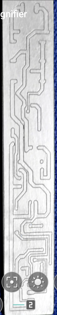

I never really like strip board, only used it for basic stuff. I preferred paperboard with the land around each hole or eurocard style ones laid out for ICs. Then backwire from a net list.

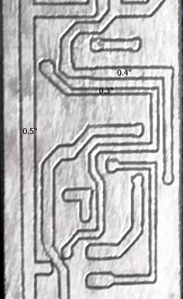

These days, I don't do either (for single sided stuff), I etch a single PCB. Circuit ends up in Eagle anyway, lay-up a board - which I find quite therapeutic. Then save out the track, pads & vias image of the board as a PNG, covert to SVG with Inkscape and cut it onto a bit of black-painted board and etch. The export, convert, cut, etch takes less than an hour and I have a guaranteed working hookup - barring mistakes. I did two yesterday alone. I lay the board up as two-sided, avoiding the top as much as possible and then use that to top-links where I get stuck. Can't do really fine stuff though as my laser etcher is a only cheapie, but it can just about do down to tracks of 32 thou. Prefer 50 thou as a standard which give a very robust board.
Just Curious...
Can you clarify a bit more. I tried black pray-painting (thin layer) copper, and burning it away with a 2.5 watt laser (Eleksmaker 3A), but was not succesfull.
- isolation between copper parts was so narrow, I had a lot of shorts. Especially where the laser started (seemed almost as if it did not completely finalize, skipped a segment).
- due to the narrow isolation, and lack of solder resist, soldering caused additional shorts.
- maybe som eplay in the system, but pads did not seem round, but shaped like an egg.
Have you mastered these things, how did you solve them?

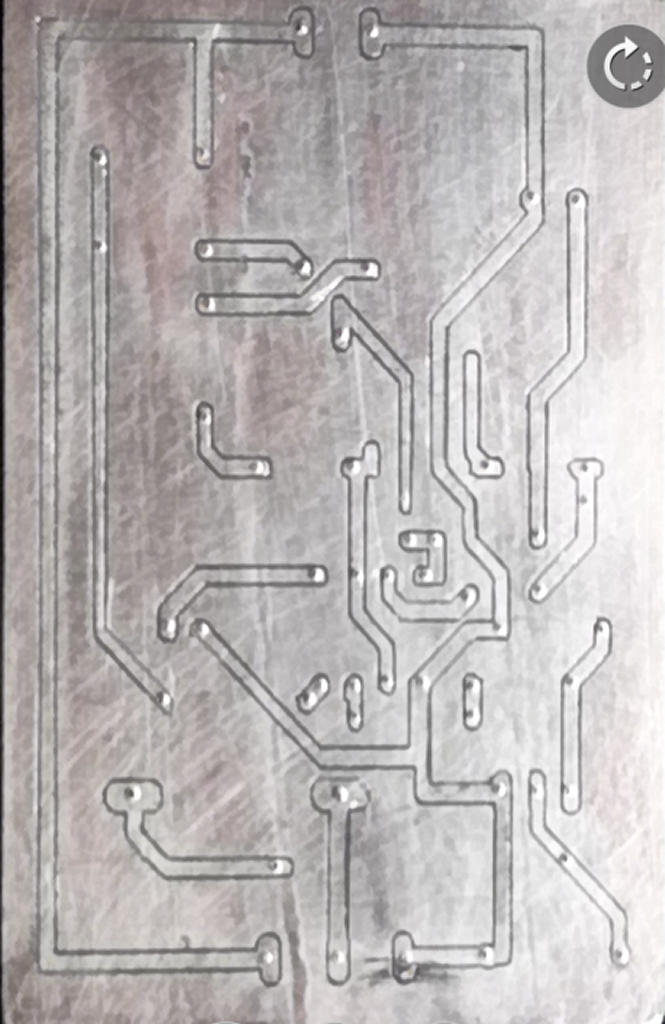

Hey Volhout.
Exactly my setup. I'll put together a vid for you if you would like that. I'll go out and do a board from start to finish and chuck it on youtube if that helps.
The pads do vary as there is evidently some registration error (not returning precisely) -
check out the top two pads in the first pic and I do occasionally get some shorts on my boards - post-production includes me "toning out" the tracks and clearing any shorts with a sharp scriber. The etched lines are very thin but I give new boards an all over coat of liquid flux which means that even with my ham-fisted soldering where I bridge a land to the "flood" it tends to clear nicely when I lift the iron away. That said; I do always check and solder with a tiny bit to avoid it as much as possible.
I think you are right about play in the belts and I have a couple of modifications to my laser to provide better alignment of the belts. It was a cow to get the right trade-off between tightness and reluctance for the carriages to move. Perseverance one night after lots of googling (which turned out not to be related to my problem) and about 2 hours later I had a decent setup.
My Eleksmaker does have the x coordinates reversed for some reason, but as it does the auto-flip of a PCB foil for me, serendipitously, I have little driver to investigate as it would only introduce another step in my process. Have to remember that when i use the laser for other things (which is rare).
Here's some boards and close-ups of boards I made yesterday. Photographing bright shiny copper makes the image look crappy but it is clean and bright in reality
Ready for drilling
straight out of the ferric and paint cleaned
do get some variation in trace width but I can live with it for one-offs
the magnified pix make the etches look jaggy, dunno why - they are much cleaner in real life.
h
Edited 2020-04-03 04:30 by CaptainBoing
