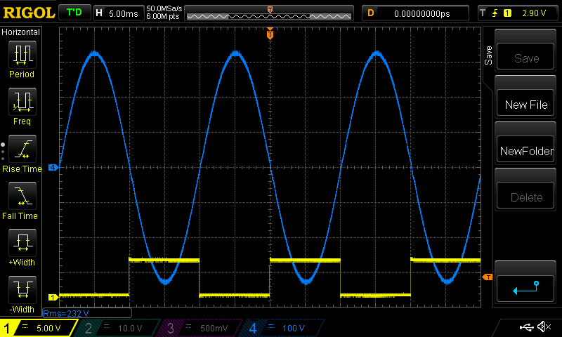

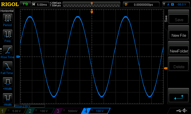

Here is my test inverter, a Mad 6kW totem pole power board with one MOSFET per leg, driven by the nanoverter control board.
Dark Blue is AC voltage
Yellow is the 50 Hz low side drive.
(to get this, go Storage, picture, pic type is PNG, Save, disk D, new file, save..)
Just use a smallish usb thumb drive. Most work fine.
I have been free and easy with buying test gear. I use all the time a high voltage isolated probe. This is used to give me the AC voltage. This way the signal is in no way connected to the AC high voltage output.
The probe is a Pintek DP-25
ebay link here
You can do it too but you need to be really careful and I do not want to have anything to do with probing 240V AC RMS with earthed connections.

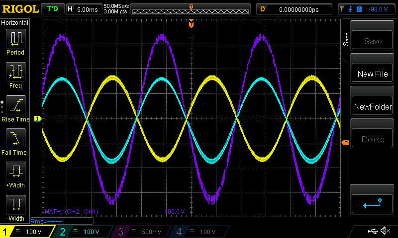

It's not possible to have math function (eg ch1 - ch2) shown without showing
ch1 and ch2. I tried to move one or both channels down or up out of the way
and you loose the math trace.
And, the math function trace looks like crap with heaps of noise.
I had both probes set to 10x, vertical gain is 100V/div
and had both ground clips clipped together but not connected to
anything else.
Yellow is ch1, Light Blue is ch2, Purple is math function (ch2 - ch1)

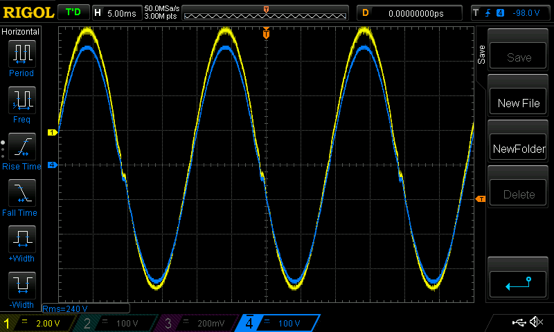

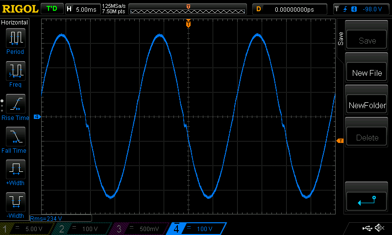

here are the waveforms from first Mad's EG8010 based control board
then the nanoverter.
I did the two tests using the same powerboard, DC supply, toroid etc.
It took about 20 seconds to change over control boards.
EG8010:
the nanoverter:
Idle current was 0.3A at 56V for the nanoverter and
0.34A for the EG8010 which also made some noise in the toroid.

If anyone may be thinking that some isolated high voltage probes
for the oscilloscope might be nice, here is a comparison between the
Pintek DP-25 and the rather old but still good enough Tektronix A6902B Isolator.
Yellow is the Tek A6902B
Dark Blue is the DP-25
It appears the Tek is not so well calibrated.
It is about 30 years old after all.
The 239 V RMS from the Pintek was confirmed with the Fluke 87 DMM to within a volt or so.
One channel only with the DP-25 but the Tek has 2 channels and some very high gain amplification available. Which brings heaps of noise to the output alas.
Both offer a really safe way to see high voltage waveforms.

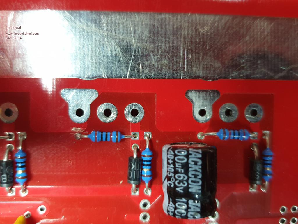

Building up another MAD power board and while checking for any errors I notice that one of the 'H' bridge legs showed a different resistance between the Grid and Source FET legs. 3 of the channels showed 2015 ohms, but the fourth showed 2440 ohms. Turns out there is a fault in the board layout which leaves one of the 20k resistors floating. In the photo I have started scraping off the solder resist to bridge the connection.
Allan
