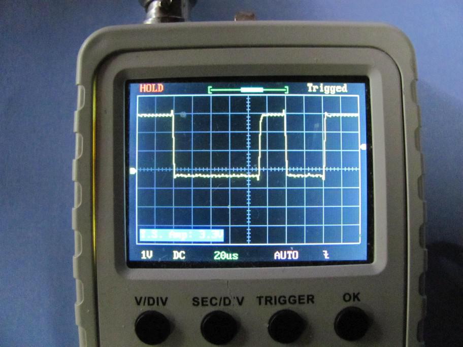

ARMMite F4
Odd behavior of PAUSE for short pauses.
PAUSE 0.049 gives a 40uS pause but PAUSE 0.050 produces 90uS.
If this is expected then perhaps it could be noted in the next manual update.
If not, maybe there is a hiccup in the firmware.
I need 50uS pauses between data pulses, but get 40 or 90. Two shorter pulses together work but one is more elegant.
Test code:
setpin 4,dout :pin(4)=0:do :pulse 4,25 : pause 0.05 :pulse 4,70 : pause 0.049 :loop
This pic shows a short pulse between two long ones with 50 and 49uS pauses.
It's only a toy audio scope but good enough to show the issue.

Are you running the test code in a single line? If so, please try one statement per line and see if you get the same result.

  phil99 said  ARMMite F4
Test code:
Not exactly sure what is happening, but a couple of things that may be impacting this.
PULSE greater than 3ms is run in the background with accuracy of 0.5ms. So you order it and it completes some time later,but it is not blocking so the subsequent PULSE command is issued straight after the PAUSE before the previous completes.The PAUSE is happening before the PULSE is complete as its in the background.
The SYNC command maybe what you need to get these short durations or even the whole thing.
Something like that is my theory.

@Mixtel90
"Are you running the test code in a single line? If so, please try one statement per line and see if you get the same result."
The single line version was only to to get a continuous stream to see on the scope what was happening. The same thing happens in the main program loop, one line at a time.
@disco4now
There are no long pulses. the start pause and pulse are 80uS each, data pulses are 27uS and 70uS for 0 and 1 with 50uS pauses in between. I can get 50 with:-
PAUSE .03 : PAUSE .02
But Pause .05 gives 90
I will try the SYNC command. Thanks for the assistance.

Posted: 12:08pm 06 Aug 2021
MMBasic takes time to process commands. If we say on the ArmmiteF4 that each command has an overhead of say 20uSec then trying to do timings of pauses in the uSec range won't work. Also H/WE interrupts will be happening (e.g.USB) so individual timings may have some variance. Sync may help a bit but you are pushing what the F4 is capable of in Basic. The H7 would do what you want using the bitstream command or on the F4 you could use a CFunction and global disable interrupts at the start and re-enable at the end
Posts: 3411
Posted: 12:35pm 06 Aug 2021
Thanks Peter, yes It is pushing things a bit, It is just seems odd that up to 40uS is ok but 50uS isn't. Anyway a 30 followed by 20 does the job.
A CFunction would certainly be best if I had the ability. One of the many great things about MMbasic is that I can do things that would otherwise be beyond me.
