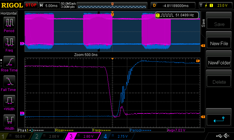

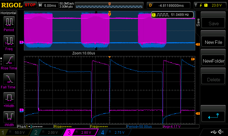

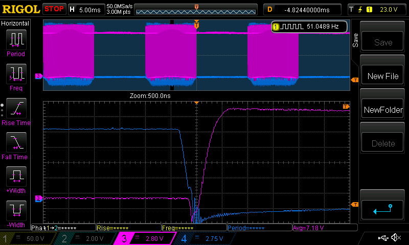

I want to show the Gate voltages for the new board.
I am very happy how they look, and they appear quite similar to
those on the Madness 6kW power board. This no surprise.
Purple is low side Gate drive voltage
Dark Blue is high side Gate voltage
50V input, 200W load
and close-ups of the Off and On switching of the half bridge
Off:
On:
This is perfectly acceptable and no doubt this clean Gate drive
is what permits the power board to survive 11kW with 3 x 4 FETs
The droping voltage over time is present in the Madness power board
as well as mine. I see no problem at all with this. The FETs are fully
switched ON during the period where the voltage drops.
When the HY4008 is fully switched on, the Rds(on) resistance is 2.9 mOhm
The HY4008 specs show Rds(on) resistance is already 3.0 mOhm at 7V
We can see minimum Gate voltages of about 12.3V or a bit more
so there is a large margin of safety here.
Very pleased to see this.

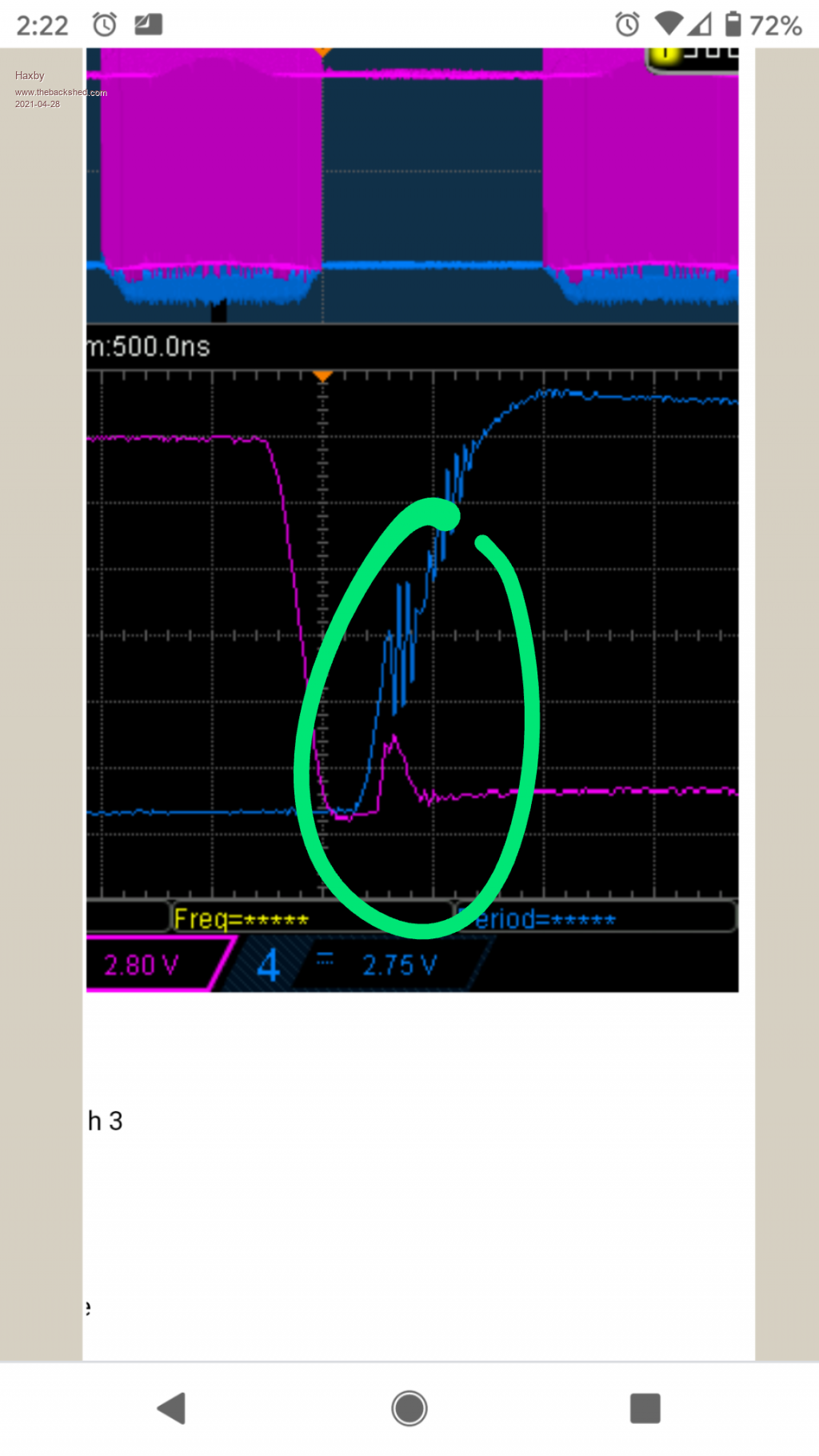

The way I read it, the high side gate is bouncing a few times in the conducting region. Isn't that a bad thing?
poida
Joined: 02/02/2017
Posts: 1515
Posted: 07:55am 28 Apr 2021
Haxby, that part of the switch on means the high side is being pulled up to DC.
This rapid change in the low side Drain pin means the capacative coupling
will cause the Gate to rise, as we can see in the Purple bump.
It's probable that the low side FET is conducting a bit, now and then,
driven towards some natural frequency.
It's normal and expected and it does not lead to destruction
(your mileage may vary, etc.)
I have trialed ferrite beads on a few of the pins but not much is gained
in my experience. It might be good to slow down the natural frequency of
the high side Source/Low side Drain node in some way.

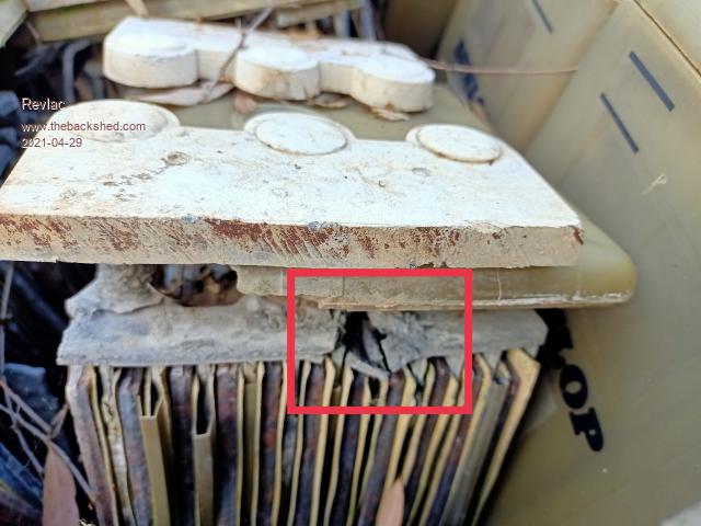

  Warpspeed said
The battery chargers are really crude, and the young minimum wage low IQ fork lift drivers, really give the machinery a hammering too during their shift.
I would think any fork lift battery would be very grateful to retire as a solar battery.
If its big enough the daily depth of discharge should be minimal.
I have looked into the Fork batteries quite a lot and looking at the manufacturers recommendation and warranty terms is interesting.
One thing with fork batteries is they are subject to far higher discharge rates than would be applied in the great majority of the time than their designed use which can pull many Hundreds of amps.  Moving the things up a ramp while loaded and running the pump to raise the mast at the same time pulls many hundreds of amps and that is just not going to happen with near the frequency if at all in a home setup.
The first thing I noticed looking at the manufacturers sites is they are warranted for 5 Years to 80%  DOD.  Many people assume they are 20% or 50% but for fork batteries, that's simply not true.  There are also notes that less DOD will result in longer life which goes with every other general knowledge. People using  Fork Batteries report having them in excess of 10 Years, many claiming 15.
I did notice that they are also rated for one cycle per day.  A cycle is pretty much any discharge and recharge.  They suggested that not recharging  if above 30 % DOD  would be preferable.  The chargers do tend to be Crude, Full amps and the final charge before going into float.  A gentler and more progressive charge rate would no doubt be a lot kinder and aid to the longevity.

Hi Peter, I recognize this as oscillation in the miller plateau. When I tested a lot of MOSFETs and igbt's I had results like this, 1 way to improve this is adding some gate capacitance and fine-tuning the gate resistor.
The results differ from device to device, ixys MOSFETs came out best, the huy4008 was better then most IRF MOSFETs. There was no 1 fits all solution for this.
Don't know how you measured, by know you use probably the best techniques. But I noticed if I measured at the legs of the fet itself, just before they enter the package.(best results) It gave very other results then measuring on the legs more near the PCB. (Worst results) So things could actually be better then how it is presented now.
This was the first explanation I came a cross, it's not long to read, there are better documents describing this fenomenom/solution but I need to look for it. They discribe igbt's but it's true for MOSFETs as well.
miller plateau

Nick is quite right about the tendency towards oscillation.
Its basically ringing due to parasitic inductances and capacitances due to very steep changes in current, and it can be reinforced by any drain gate coupling while passing through the linear region.
No hard and fast rules to fixing it, as its dependent on physical layout as much as anything else.
Loading it with capacitance can introduce phase shifts and move resonances around, and sometimes influence any unfortunate mutual coupling, but the best initial approach to this is usually to try to kill the Q of whatever is resonantly ringing.
Damping resistors of surprisingly low resistance can be effective at lower frequencies, and ferrite beads at higher frequencies. All this is more luck and trial and error than an exact science, but sudden bursts of RF can be a major source of EMI, as well as just looking ugly on an oscilloscope.

I think it would be a good idea to get some sort of warranty for secondhand forklift (or other) batteries, without it they would be happy to sell something for more than scrap price....
Some rough handling and or drop of the battery box, 100mm or so can crack the lead inside and there might not be any visible damage, even the voltage might test ok and light loads might still be fine, until its not, then the cell fails.
I have seen many broken links in batteries, not all from rough handling, lead in not all that robust, it happens.
I have heard of different acid percentage in batteries, at the time it was different for hot or cold climates, might not be much of an issue with new types of FLA batteries.

  poida said
I do not see much value in perfecting the board. I just want it work well enough.
I will have to try this now. 1 to 10nf caps, and now we can start to
assert control with some RC (actually RCL) dampening.
Peter, there is nothing wrong with making the board behave better (apart from time and effort involved) and I am sure it can be achieved. I do see a potential problem with releasing a design to the Forum that may cause issues due to different layouts and components etc. Whilst some of us have equipment & skills to resolve such problems others may struggle. Haxbys concern and highlight of the waveform mirrored my thoughts but I've been to busy for the last 2 days to comment.
As the issue is bordering on shoot through, then the question has to be asked, how close is it to a terminal issue? In my design I chose to use a -5V bias on the lower gates during their "off" time, my reasoning was that should a gate ever be pulled up by a volt or 5 the Gate is still either below or at ground and still well below turn on.  I also use 3R3 on the gates and I would suggest probably no higher than 4R7 to keep the drive impedance low.
I will probe the Gate waveforms of my Inverter soon to get a comparison reference, then I will disable the -5V Bias and look again as I'm not convinced it is necessary and I'll post the waveforms I get, I don't believe I have seen (noticed?) that bump on the lower Mosfet.
Whilst I have seen capacitors added to Gate/Source(Emitter?) on IGBTs to solve similar oscillation issues, I have only ever seen this technique used once with a FET to solve an EMI issue to achieve Ctick compliance. I believe adding external capacitance from Gate to Source to solve this problem is not the right or best approach.  To clarify, negative bias is a technique often used in IGBTs, it is not to stop oscillation only to give better immunity to shoot through.  I used it for added protection against the unknown.
Most comments on the cause & implications of the trouble are correct, it is an oscillation seen on the Drain coupled back via Cgd and appearing on the gate. This is often evident and exacerbated when paralleling multiple Mosfets. I solved an identical looking issue with single Ferrite beads placed on the Drains, if the Drains are not isolated from the heatsink as per some builds this may not work effectively.  Placing a bead on the gate may help in that instance. The trick is to increase the impedance at higher frequencies to lower the Q enough to become stable.
Peter, I applaud the efforts you have made to date and are still making to bring an open sourced solution to the random home builder that decides to take up the challenge, knowing there is a lot of help & support available in their endeavors.
Re the pull down resistor on the buffers input I would repurpose the 5K resistor that is currently on the buffer output.  The separate 20K gate pulldowns for each FET are effectively all in parallel so for 4 FETs it would have ~5K to ground anyway.
Cheers Mike

I saw the gate capacitor trick on a bldc controller with 3 paralleled 15810 MOSFETs (18 MOSFET total), used in a golden motor controller. With Rgate 100R and C 10nF. Reading a few topics on endless sphere it's quite common in "Chinese" motor (3 phase bldc)controllers. Switching losses will be higher but the controller should be more robust.
What I also read was negative bias and gate drive supply above 12V is not necessary wanted because of the higher energy needed for making the transitions. It's low impedance you want, but only with good PCB layout, I think the 20-25khz is still quite forgiving. What you probably want in a new design is dedicated Roff and Ron resistors, MOSFETs have different toff and ton timings so why not using them, to get the same timing. Also ssing the parallel diode approach could possibly stress the driver.
I think the problem with the motor controllers are low inductance loads that could cause very fast di/dt and do possible MOSFET failures. But since transformers have more like a high inductance (du/dt is?), a fast gate drive is probably not a big problem. Don't know what my point was, I think it was that we could discuss this for 1000 pages since every design and used components are different ...
